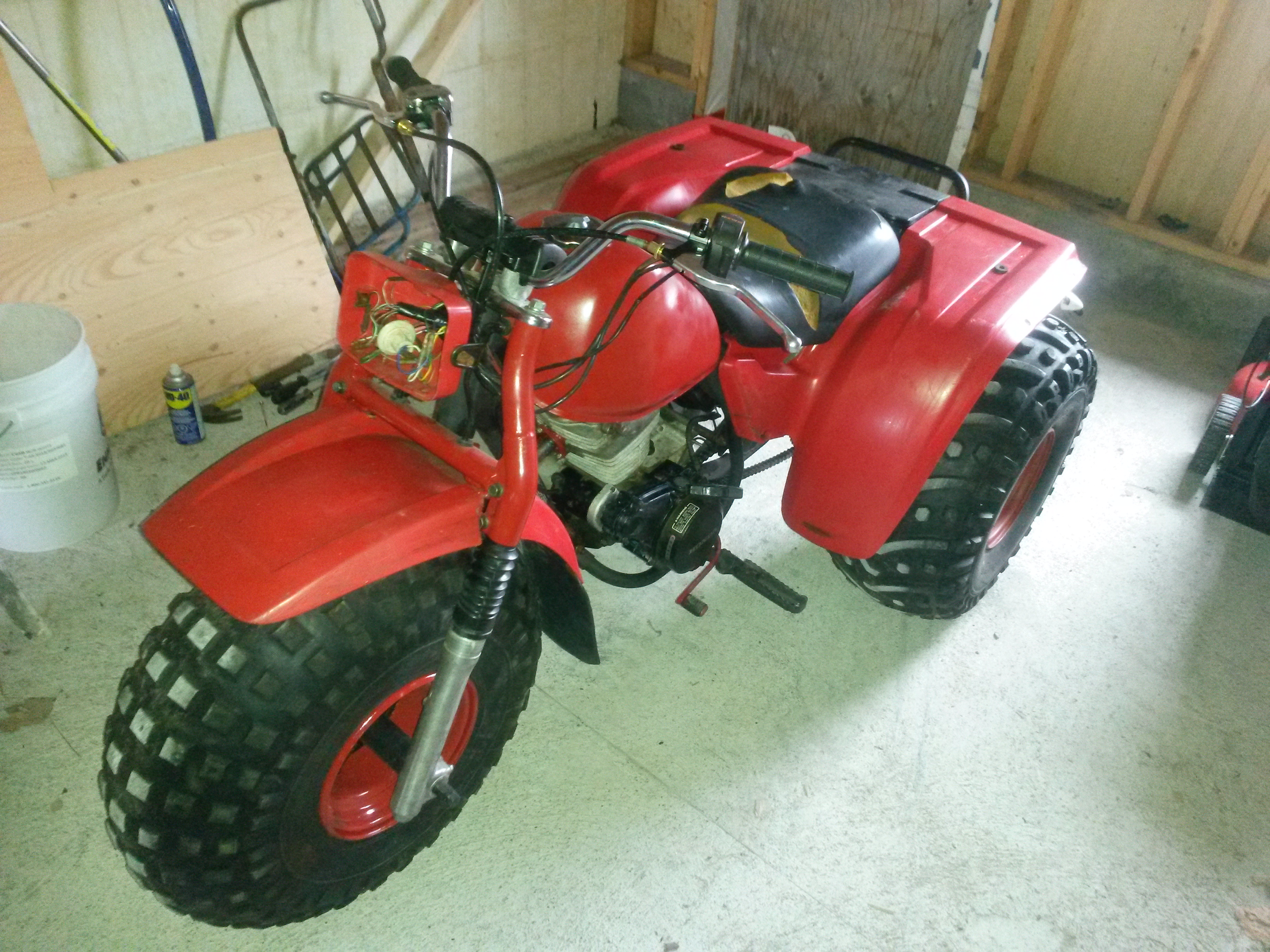

    hello i will know what complet exhaust i can use for my 84 honda atc 200 M please ?? i can't find it on the net !
    tanks to help me ...!

    You could go with DG or cobra or get an Old School Supertramp or or kerker all exhaust for the 200 series are interchangeable here's a link to a DG. http://m.ebay.com/itm/DG-RCM-Exhaust...415?nav=SEARCH

    I forgot to mention they're all interchangeable except for a 200 e header is a little different

    Sorry russman but that is incorrect the exhaust off of all the 200 are not interchangeable. The only exhausts that will fit a 200m are ones for the 200es 200e and 200m.

    Too bad you arent in the states, I have a complete M exhaust I could probably sell.

    ok no problem DOHCBIKES many tanks !! ......and thank you all for your answers.! So I have to order for a honda atc 200 or e es for my 200M then.!

    You could also try Musket Mufflers, That's what I used on my 250SX, looks like factory OEM, fit direct to factory header pipe.

    hello i received my exhaust and his is very perfect for my 84 Honda atc 200 M
    and the sound is very very cool ...!
