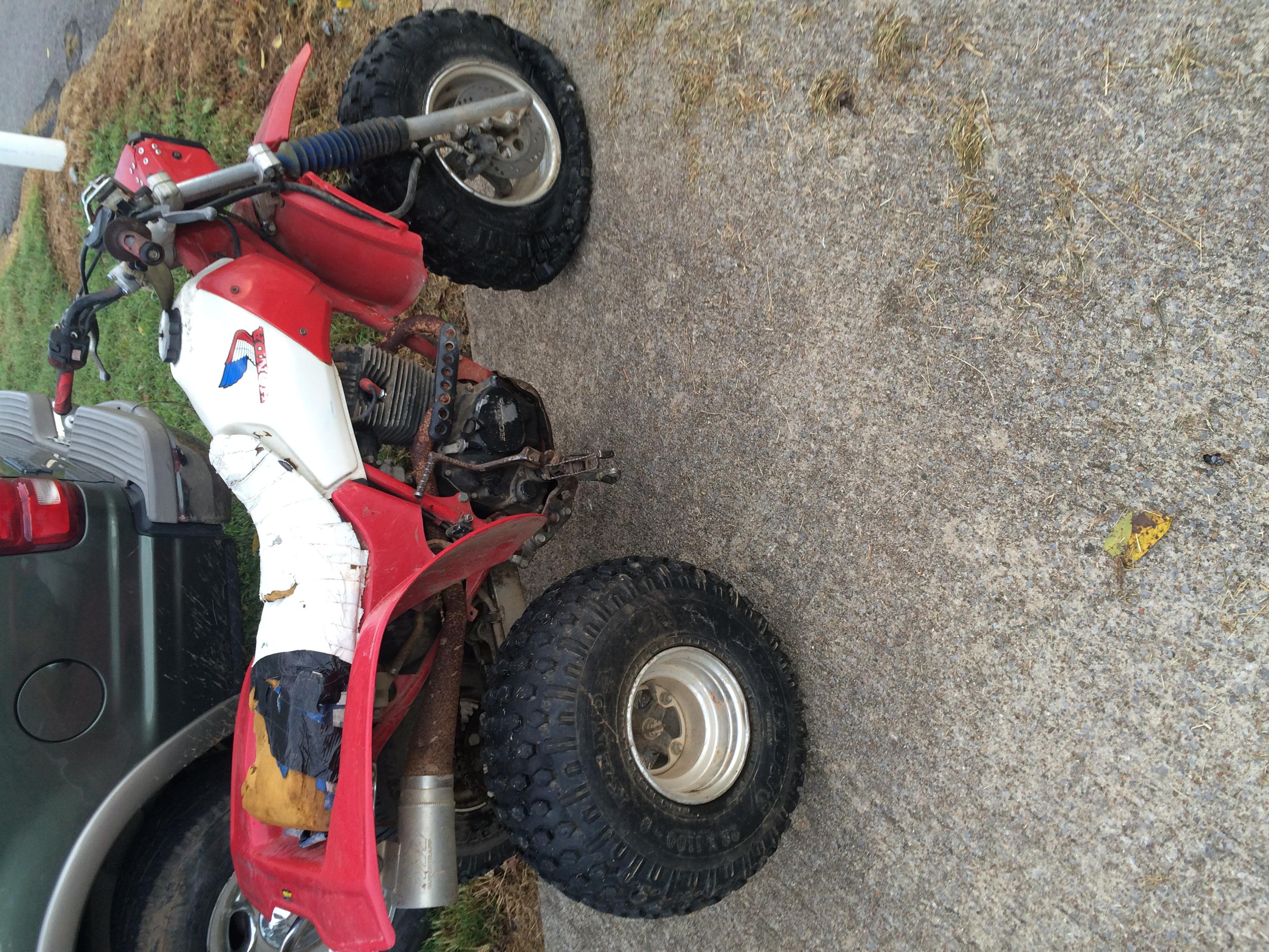

    After being out of the 3 wheeling world for about 5 years I finally got another. An 85 200x. Picked it up cheap, although it needs a good bit of work. Excited to get started on it, more excited to be riding one again. It will be my first x, so I'm sure I'll have questions, but I know the search function is my friend. First order of business will be replacing the (already damaged) swinger bolt and needle bearings. Fun times. Good thing is I've already moved the bolt, by accident so it should come out easy! Anybody know where to buy another? (Can't view classifieds here yet). Anywho, just wanted to say "hey" to the rest of you fellow crazy trikers.
    She's ugly, but it's a start. Came with a few goodies on it as well, supertrapp silencer, uni filter, and the motor had been bored and carb rejetted. It was done right at one point.

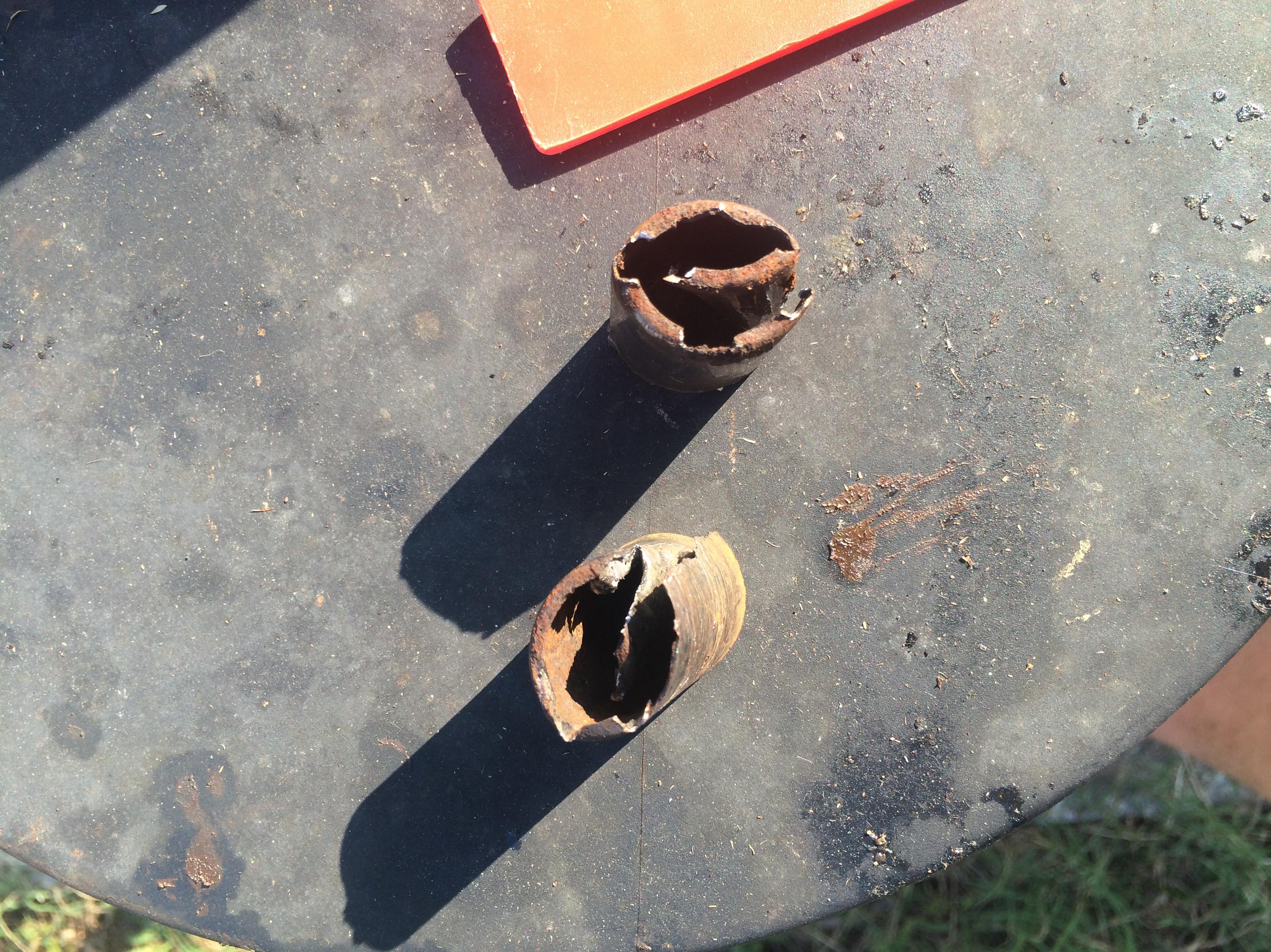

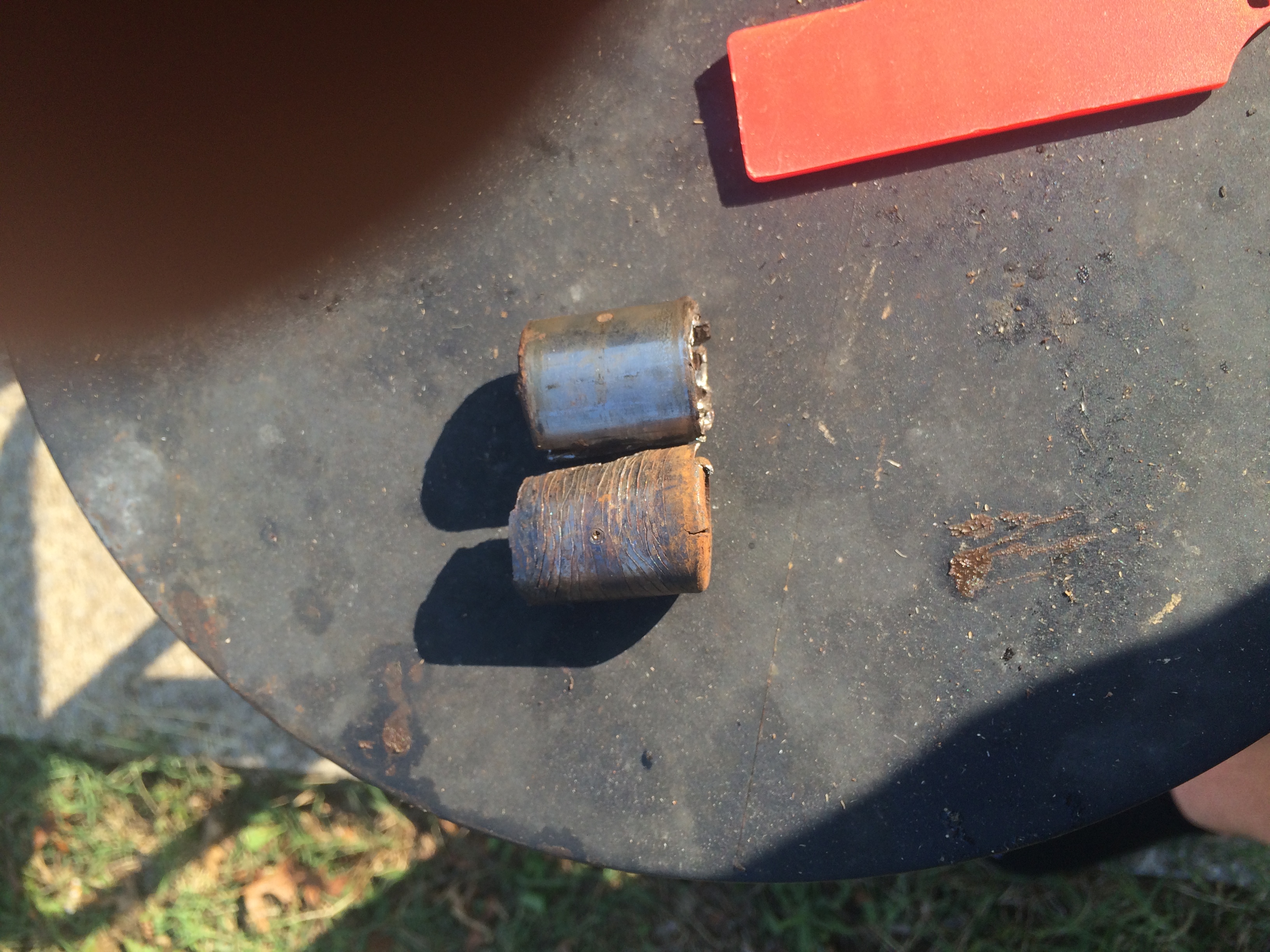

    Got the pivot bearing races out today. After reading a lot of posts I figured this was going to be my biggest challenge, but they came out rather easily. Took about 30 minutes a piece. Since the needle bearings were dust/rust I figured they had been in there for a while and weren't going to come out without a fight. But I got extremely lucky. Now to tackle the rear axle bearings, and put everything back together.
    Here's what they looked like after taking them out.
