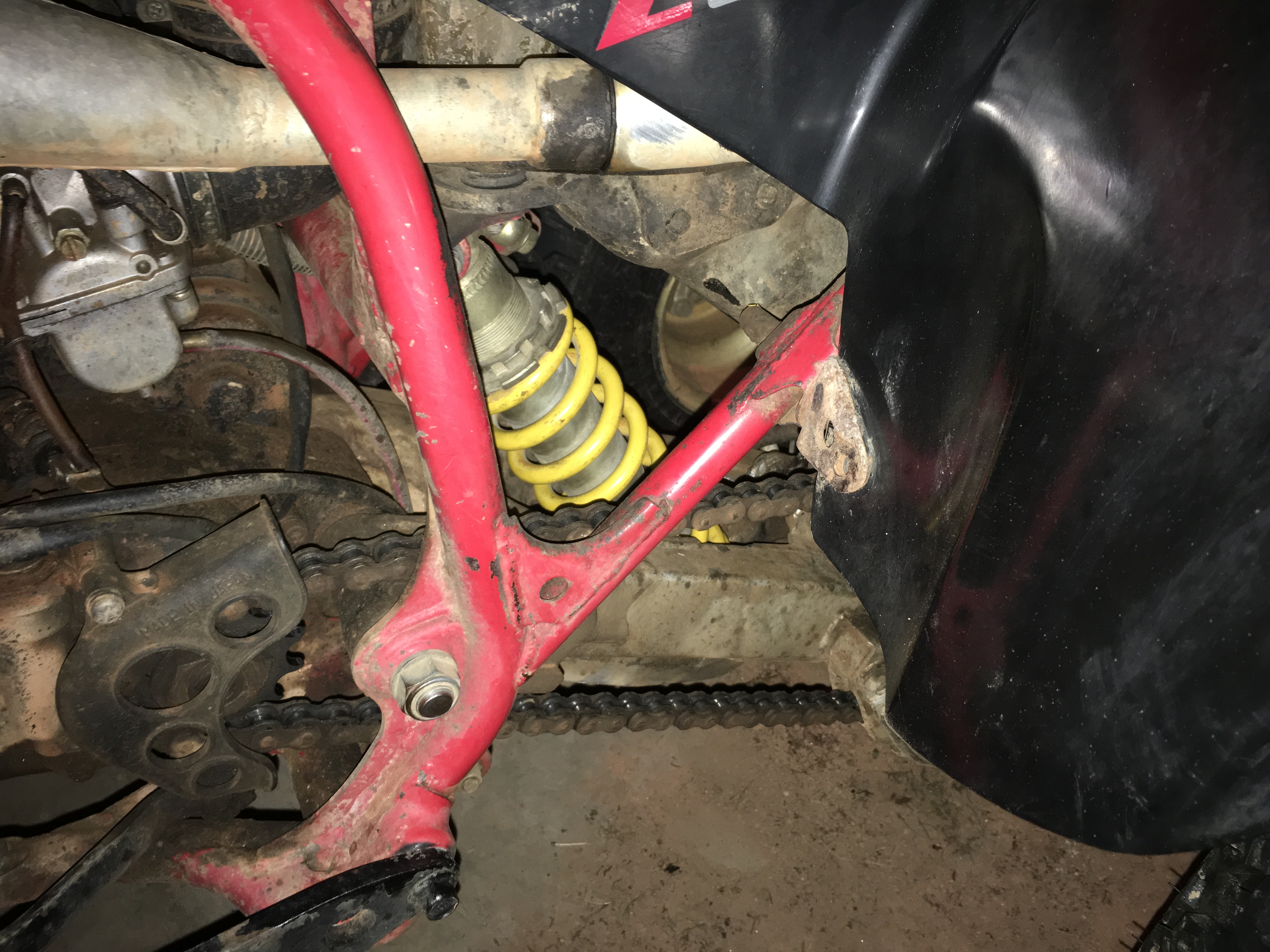

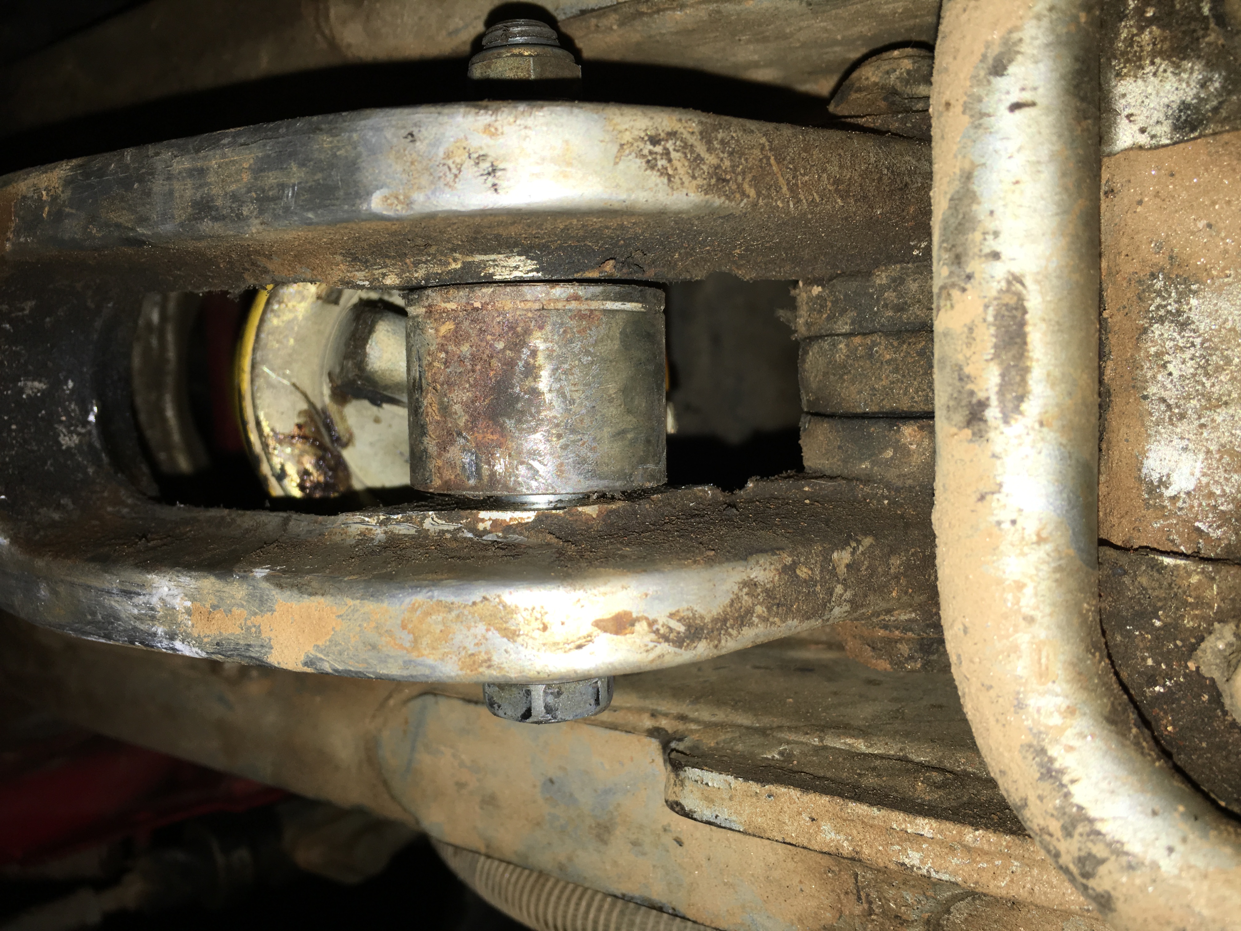

    Well, the shock from a 2004 warrior arrived yesterday and I got it put on last night. The shock fits perfect, however I think I am going to have to zip-tie the hydraulic tank because it does not line up the same way. However, the shock I took off was completely dead.... no hydraulic what-so-ever.
    The only problem is I think I forgot to put the spacers in on the lower part of the shock (see the picture) so there is a gap on both sides.... I assume this really matters and I should take it back off and put those in before riding it hard?

    The trike sits up much higher now.... I love how it looks now!

    Looking good buddy! :Beer
    Yes, you should put the spacers in
