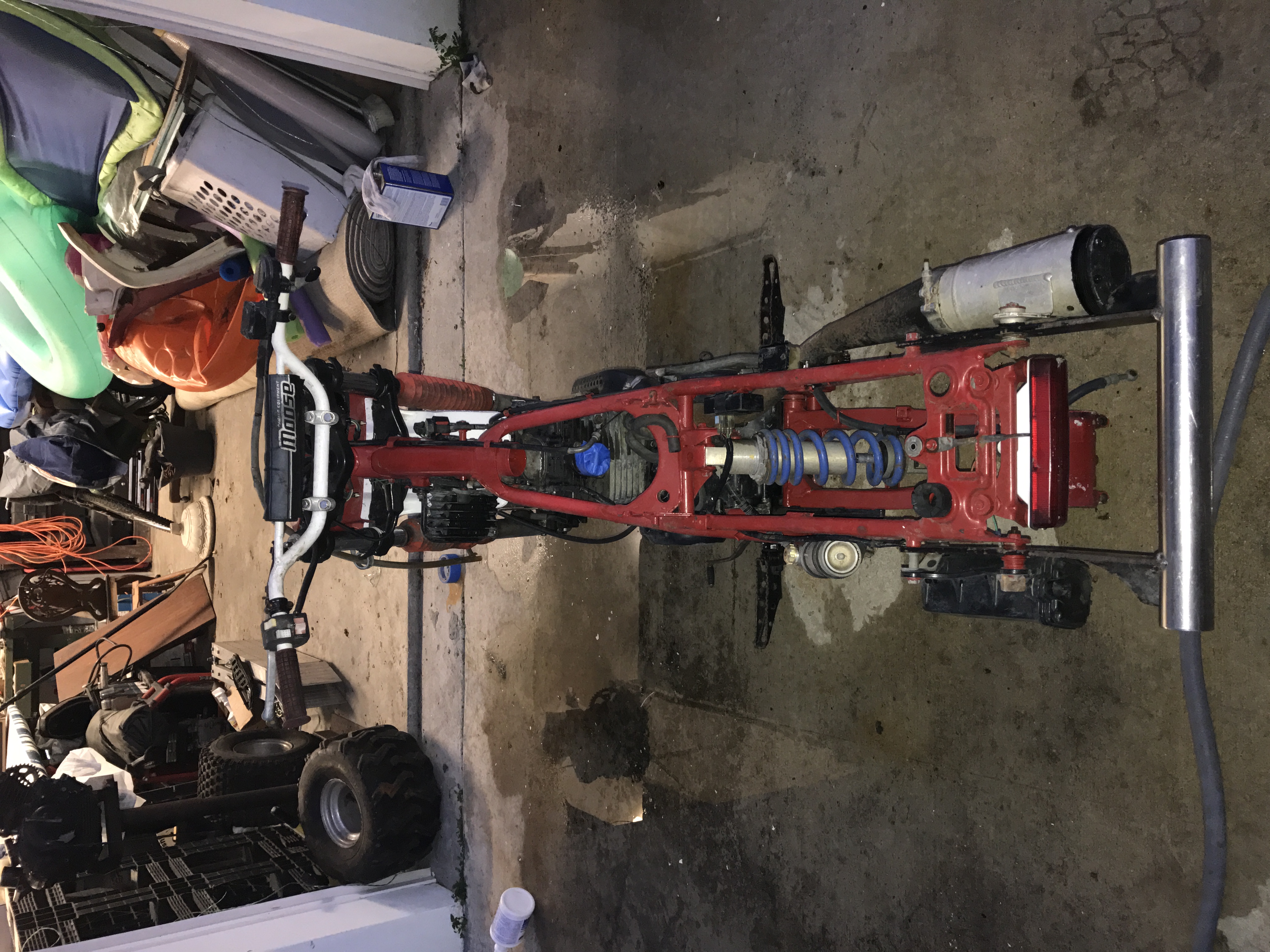

    trying to post pics, not sure if I'm doing it right

    I'm going to ride it for a while, then maybe tear it all down and do a full restoration, its mostly mud down here so thats why its not show pretty if your wondering
