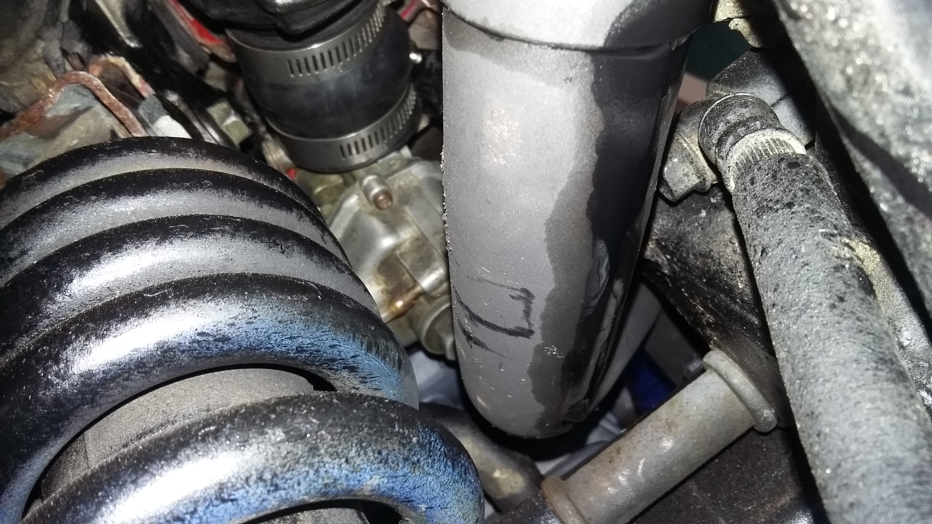

ID:	235783 I'm comfortable riding it... Here's what I got after a half hour of riding in the pic above.. What damage will it do if I ride like this?

    My 200s i ran for 2 years smokin like cheech n chong...i carried xtra spark plugs with me like it was a 2 smoker....not sayin thats what ya should do,but i would address it sooner than later

    Your crank breather hose on right?

    Quote Originally Posted by AK47KID View Post
    Sent from my SM-G935V using Tapatalk
    ^^what he said....good call AK

    Is it a 200x frame with a 200s engine?

    Newrider is offline At The Back Of The Pack Arm chair racerFirst time rider
    Jun 2016
    New Jersey
    182
    Yes it's an autox.... I gave this thing at least 50 hours trying to get it perfect and this is like a real road block for me I've never torn into an engine before, but I guess there's a first time for everything.. I'm just real skeptical and nervous.. The most I was in the engine was the timing
    Jun 2016
    New Jersey
    182
    I don't know.. I thought so.. But the hose coming off my engine, I noticed there was exhaust coming from it so I wouldn't doubt if something was on wrong.. Sorry for my lack of knowledge on this.. I can check ND take pics when I get home today
