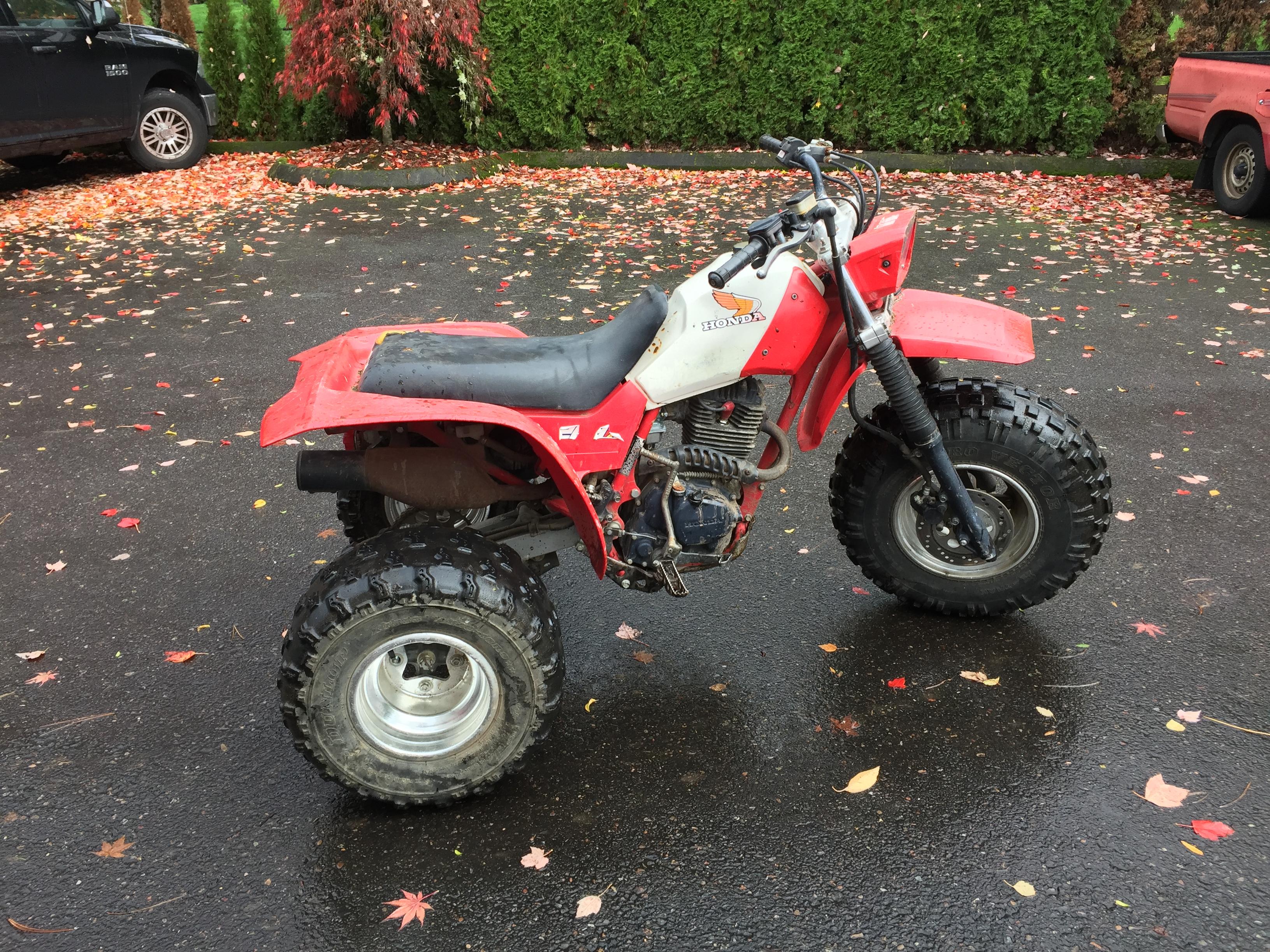

    I haven't had a chance to tear into anything else yet so I will be assessing things as I go. So far, in addition to the tank, the front brake was completely out of fluid, rear tires are garbage, seat cover is dried out, brittle and cracked and there is a sizeable crack in the plastic. She looks pretty good in the picture but she does need some work. It will be a fun project.

    I gotta say I am feeling pretty jazzed about this trike. I had never ridden a 200X before today. I was very thrilled when it kicked over. Then I got it going, got her warmed up, adjusted the idle and then took her for a spin. What a fun little machine! She still needs a few things but so far she is working out as good as I could have hoped for considerIng she was not running when I bought her. I need to do some tinkering as she doesn't fire right up. Gotta do quite a bit of kicking before I get her going. Needs the brakes worked on and gotta recover the seat. I'm going to build a custom grab bar too. The oem grab bar was broken and just barely hanging there. Needs tires. Front tire is good but rear tires are bad. Other than that, I think the only things left are just little cosmetic stuff to make her look better. Bearings seem good. Maybe rebuild the suspension.
