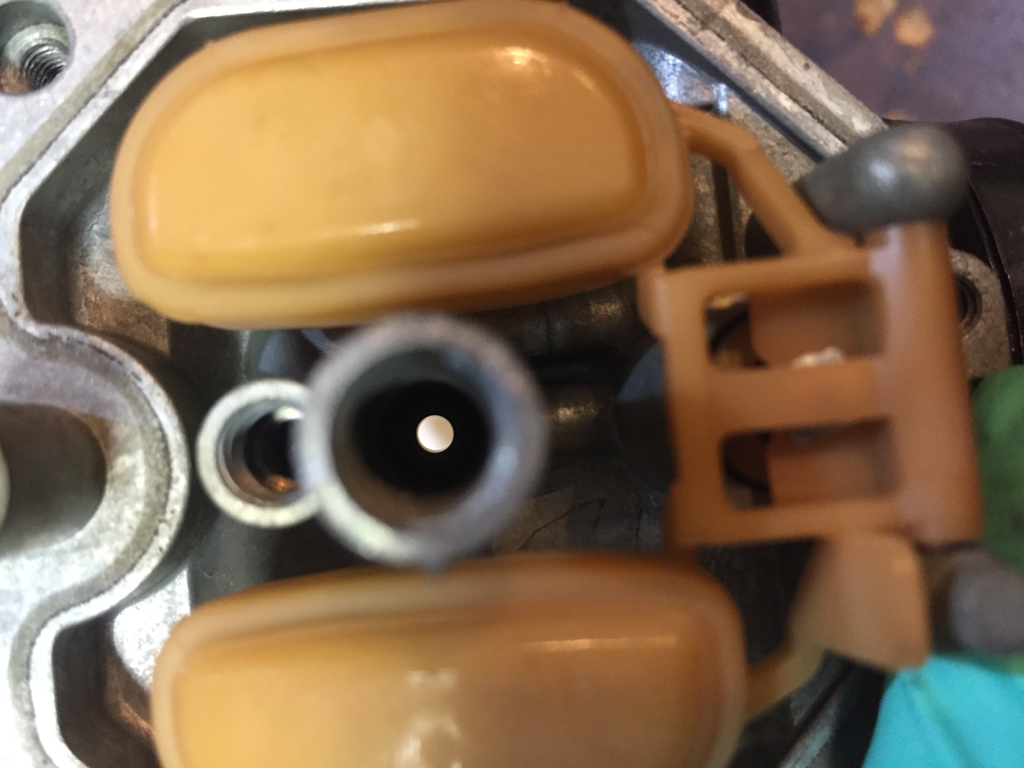

    I pulled the carb and cleaned the jets tonight. Also adjusted the needle. The clip was one notch up from middle so I put it back to middle notch. Put everything back together. Idles great. I live In town so I couldnt take it out for a rip. I will on Saturday.
    I also noticed I had a slight kink in fuel line. I am doubtful this had any affect but of course I fixed it as well.

    when you go and put in the new main jet, also make sure your air filter is oiled a dry air filter can also help cause a lean condition, not that bad that is definitely jetting, but even so stock jetting is with a wet air filter.
