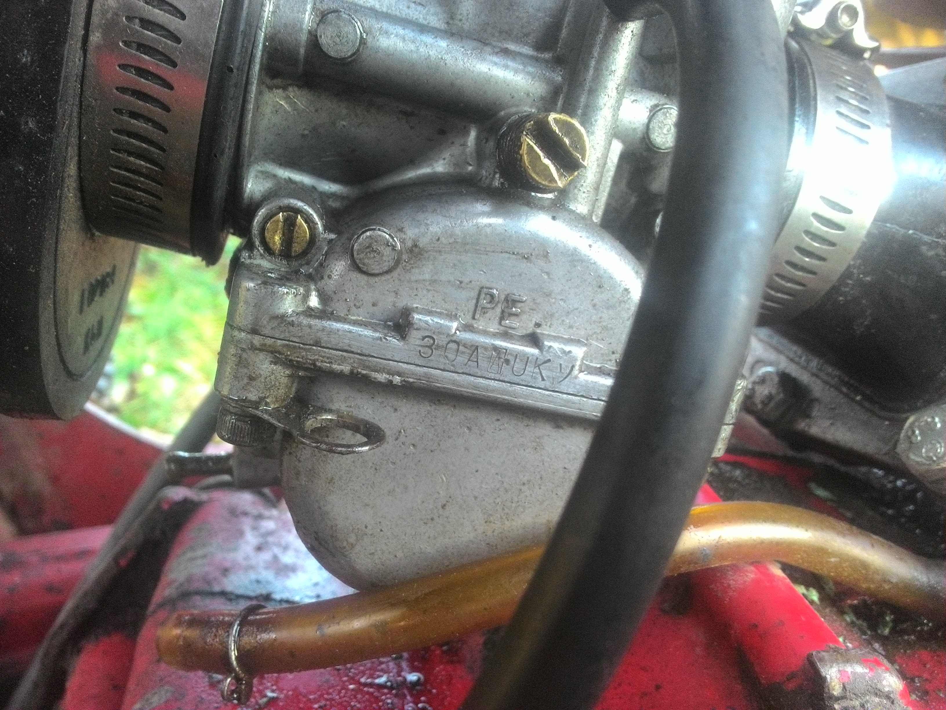

ID:	236802I got my cylinder bored 40 over,did the first heat cycle. I'm just wondering if this is the stock carb.if so what should the needle be set clip 3rd down from top

    I got her running today, I had a 60 jet in carb from previous owner.so I put a 50 in and she will wheelie in every gear now. So now it's time to put on the new plastics I have and look in to a new head pipe
