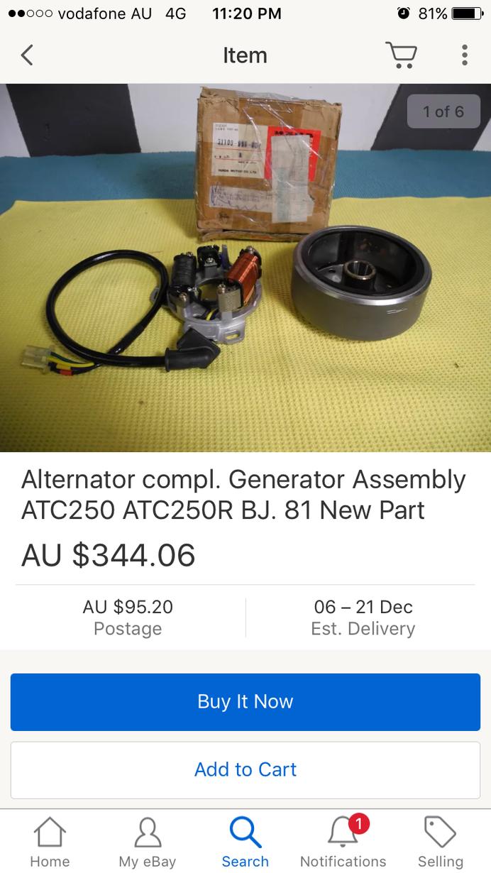

    Atc300r, are you definitely sure about this? They do look the same though. Iam in Australia and want to make sure before I purchase one from the us. The 81 has a different part number but still will fit? The pic below is a brand new one from Germany, don't want to buy and it can't fit. Thanks

    100% . I have 81-84 motors and they are all the same with the exception of the shift shaft.

    Excellent, do you know where I could get a new one in the us? The one in Germany is pretty expensive or is that a reasonable price?
    Carthage NY 250r rules
    2,355
    Im not sure what the cost is to you but that being new Id get it . They are hard to find new here in the US. Does it come with the flywheel.

    Yes it comes with the flywheel and new, Iam hoping it fits on the 84!

    81-84 stators are the same atc300r is right it will fit.
