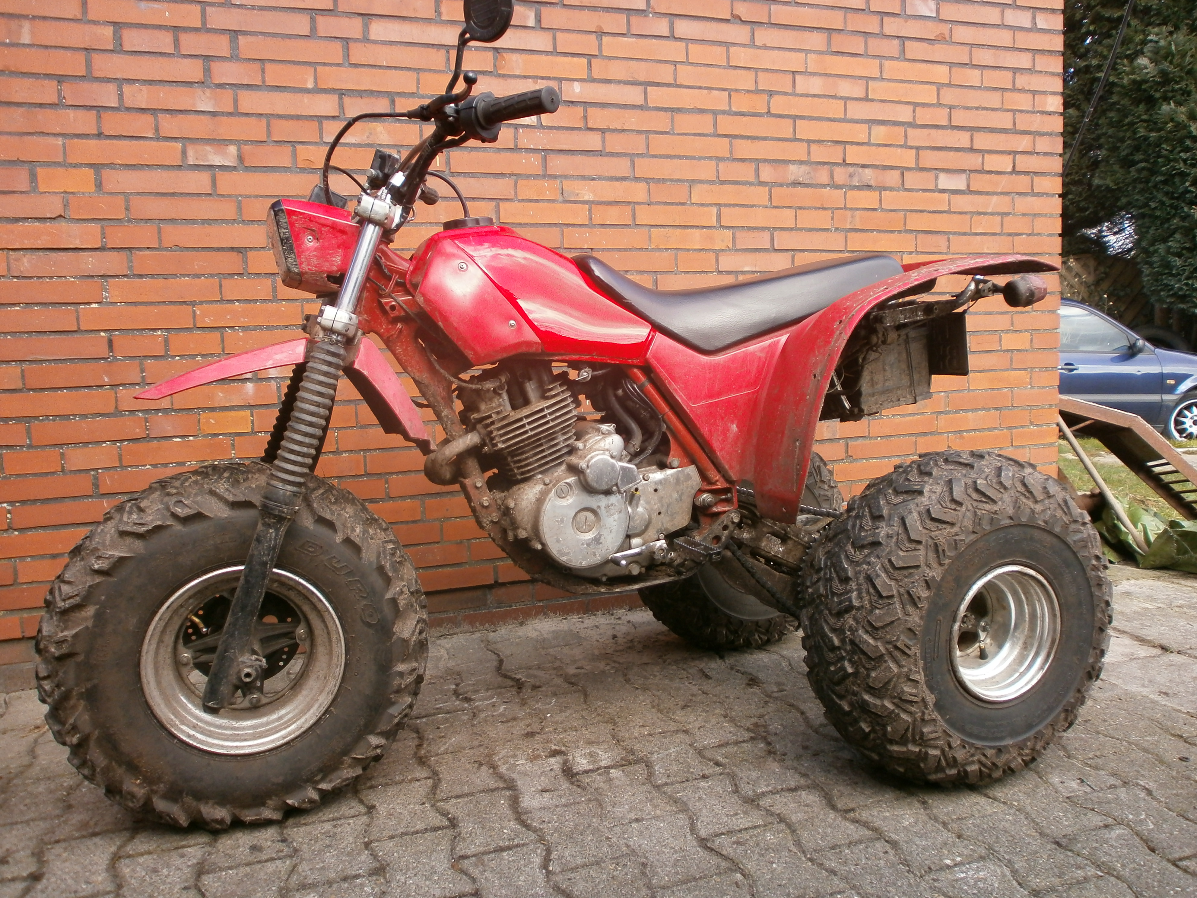

    Just in case you wondered,it fits!
    I put the hubs (or "stars" as we sa in europe) from my Tecate parts vehicle and use them together with the fine 10" alu rims now on my modded 200x.
    Great upgrade i must say.Use innova 20x11-10 now.Great tires on the cheap and the come really wide on these rims,which made an improvement in the mud here..Before and after pics attached.
    Olli
    PS:The 200x pics are a bit old,+4inches on the forks now..

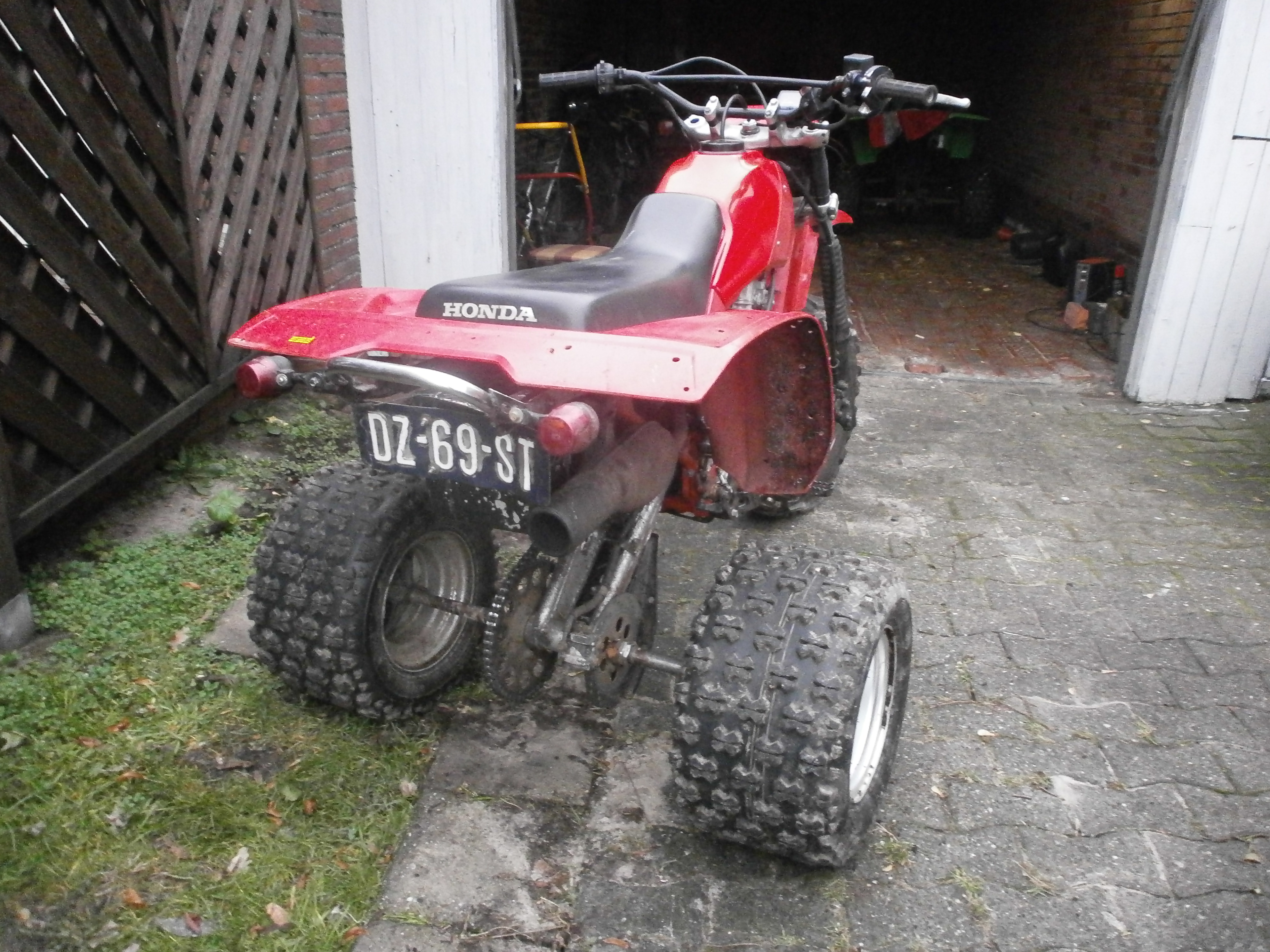

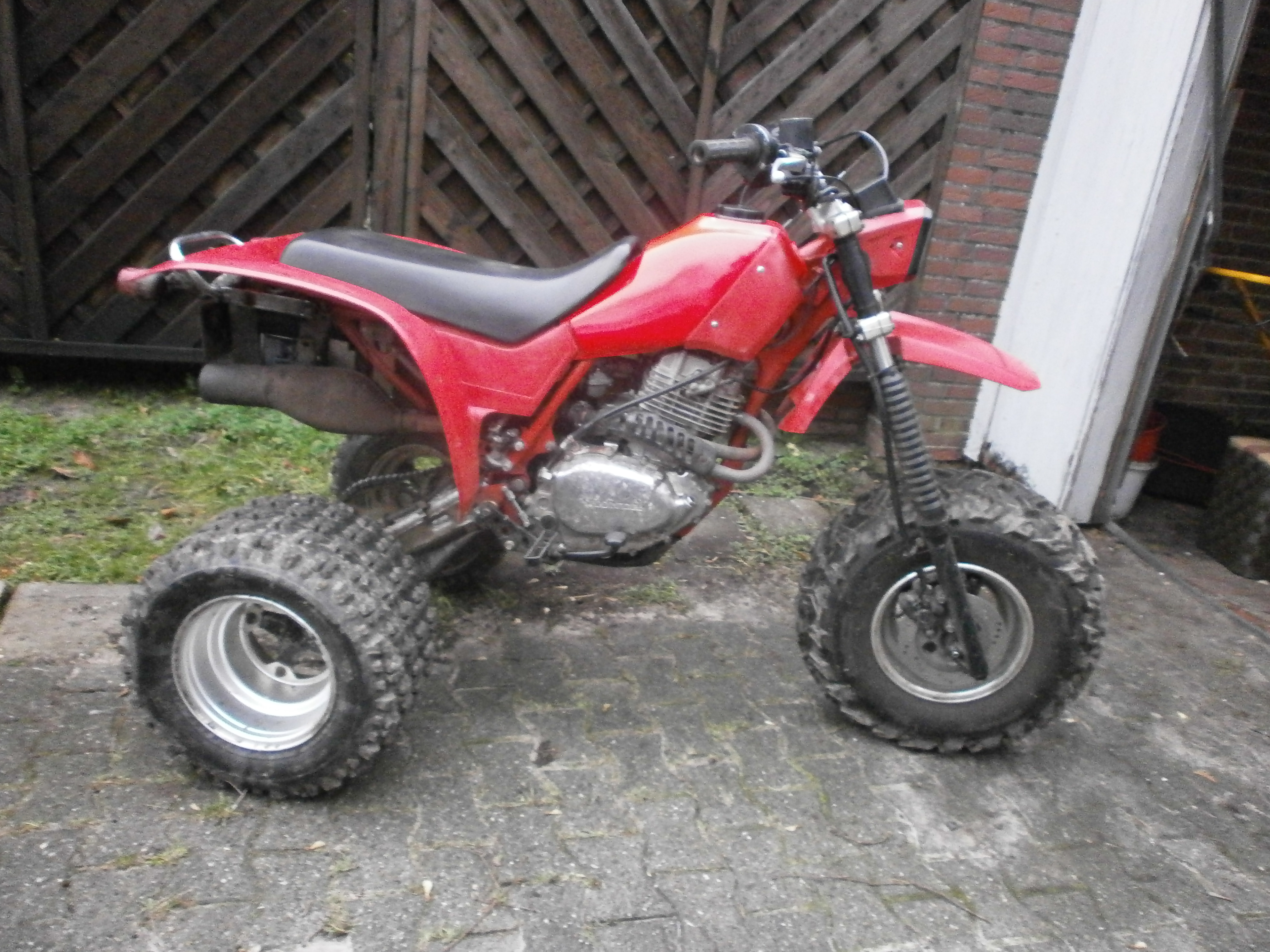

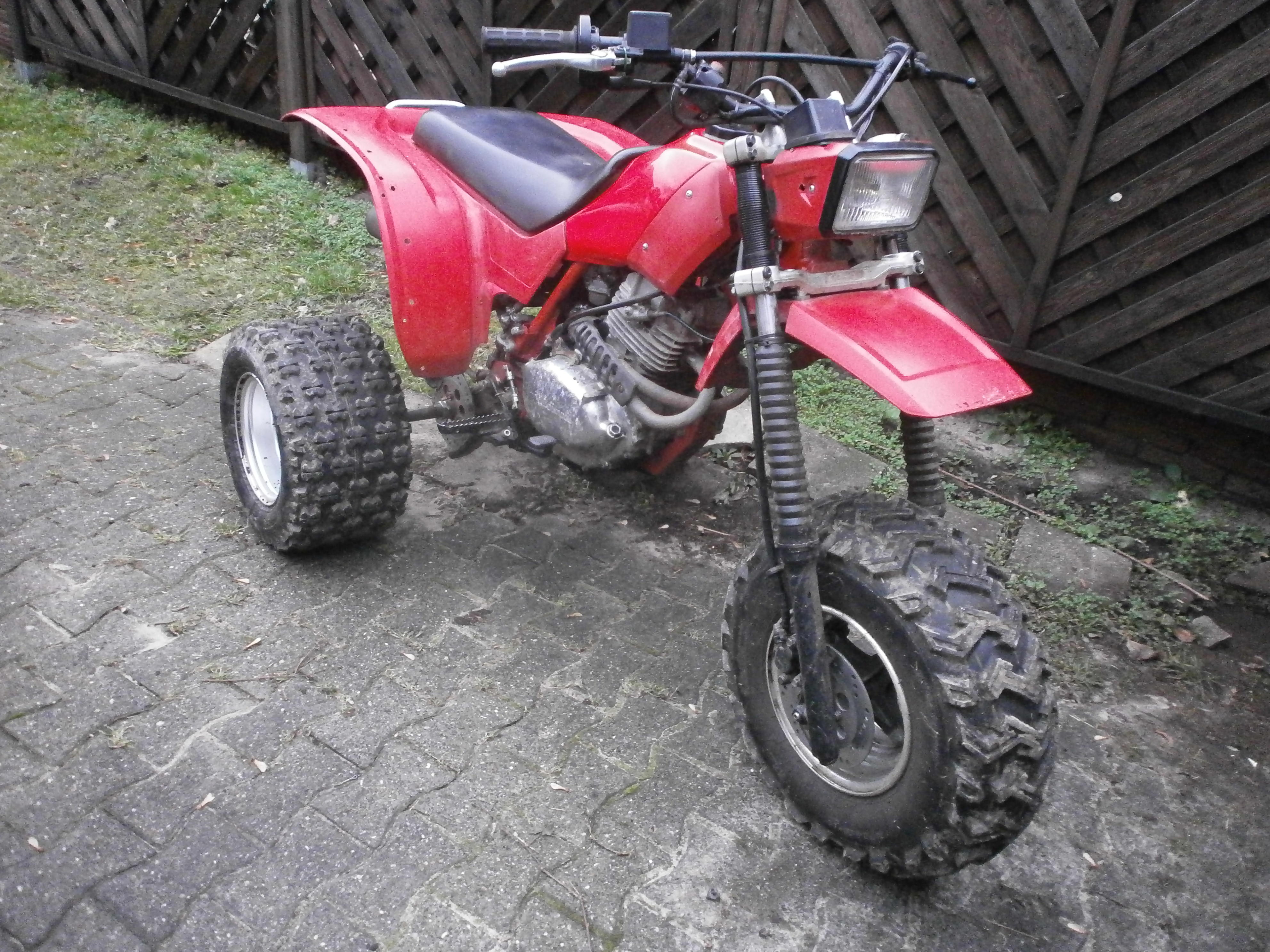

    picture made today
    Went out and made 3 new pictures for you :-)
    Sorry,i no nothing about shooting video and uploading it..
    Olli
