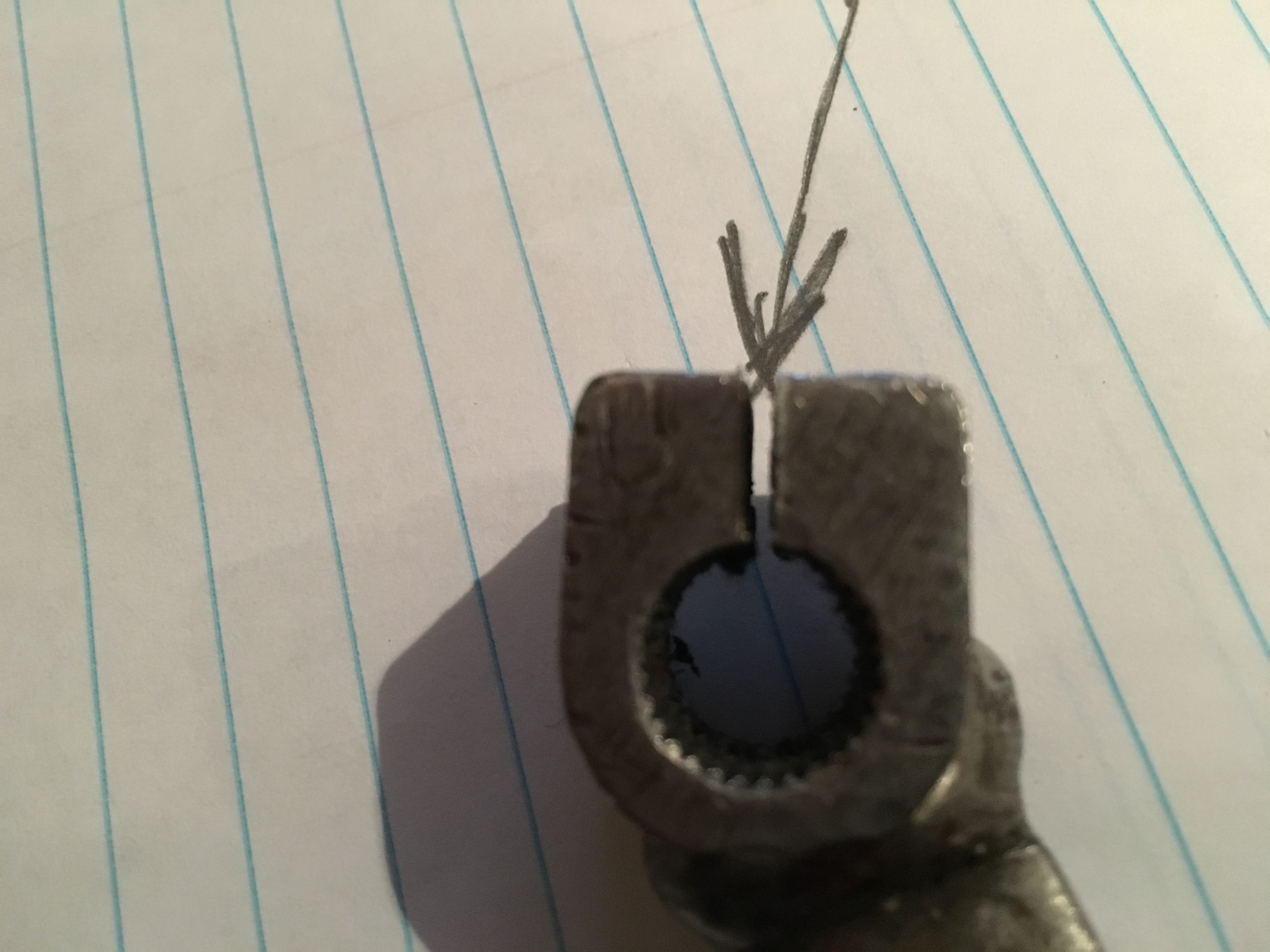

    you say the bolt is tight on the shifter? Is the clamp area metal to metal too or
    Do you still have space for it to clamp tight? If ends are touching you can file or
    Hack saw to open it up a little, take the shifter off first. (Hope that makes sense.)
    Hack saw to open it up a little, take the shifter off first. (Hope that makes sence).
    X2. And whatever you do, get it tightened up before you strip the splines off the shaft.
