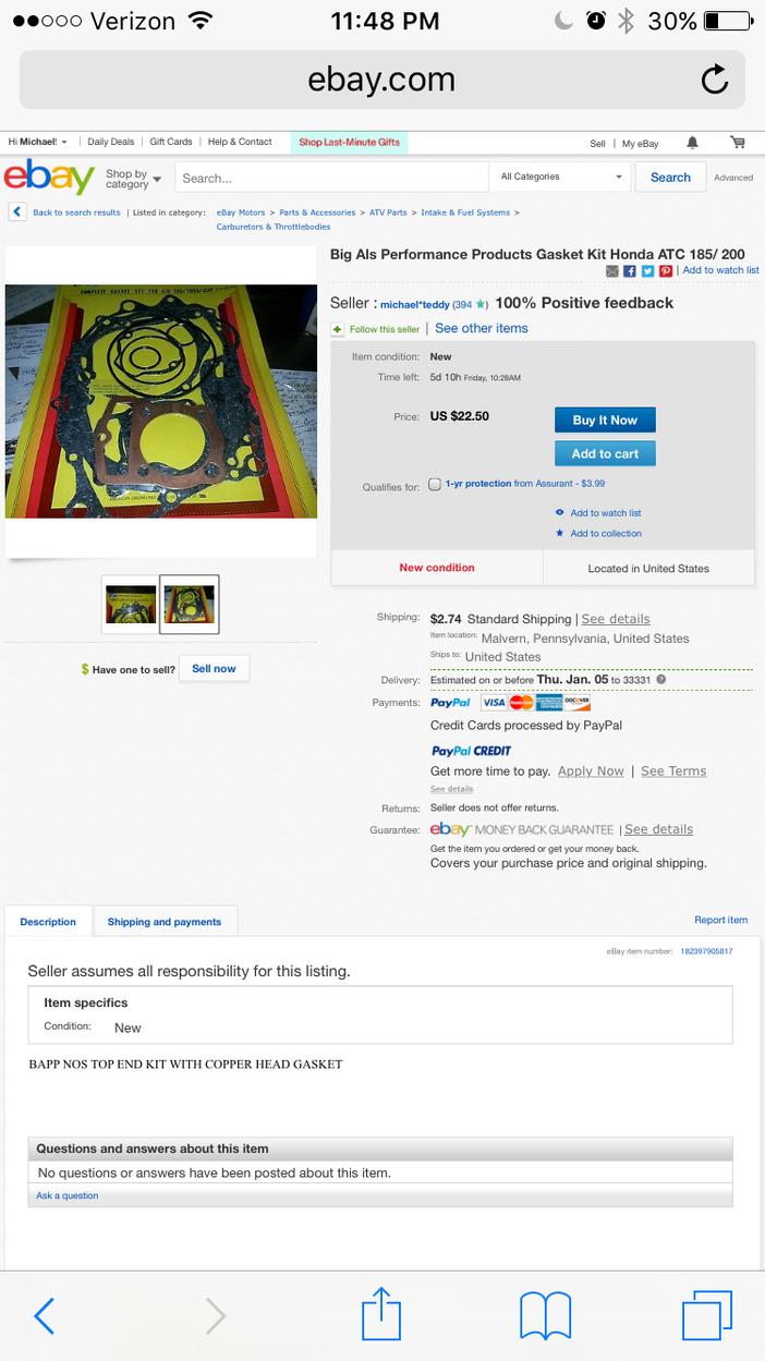

    An old school thick copper head gasket and 3-4 base gaskets should get you up to were you need to be .
    Btw that's a great price on this gasket kit . You will know when your about right when your compression is about 200-220 .

    Alright, I went ahead and nabbed that gasket set.
