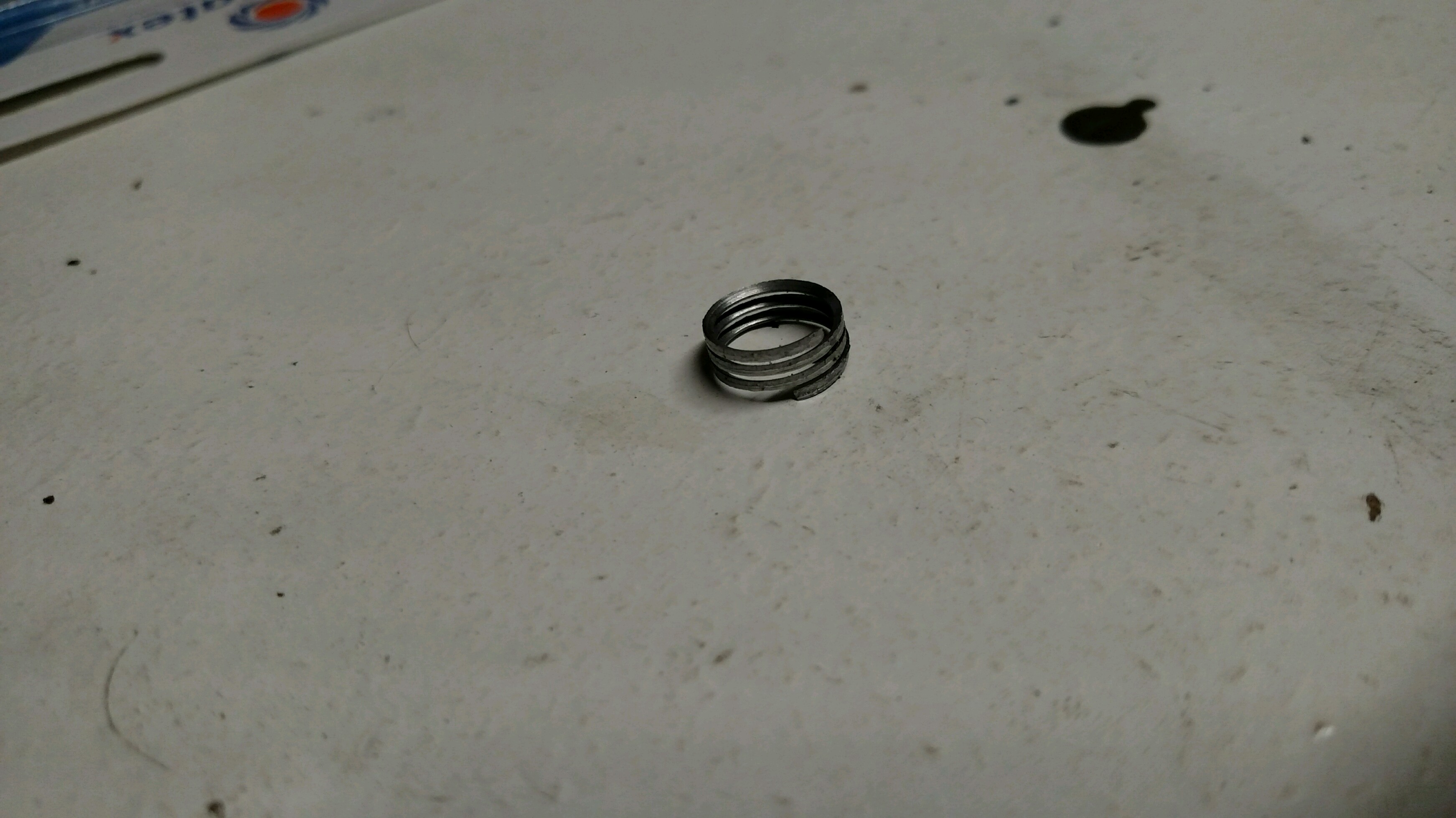

    Not a helicoil

    Sure looks like it could be one in the photo . So you tested it and it is aluminum?

    Yup. Magnet would not pick it up. Unless helicoil comes in aluminum?
    That's why I'm apprehensive to re-tap.
    If it had a helicoil installed at some point I don't want to keep cutting the sump bigger
    Thoughts?
