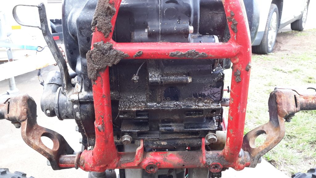

    The engine underneath was quite dirty and gunked up with old oil and dirt mixed after I removed the skid plate.
    Since I know the tappet o-rings are leaky (especially the front).........the next step is simple. Thoroughly clean and degrease the entire engine and after I install the new o-rings run the engine for a couple of heat cycles to see if I have any other areas of concern.

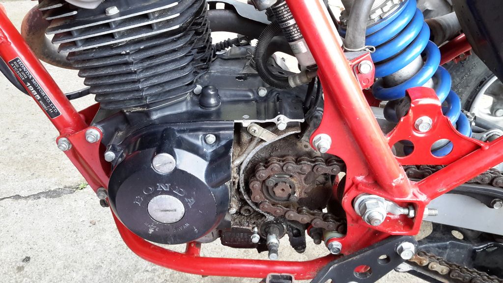

    Might think about replacing the chain and sprockets too. That front sprocket looks like it has some pretty good wear on it.

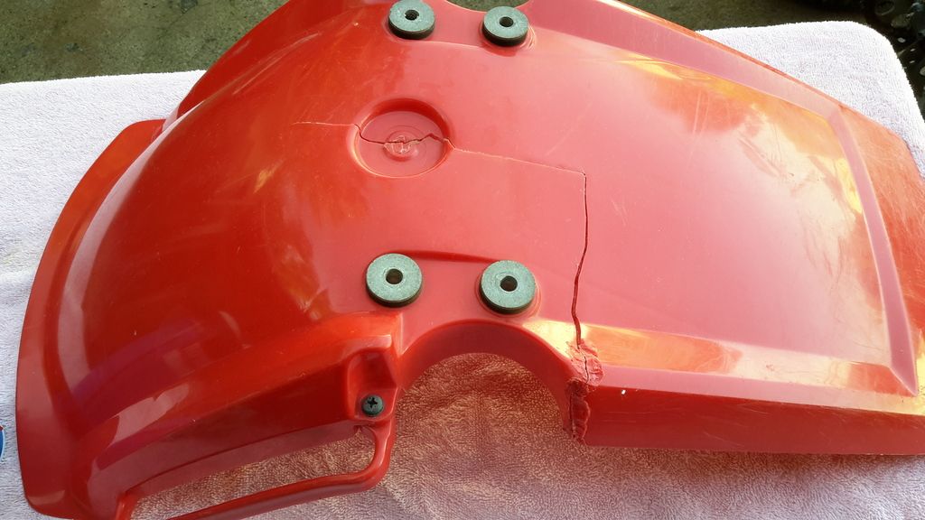

    A nice crack on the front fender. I haven't welded plastic in years. Looks like a repair was attempted at one point. Good eye on the sprockets 350

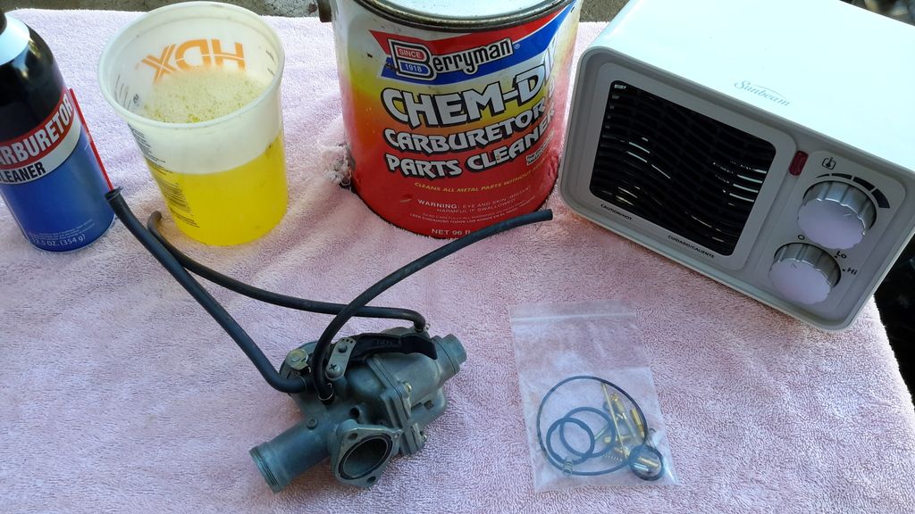

    My way of cleaning a carb. I like the dip to get warm so I use the space heater to heat it up. I also have a tumbler set up for a 30/70 acid bath but this won't need that. What this pic doesn't show is one of the most important parts...high pressure air. Also I have an old burner that I use to heat up the rinse water......not to boiling but pretty darn warm. It's a great method for a solid rinse of either the dip or phosphoric acid.

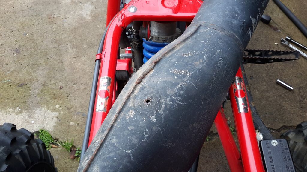

    Has a small hole in the exhaust. In fact this entire exhaust feels "loosey goosey". Still like to get that Kerker but how are those DG exhausts on ebay? There's a used bassani on there but that looks like work.

    Are you looking for performance or quietness? Unfortunately your options are limited aside from custom building an exhaust. I personally think the DG's are loud, but not anything that would prevent me from buying them. You can still buy a brand new supertrapp slip on silencer and run the desired amount of discs and maybe that'll quiet it down some. Or you can buy any old silencer and do some bending and make it fit.
    But again, what are you trying to gain from this? Personally I wouldn't be worried about no pin hole in my silencer. Unless your looking for performance.

    I had a Bassani on my 350X and I liked the performance and the sound. The stock system on my 86 200X sounded like a sewing maching but was well tuned from Honda. This one is loose and kinked and it would be nice to replace. I can repair it if need be but if I have any $$ left in my personal capped budget of $400 for this 200X then I will look for something.

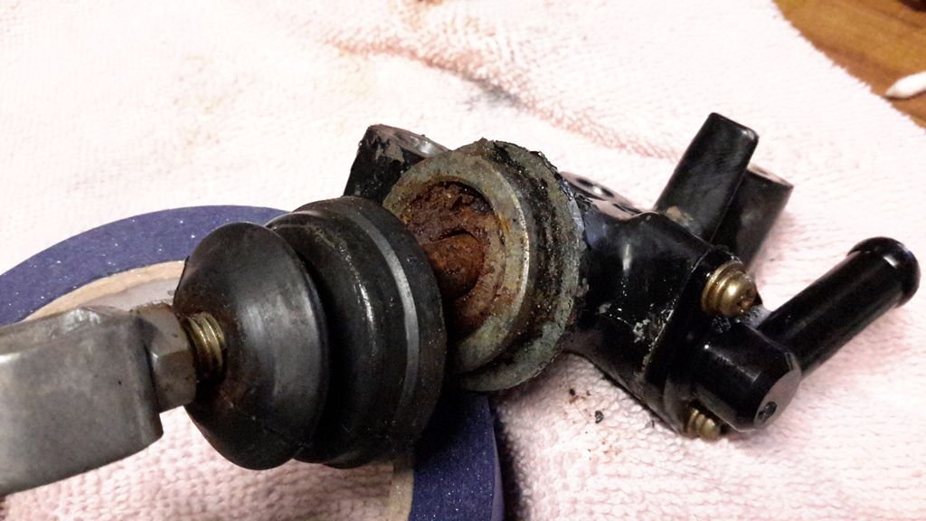

    Right now I found out why my back brakes don't work. The master is seized and this one looks nasty. When I get back from Vegas I'll try all my recipes to unstuck it and rebuild.

    My rear master was worse than that. Piston was a bit of a bugger to get out. I had to do the last resort. Drill hole in the piston, screw in a self tapping screw and pry it out. Bore was still in good shape. Rebuild kit and away I went.

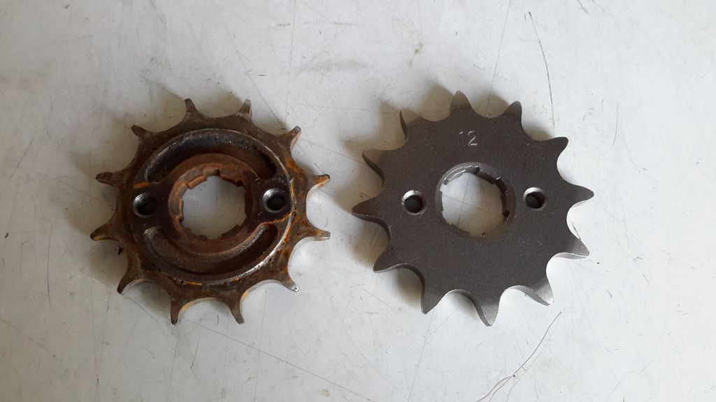

    New sprocket and chain.
    It really looked worn when compared side to side
