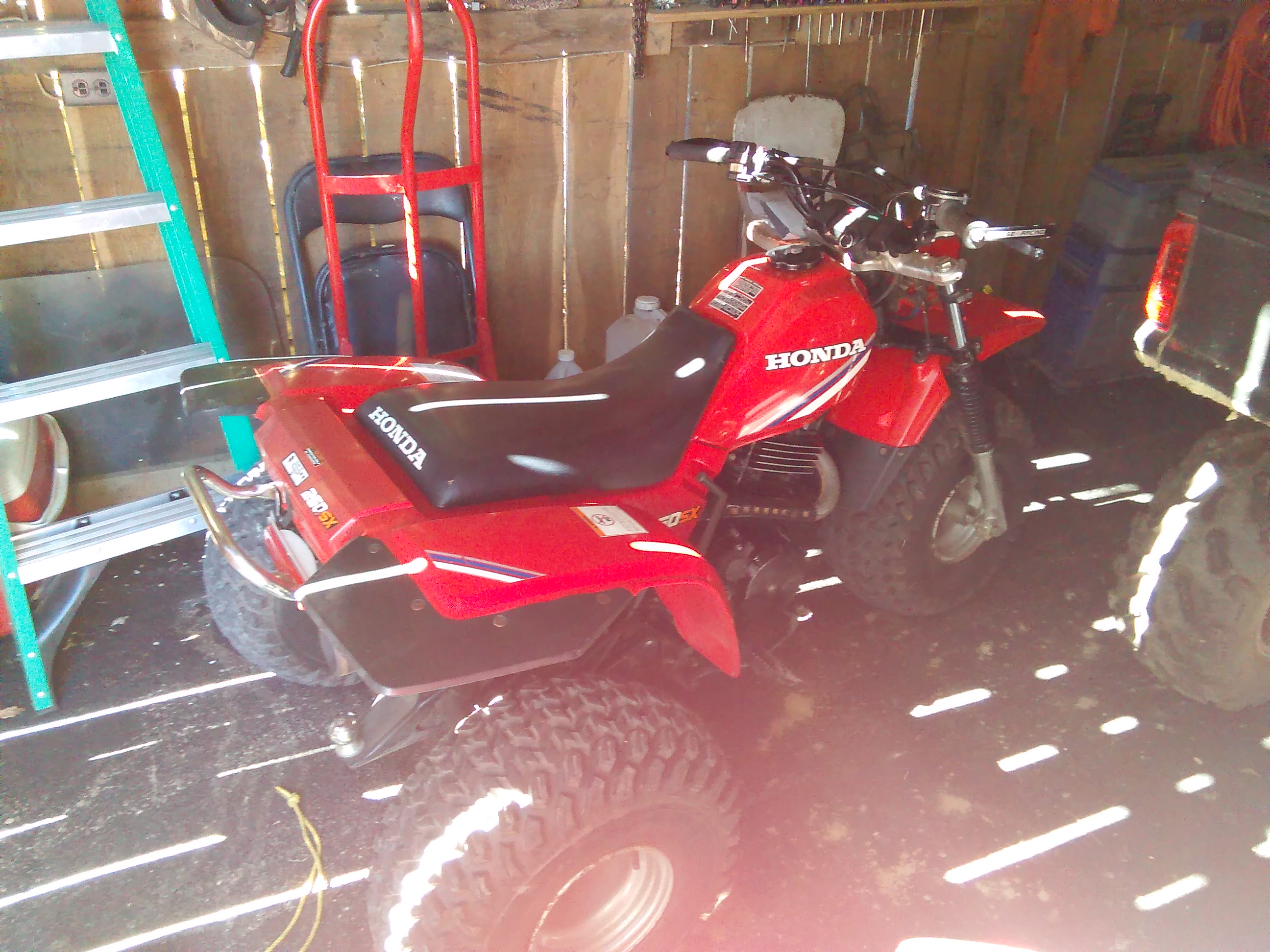

    Got this thing practically from the original owner. All documents title, service work since new. Those are original grips, seat cover, and I have the two factory rear tires.

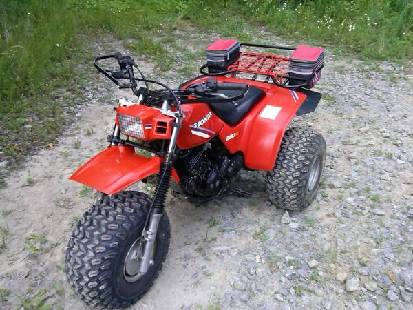

    BigRedGrizzly's Avatar
    BigRedGrizzly is offline At The Back Of The Pack Arm chair racerAt the back of the pack
    May 2015
    Jersey
    296
    That's a beaut, Clark!

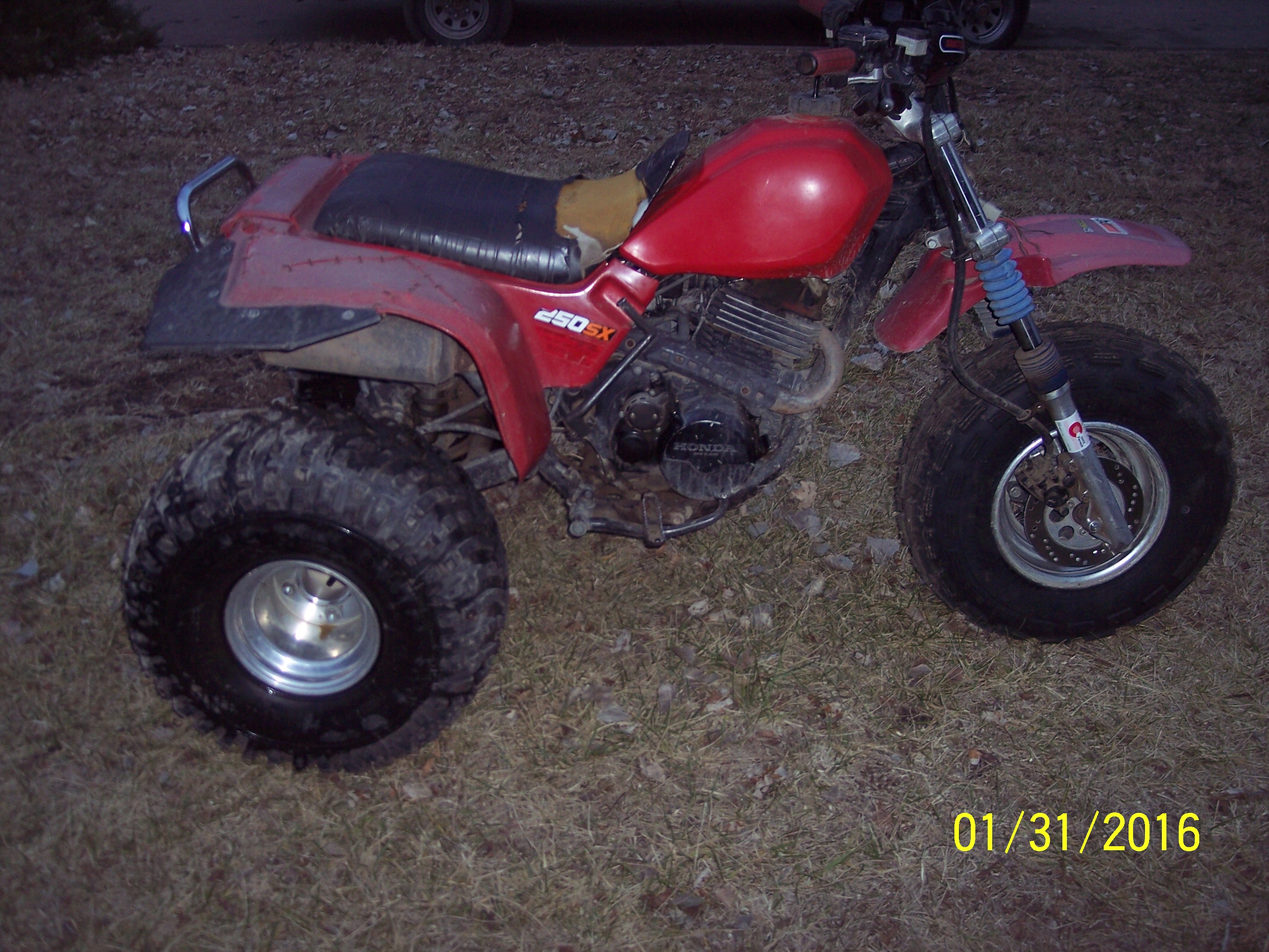

    Not very photogenic at this time, but here she is. Remember I only paid $250 for it. This after I swapped the old tires onto the rear rims. I'm now running a pair of used 22x11-9 MudLites mounted on stock TRX450r rims that I bought on ebay for $135. I also included the one with the wheel spacers installed.Click image for larger version.
ID:	238244Click image for larger version.

    Sounds like you got a good deal. Those are stock honda 450r rear rims? Were the spacers also adapters or are they the same bolt pattern 4/110?
    Apr 2014
    Edmond, KS
    2,591
    I feel like I got a good deal. I'm slowly fixing it up. The rear rims in the picture are stock 8" 200x rims. You have to run the spacers so the 200x rims will clear the brake drum. They are just spacers, not adapters. Same 4/110 bolt pattern. They are 1 1/2" wide and they are the good bolt on type. I don't have a picture up close with the 450r rims on it. I might not have to run the spacers since these are 9' diameter, but I still like the extra width so I'll keep them on.
