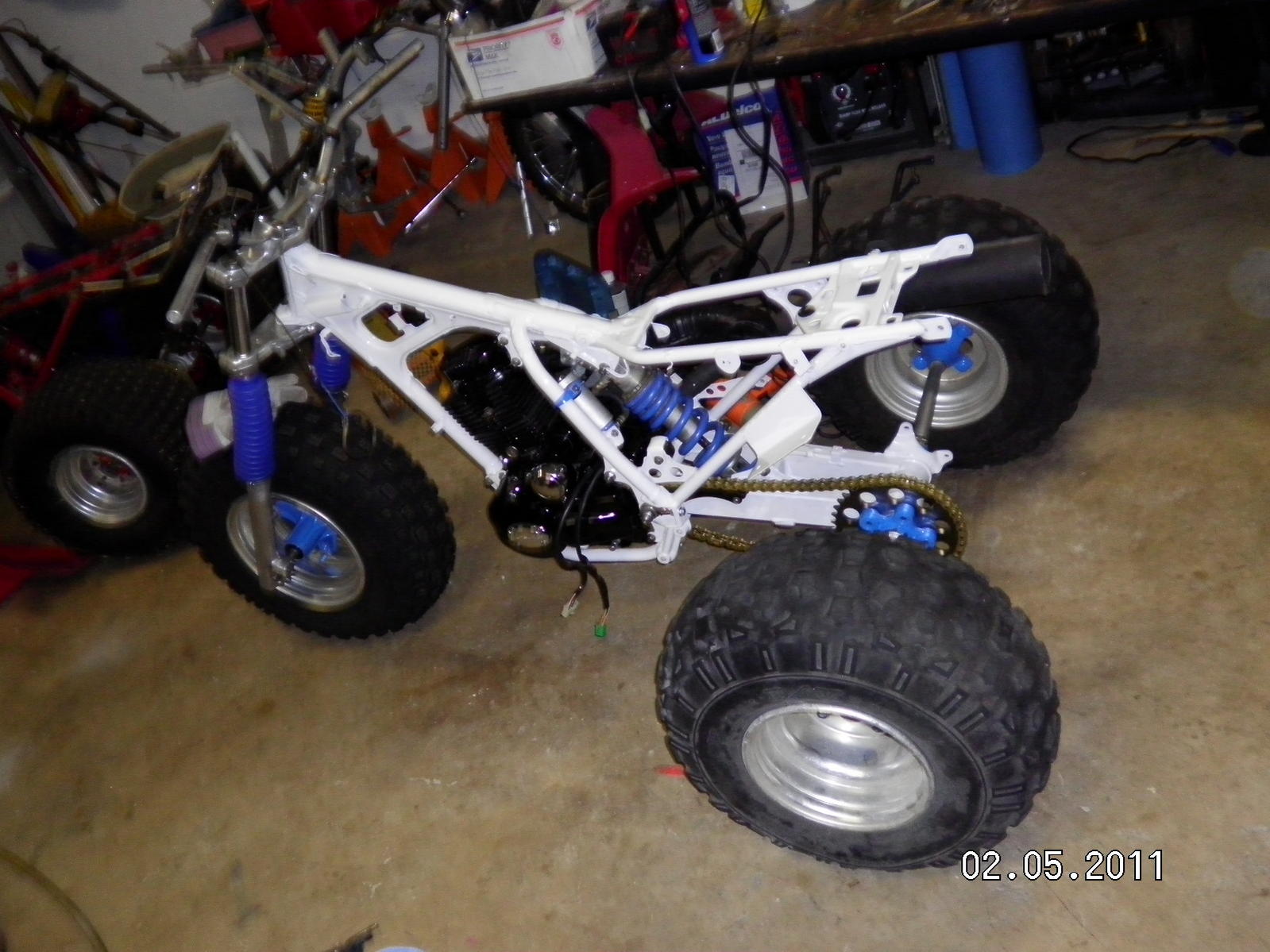

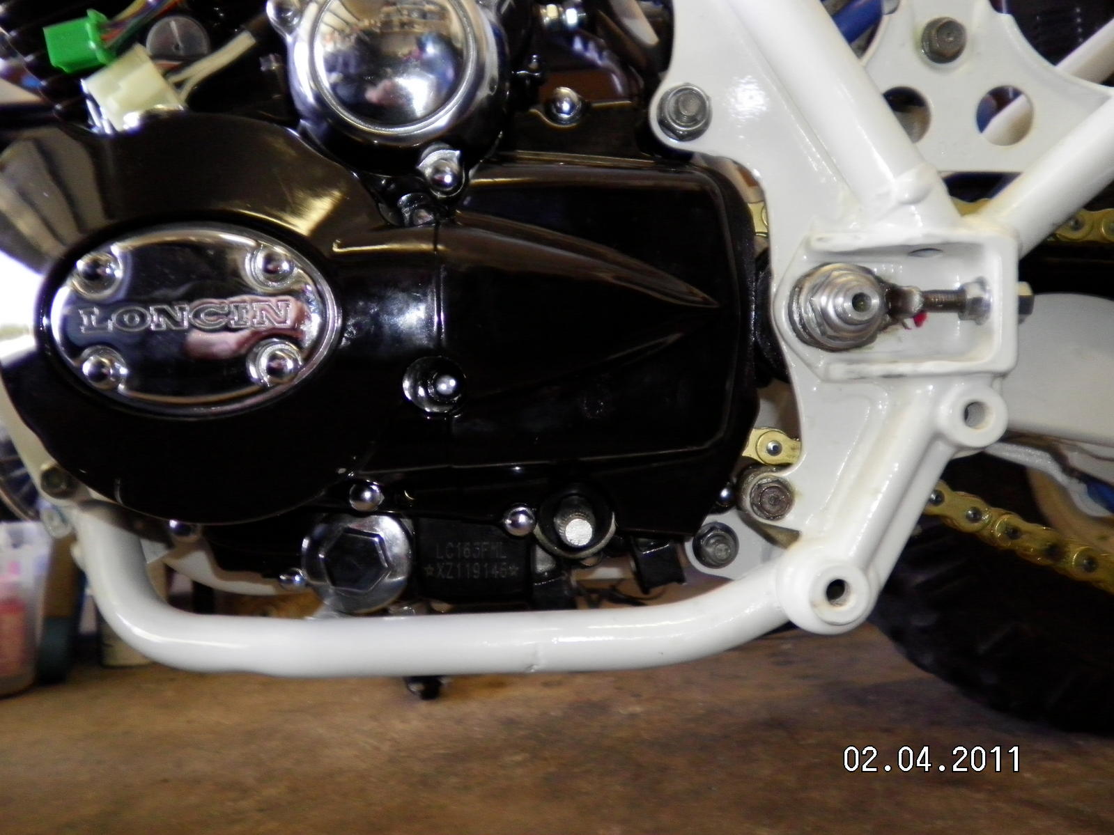

    I vote for the Lifan if you're up to the wiring challenge.
    Are you putting it in an X or a hard tail?
    I put one in a 200X I bought with no engine. Ran great! Was a great trike. Only sold it after I bought a 350x and to 200X never got ridden again...

    This thread is about putting one in a hard tail.
    http://www.3wheelerworld.com/showthr...90-lifan-200cc
    If you're patient, you might find a complete 200cc dirbike on CL for less than $500. I got mine for 200 with near 0 hours on it. It took a while thought...
