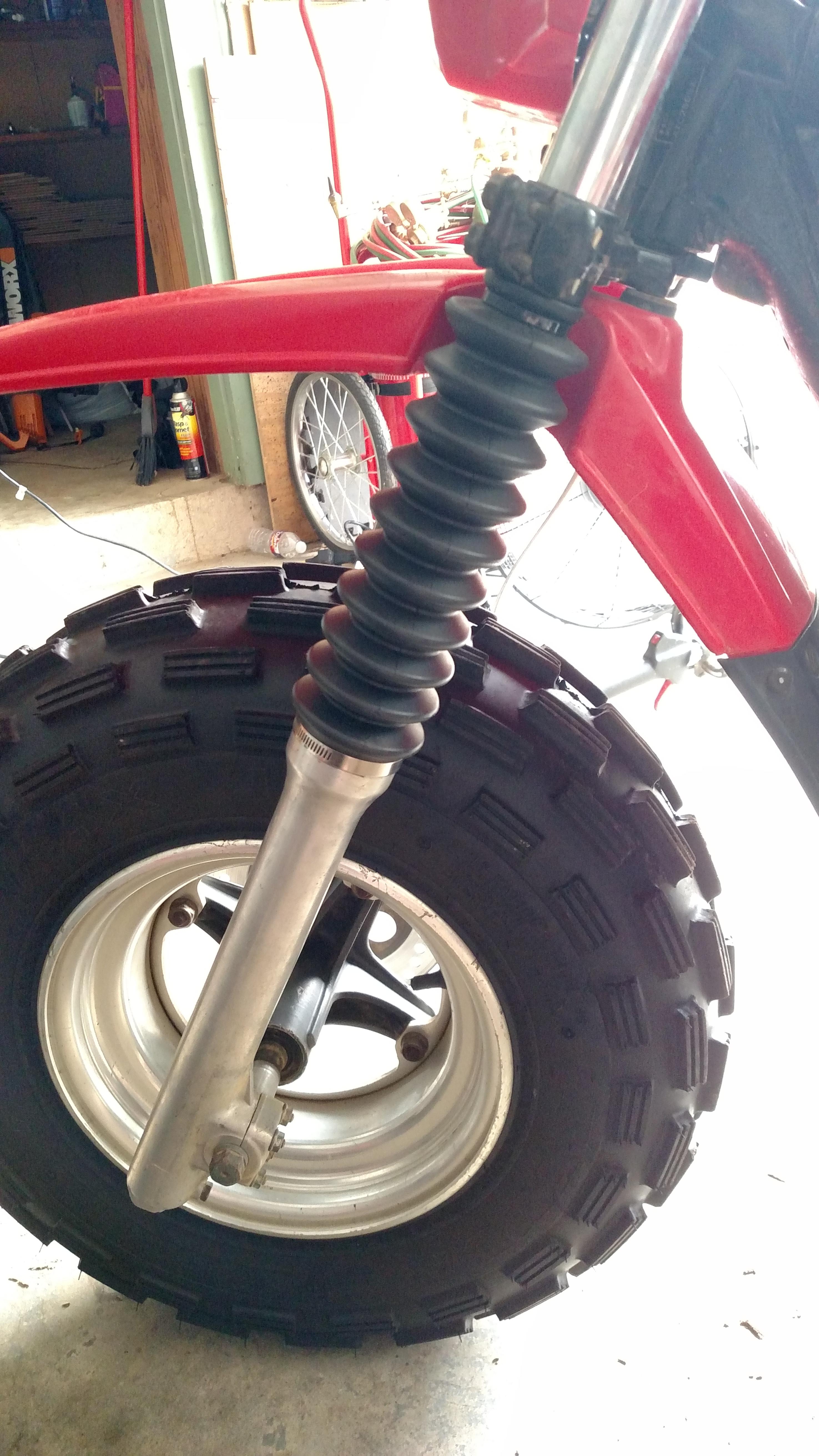

    The front brakes were going to be easy. Just swap in a 200X front end and done. Not quite. I wanted to keep my SX front head light and fender, so the 200X forks will fit into the SX triples. Awesome! Then I had to create spacers to center the 200X hub in-between the forks. Not too bad, a few .860" spacers later and the front end was complete.

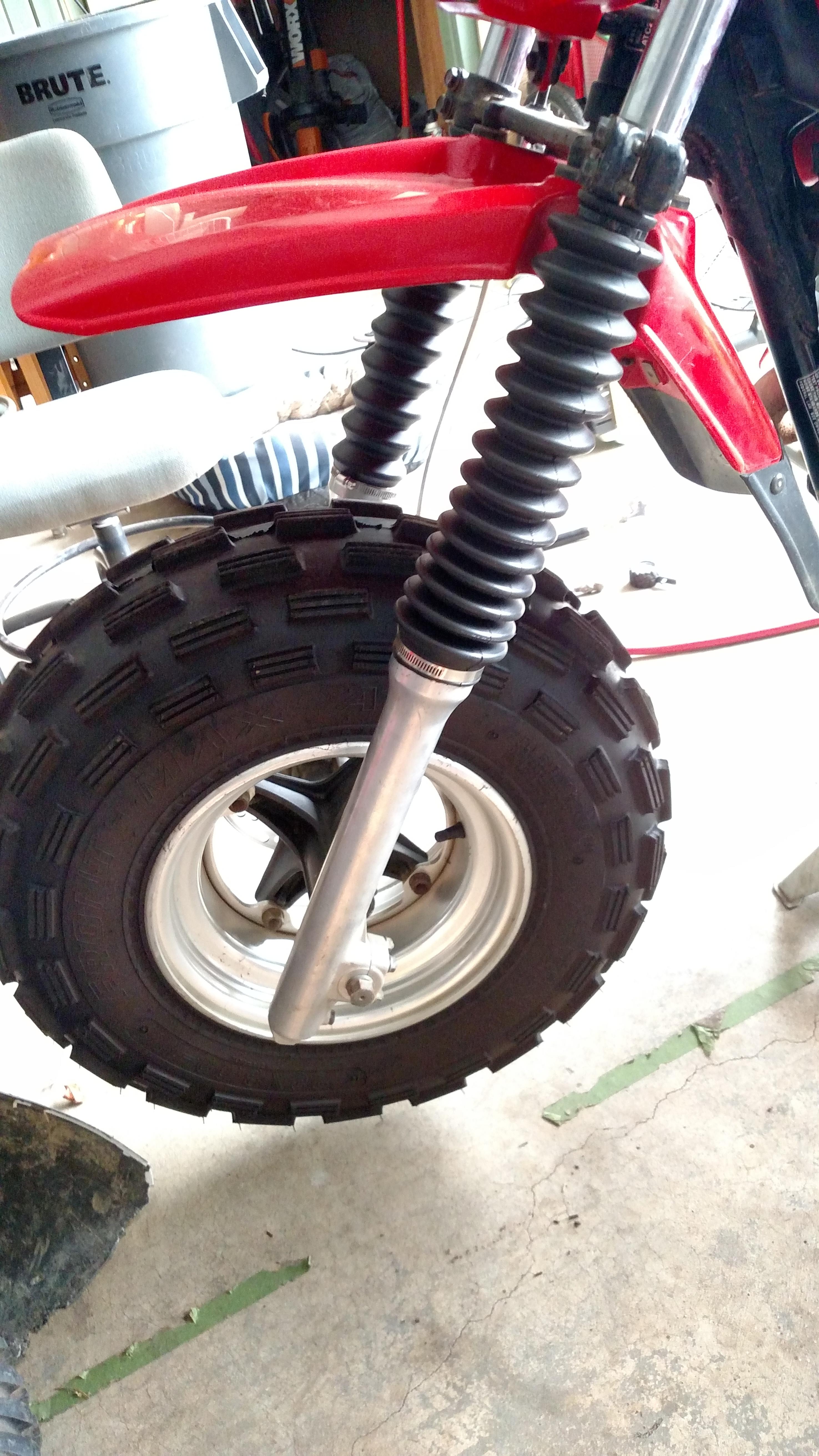

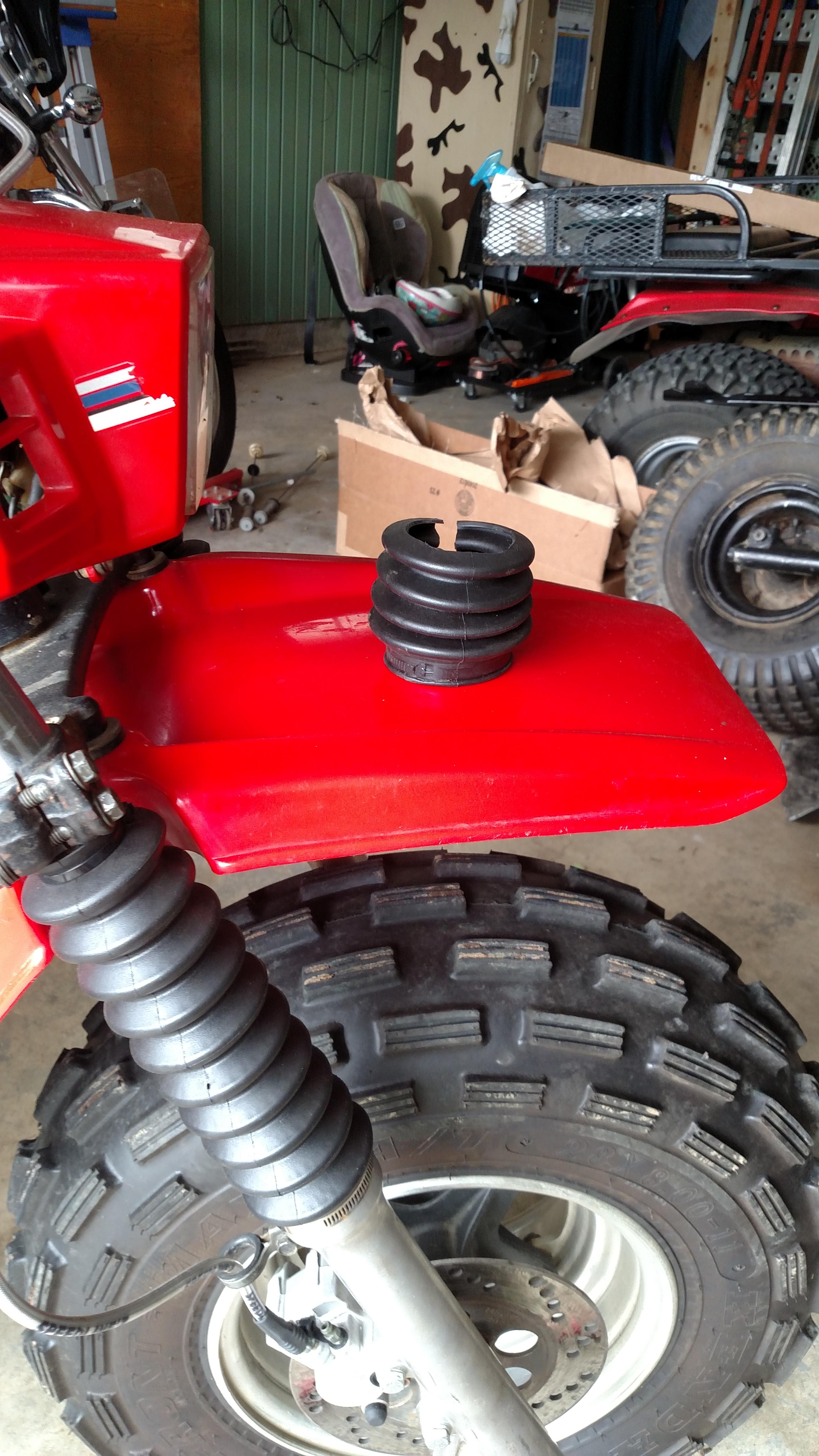

    I had the replace the master cylinder and the fork boots. The 200X master was a little pricey, so I found a pair of honda silverwing masters on Ebay. Those things fit and worked perfectly. I also ordered some black fork boots and a kenda K284 tire to finish the font off. But the boots were too long for my taste. I ended up cutting 4 billows out of the boots and they turned out great.

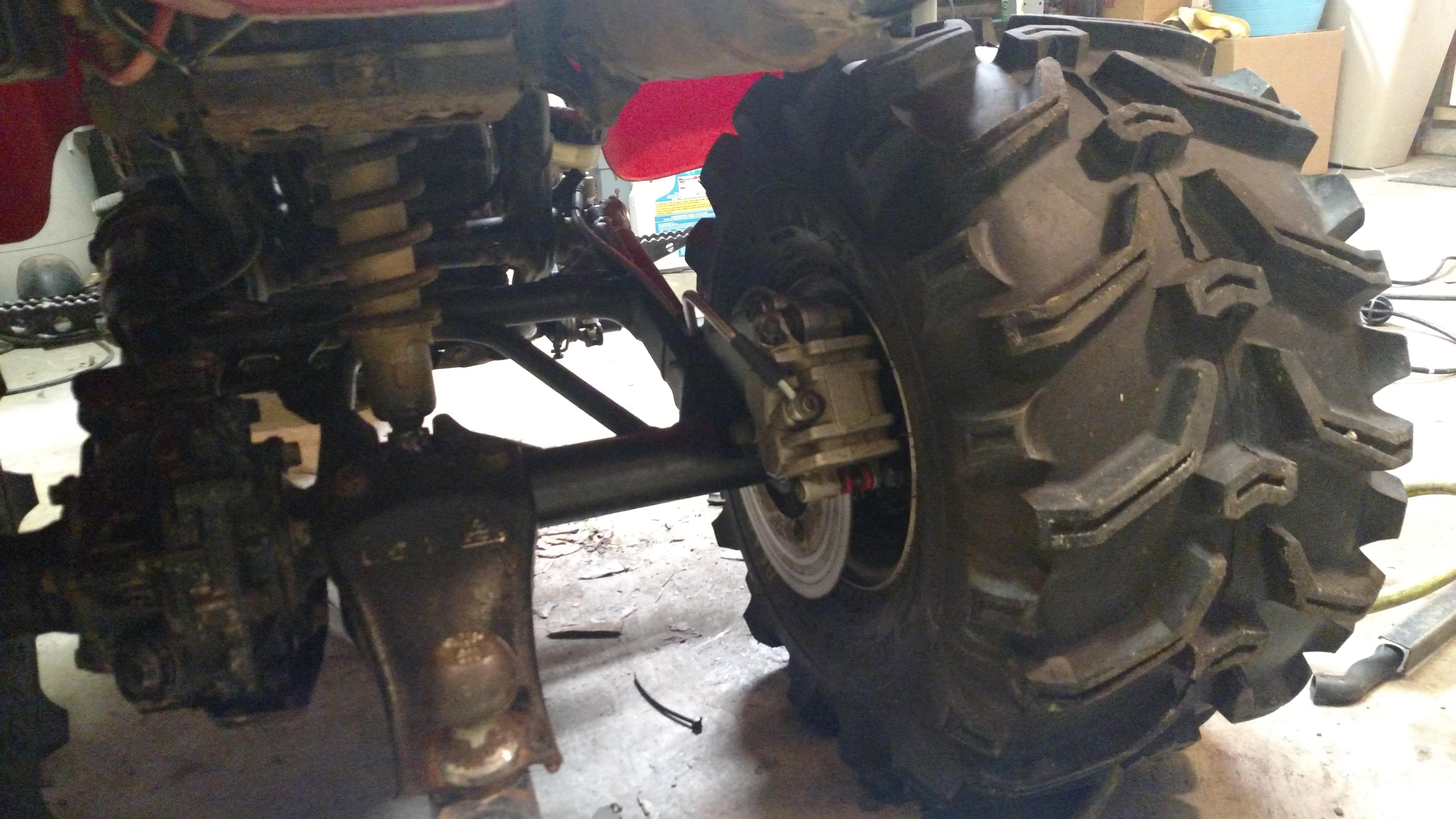

    Now that the front was done it was time to focus on the rear. This was going to be a bit more of a challenge than the front. I first had to find a rotor and hub that would clear the rear axle tube. That was finally found after searching a local ATV salvage yard. The owner was extremely helpful providing tools and tractors to lift and move the ATVs. We spent all morning hunting for something that would work. below is the parts I used.
    - stock 250SX rear hub bearing carrier
    - 05 Yamaha grizzly 450 left rear rotor and hub
    - 03 yamaha front brake caliper (I used the front because it has twin pistons)
    - 95 CBR 600 F3 Rear master Cylinder
    - Honda Silverwing front Master Cylinder
    - thestuntfactory junction valve (connect the front and rear master cylinder to operate rear brake)
    - Speed linez braided brake lines

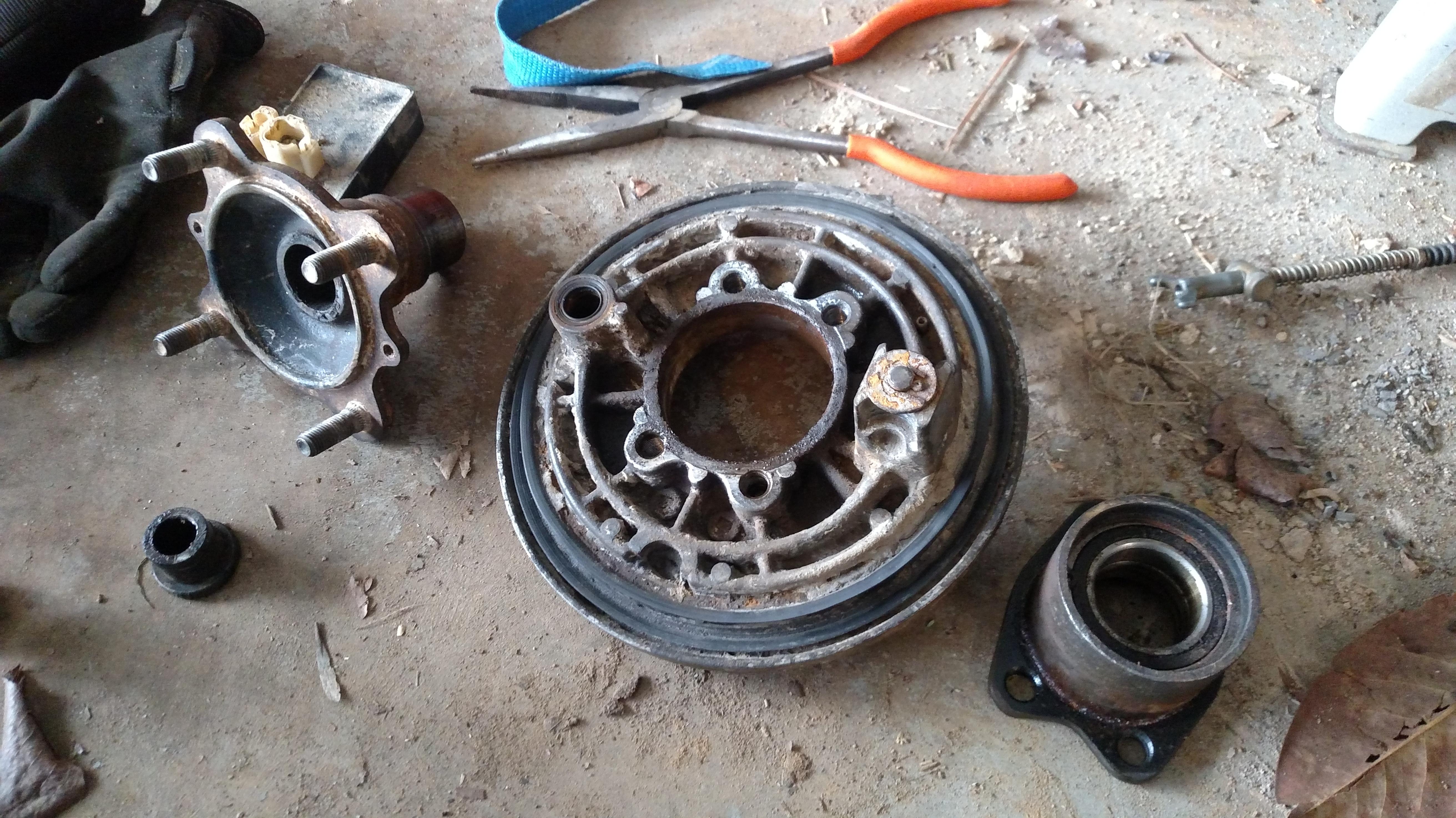

    First step was to remove all the stock brake assembly. Then I pressed the bearing carrier out of the backing plate.

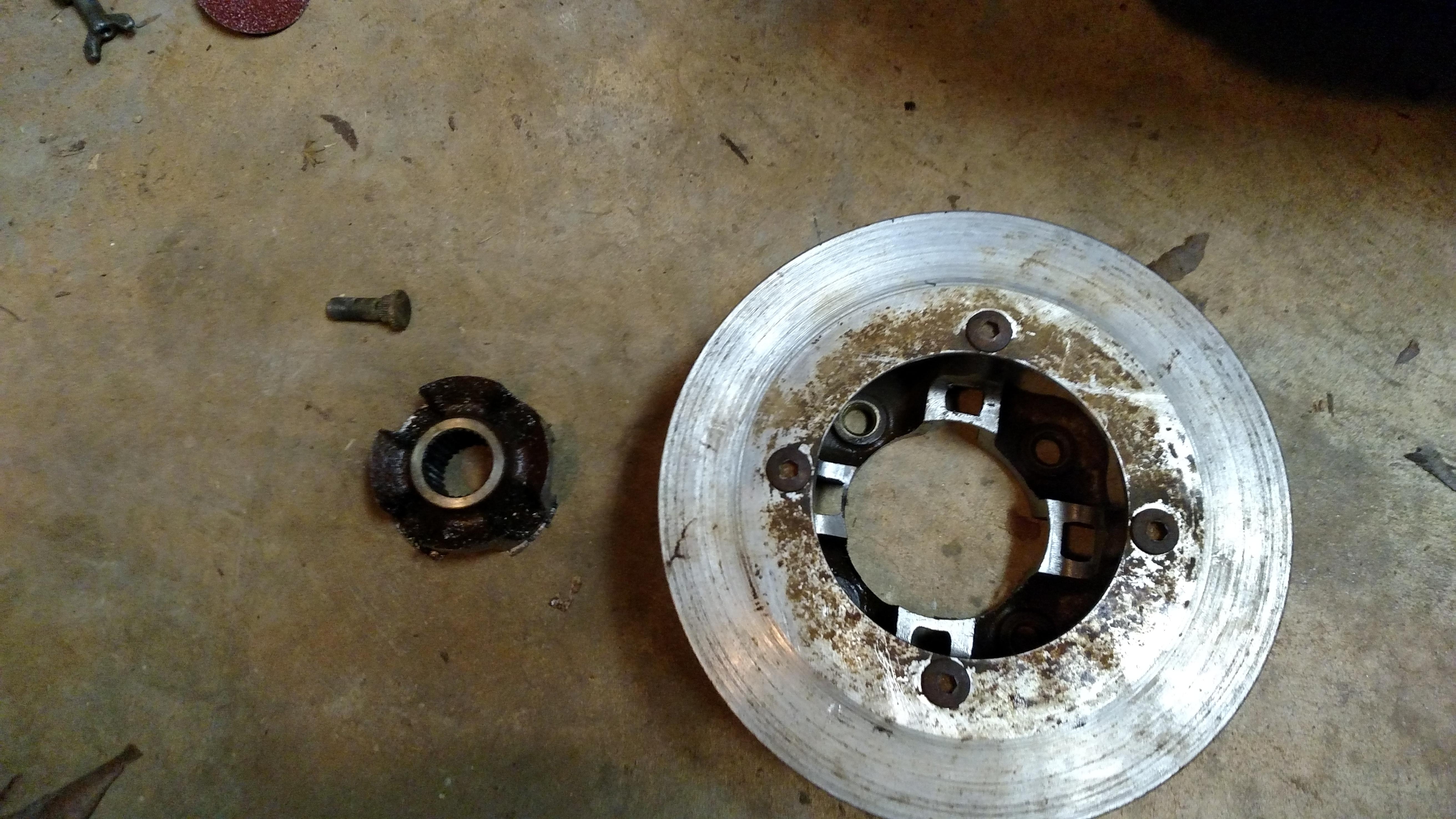

    I attached the bearing carrier using some socket head bolts and nylock nuts. Then I machined a 3" diameter hole into the yamaha hub.
    The yamaha hub has the same 4/110 bolt pattern as the SX, so I made 3" spacer bars and tapped then for an m10x1.25 thread and welded the other end to the back side of the stock SX lugs. I then bolted the yamaha hub to the spacer bars marring the SX and yamaha hubs.

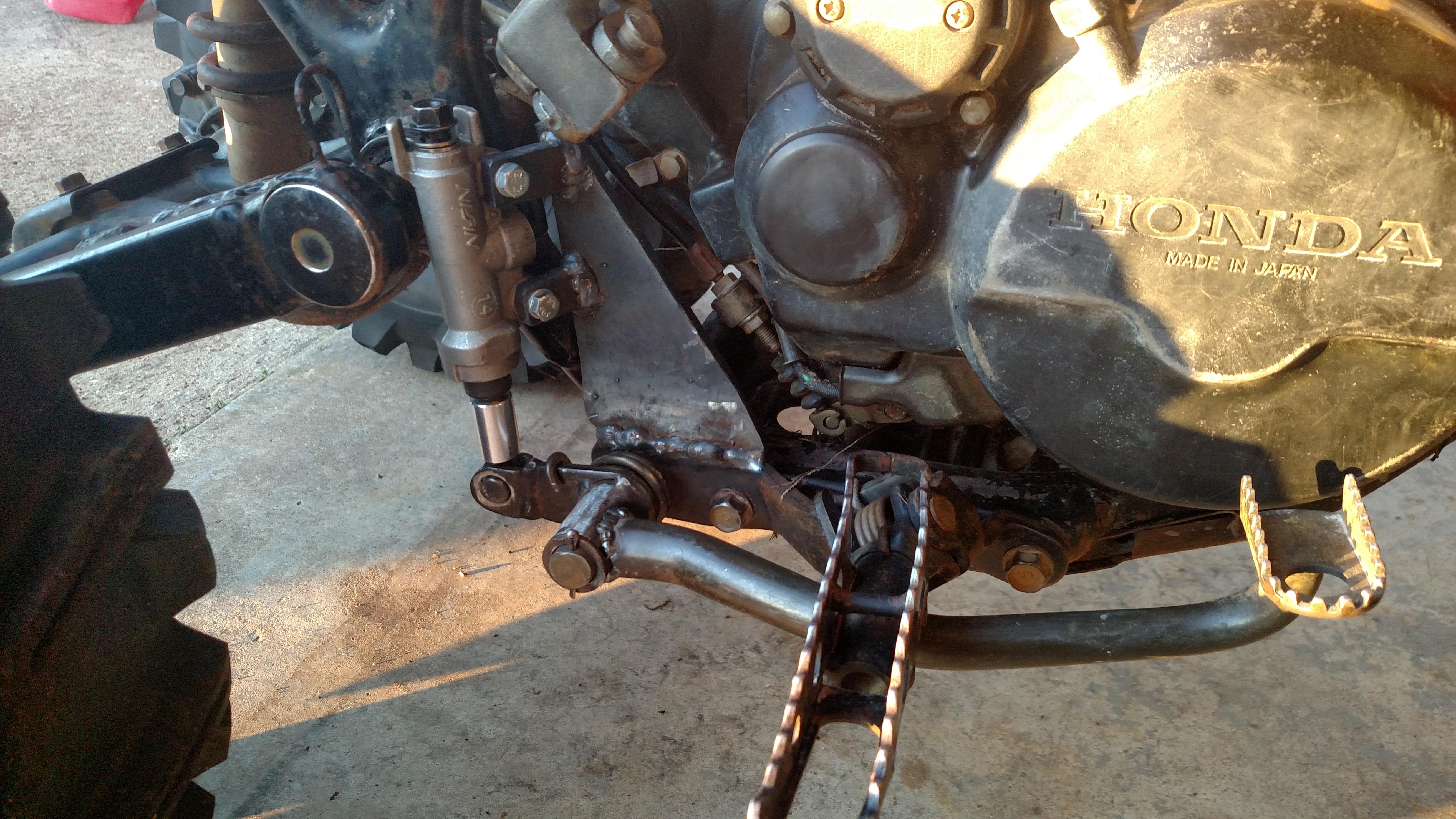

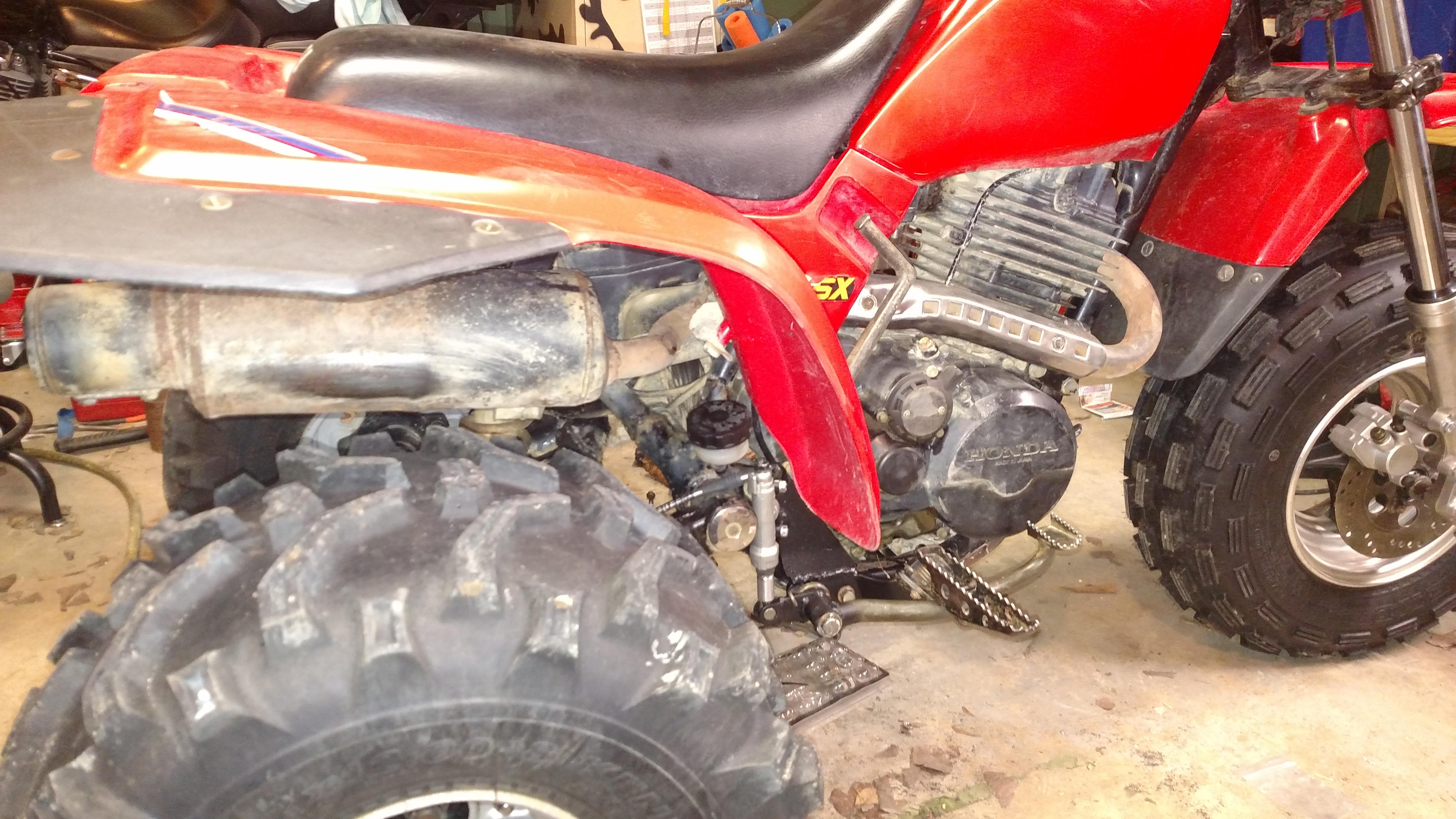

    Now it was onto fabricating brackets for the rear master and the caliper. I few card board templates and 1/4" plate with the torch and the brackets came into shape. For the master, I welded the brackets to the foot peg so that I could easily remove it in the future for maintenance. The rear was a different story as I seen no other way than to weld directly to the swingarm. I also installed the junction valve in the rear master. This way I can control the rear brake with either hand brake or foot brake. This comes in handy on the trails and especially the hills.

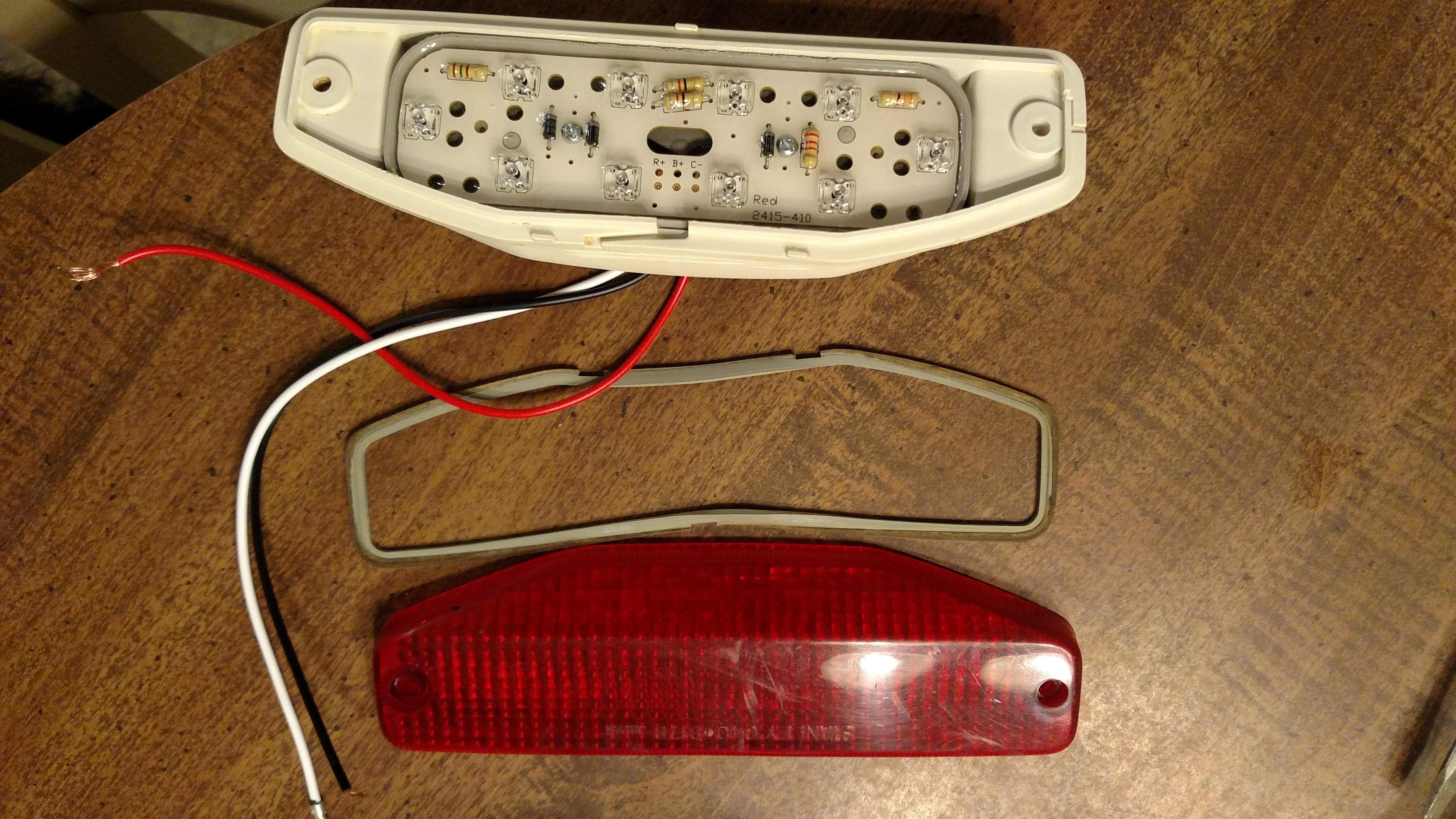

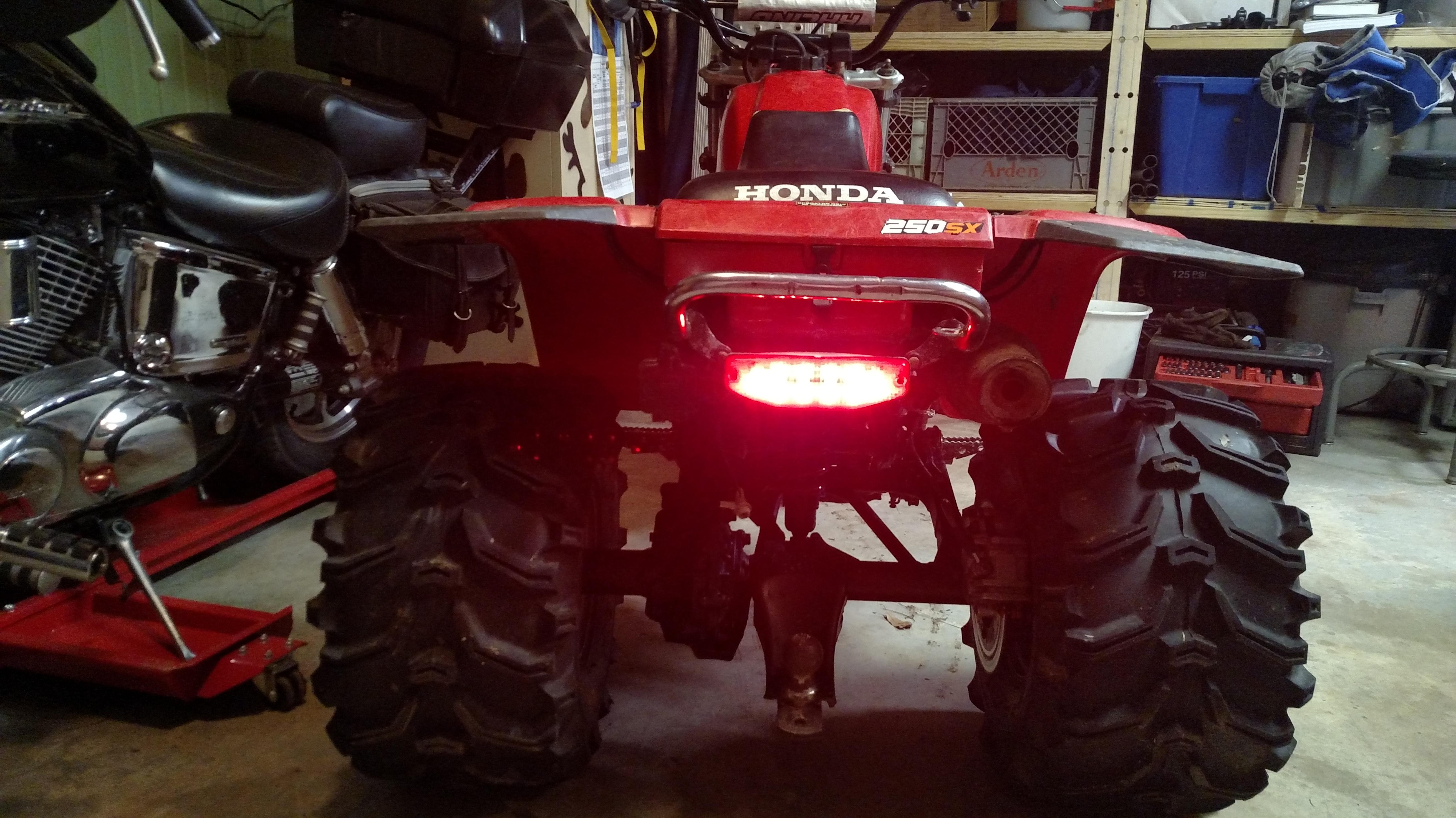

    Now that I have the silverwing hand masters, they have the brake light switches, but the SX only has a tail light. Dang. Well lets see how well a 6" LED trailer light will look on the back. Not good! I noticed the LED board looks to be about the same size as the stock housing. I took the lens off the trailer light and did some quick measurements. Look it this! The LED board is almost perfect fit for inside the stock light. Time for some dremel work. The LED fits!! wow. now to remove the old light put in the LED secure using some hotglue( ok, ok, ALOT of hotglue) and do some wiring on the trike and PRESTO! LED tail and brake light on the SX. Looks very similar to the stock 450R tail light,

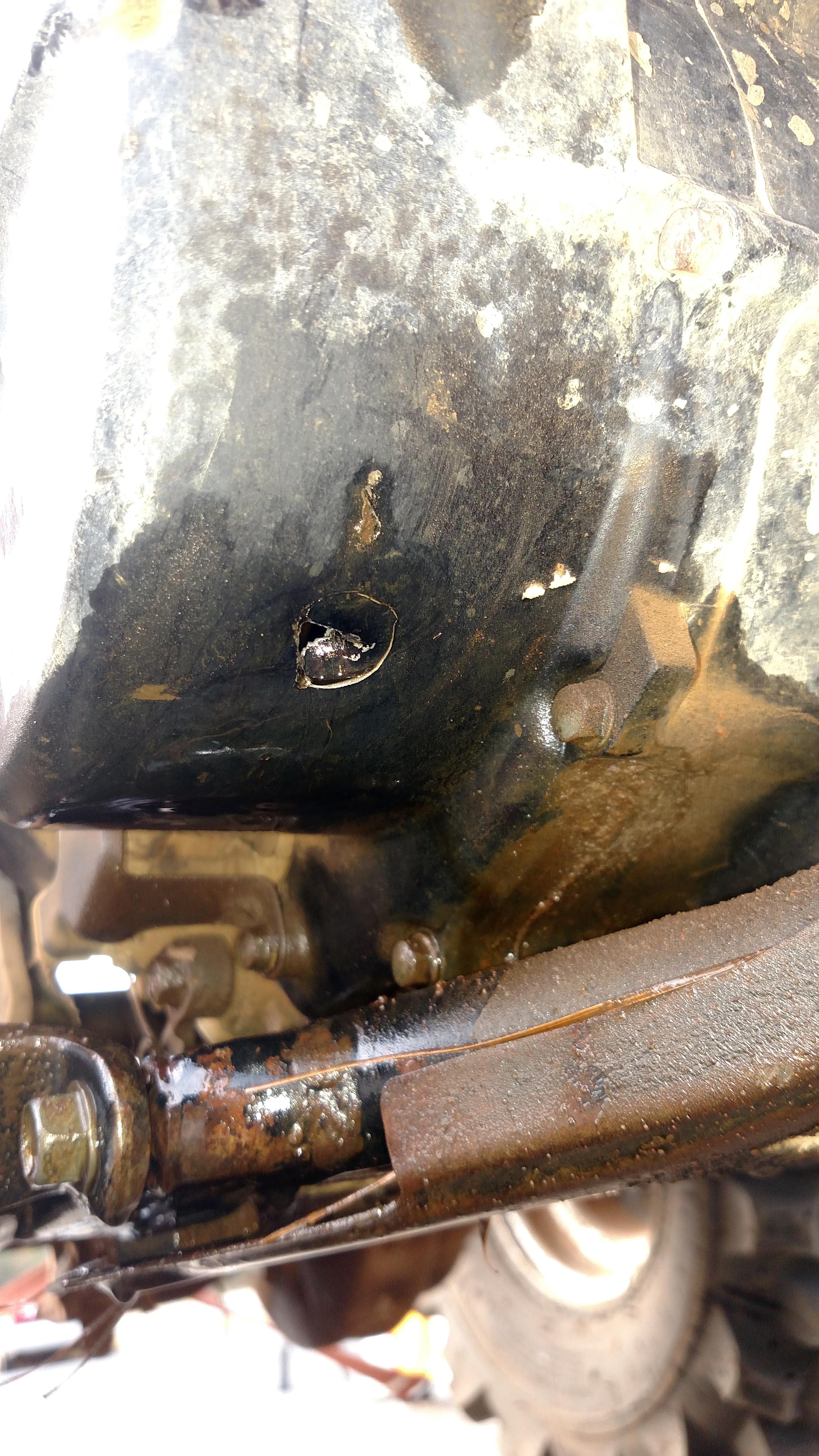

    Went trail riding at Top Trails in Talladega AL. The riding was awesome. The weather was great, the people were awesome, and the riding was exciting. The terrain was very rocky. I was hitting one of the trails kind of hard when disaster struck. A rock came off of the front tire and hit the right engine cover and put a 1/2" hole in the case.

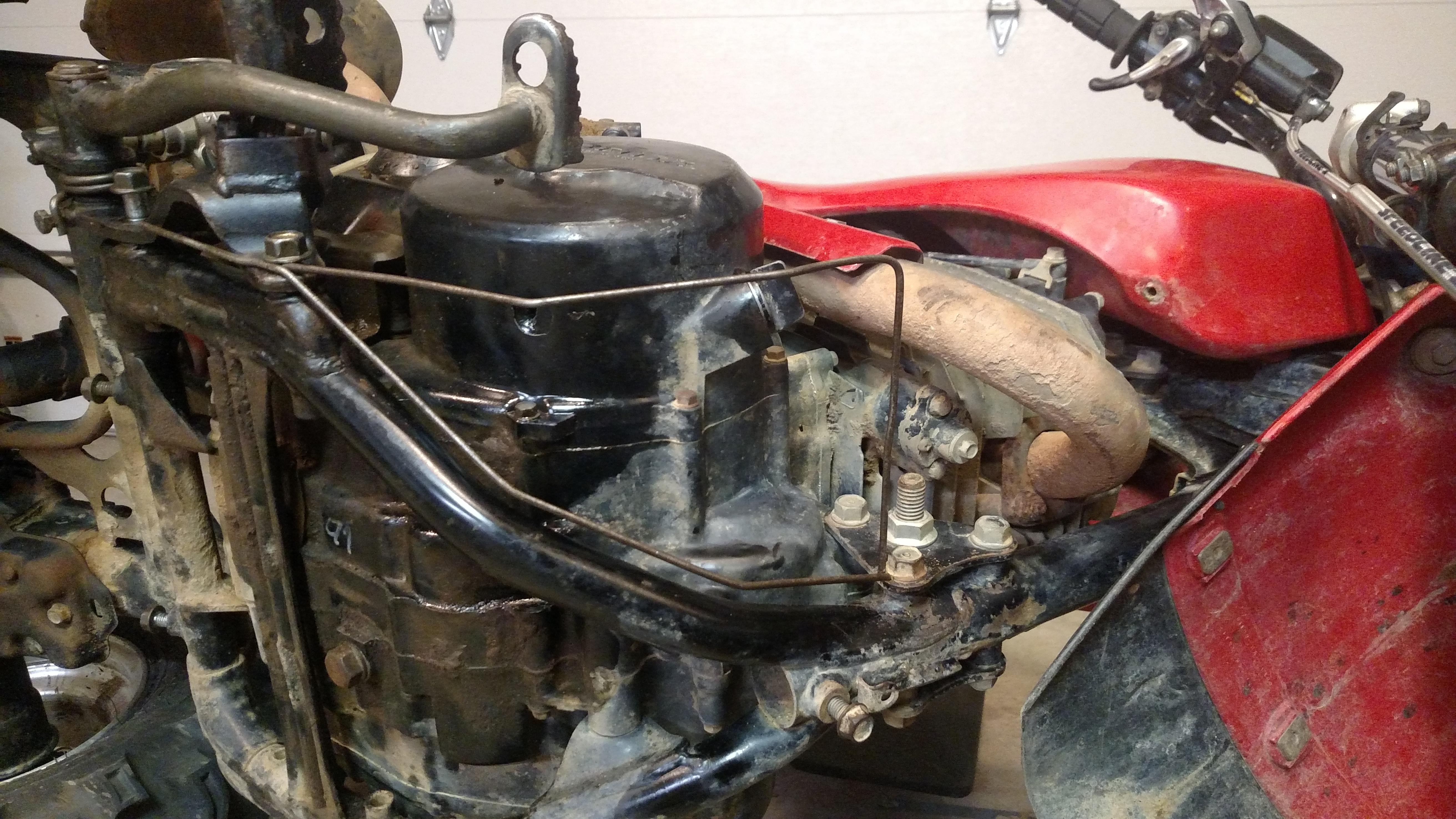

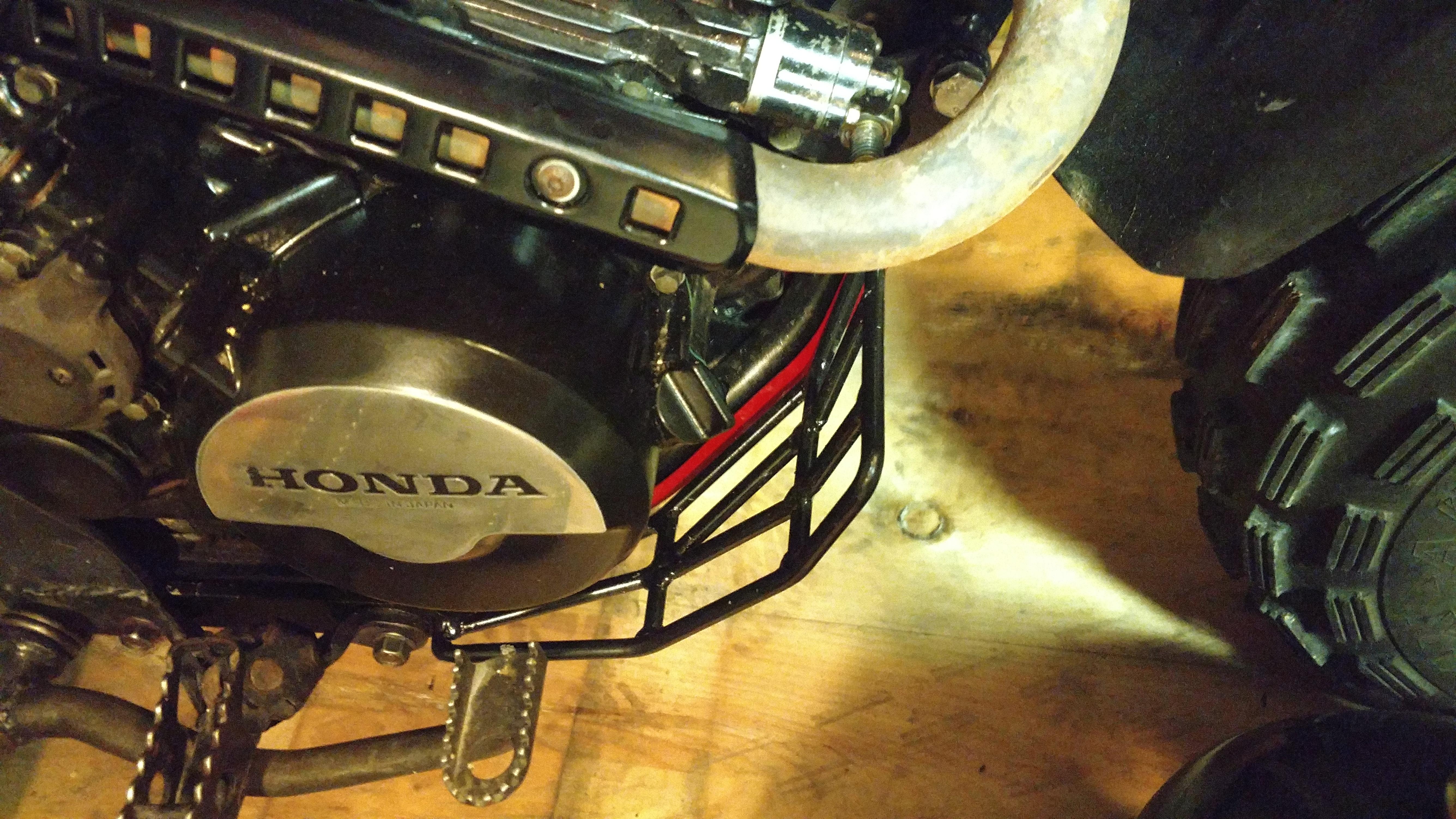

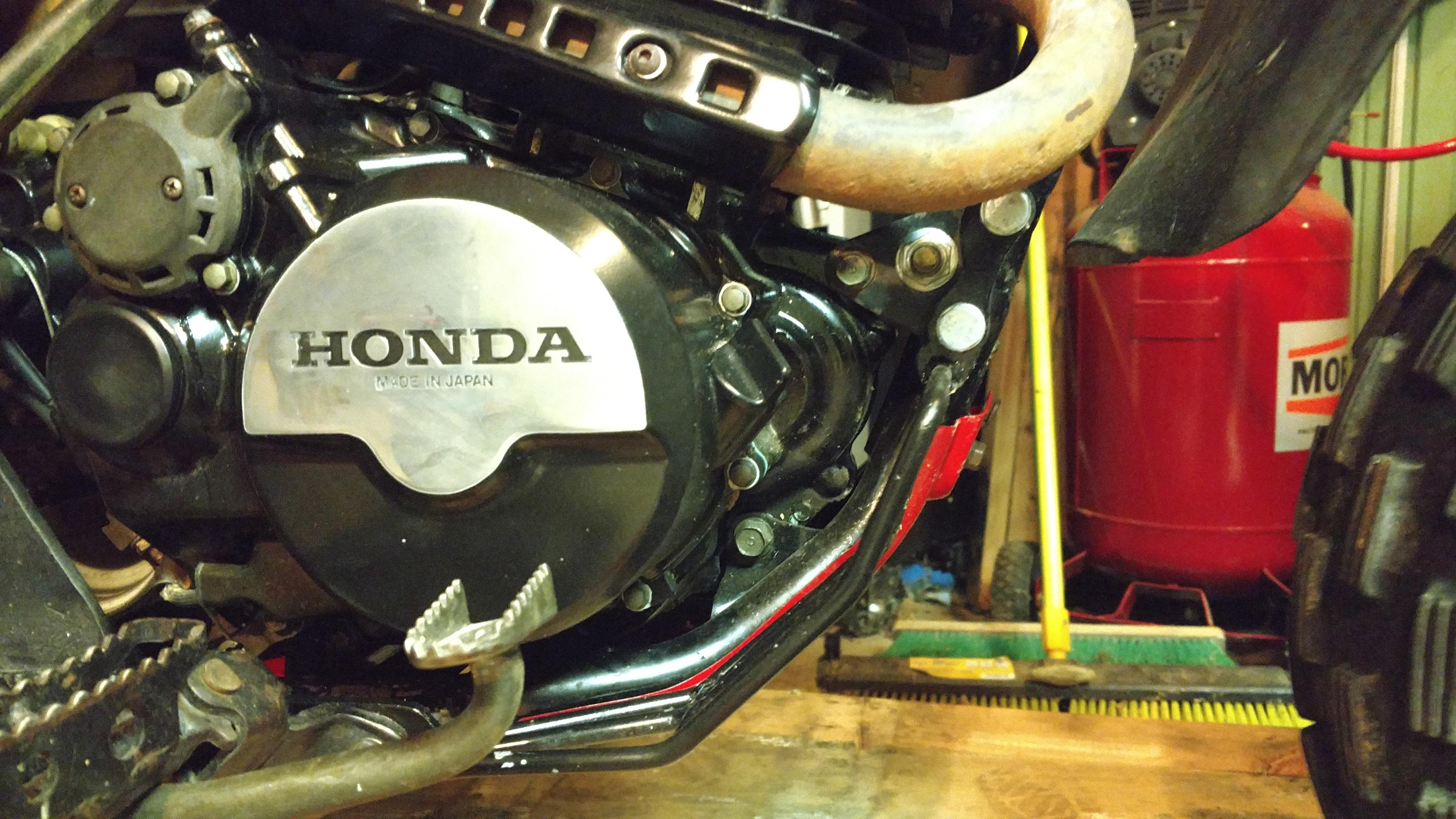

    So I picked a parts bike (85 250 big red) and started to take apart both trikes. Got them both apart and threw some black paint on the BR cover. installed new gaskets and the SX was saved. But, we can't have this kind of damage happen again, so I build some removable engine guards for both sides of the frame.

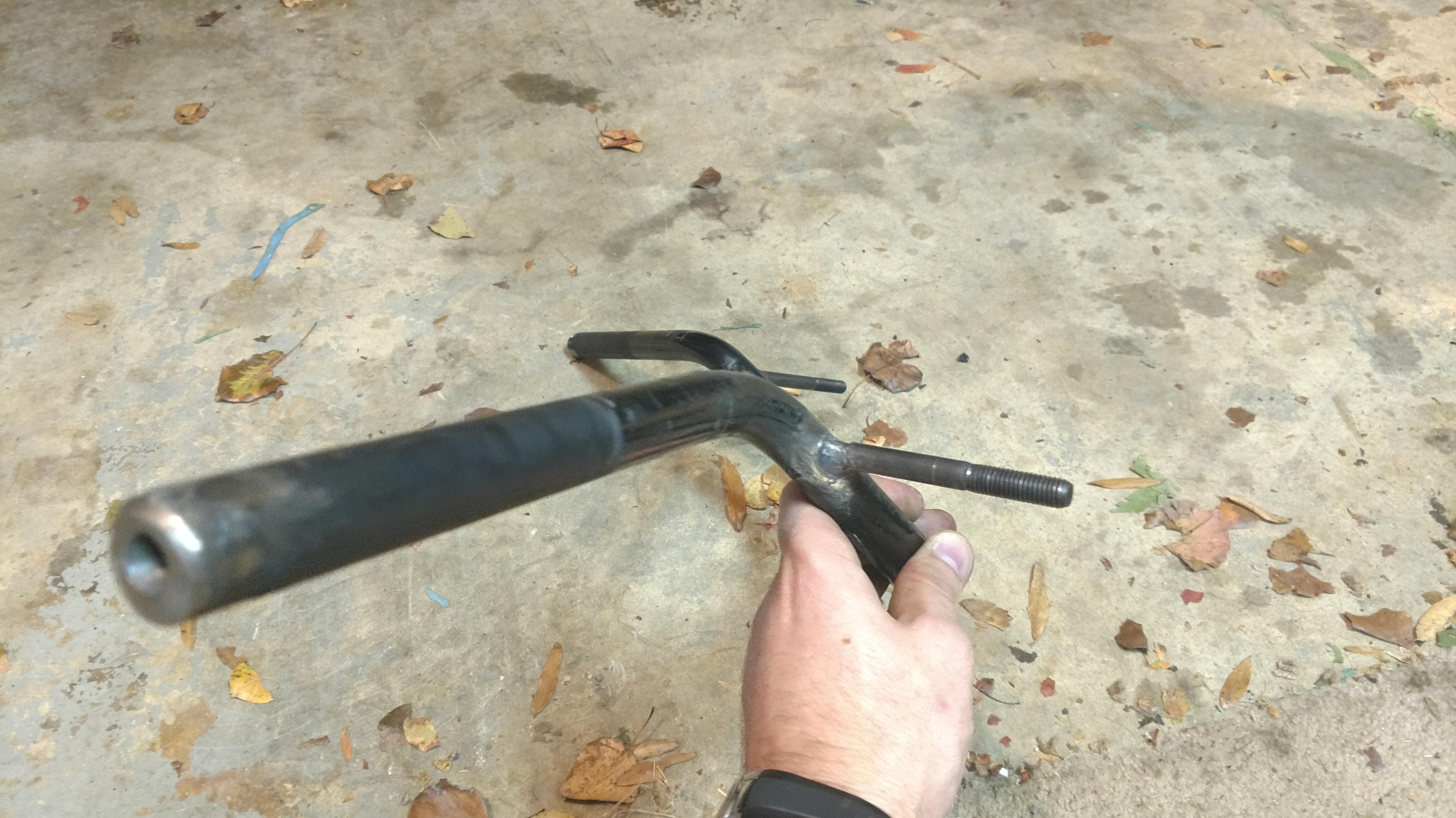

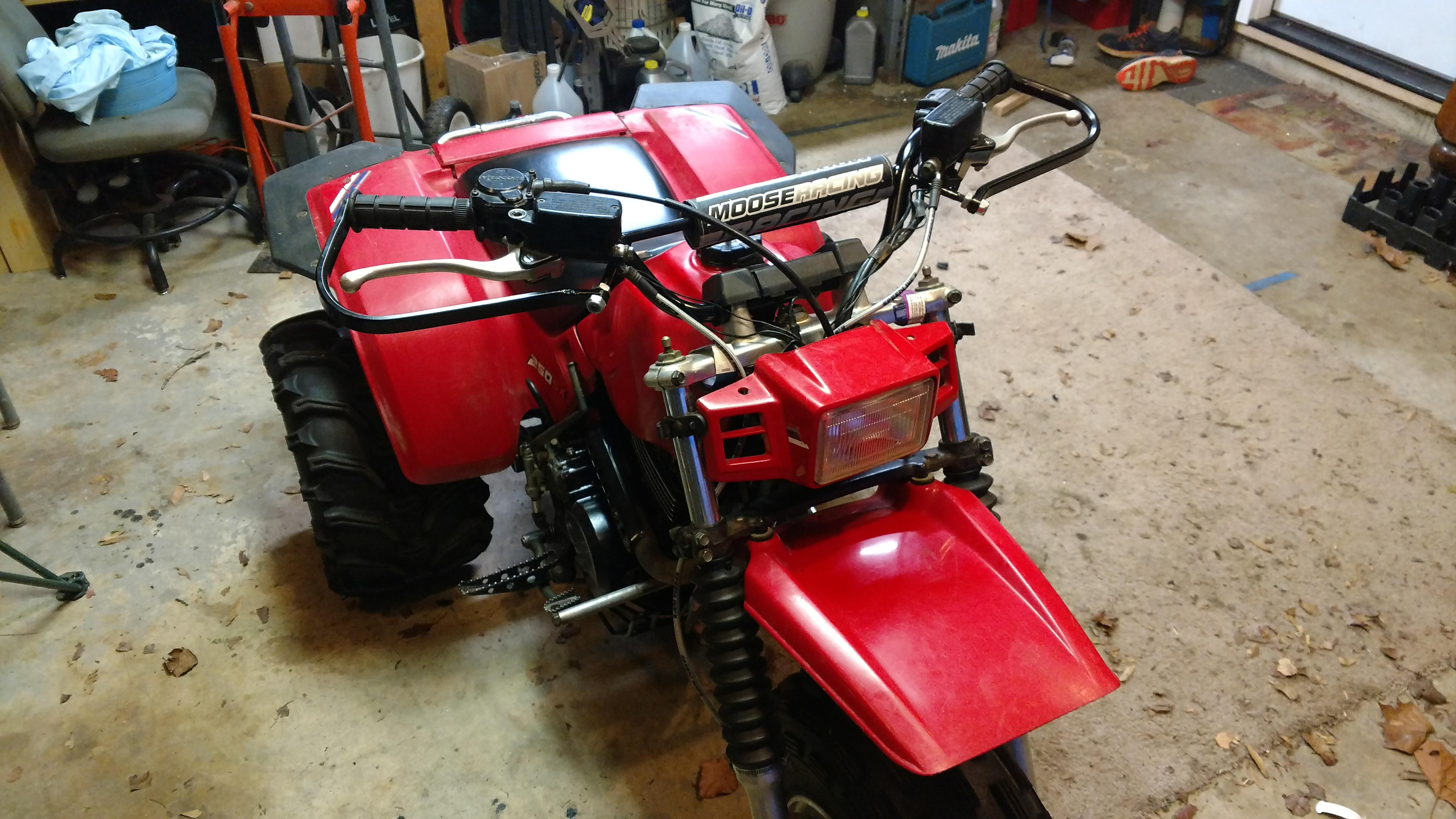

    Now that the engine is protected, I needed to think about my hands. But, with all the hydraulic brakes I have, no off the shelf hand guards would work. So a buddy gave me a set of solid aluminum guards that he didnt want. So i got out the welder and vise and fabbed up some hand guards.

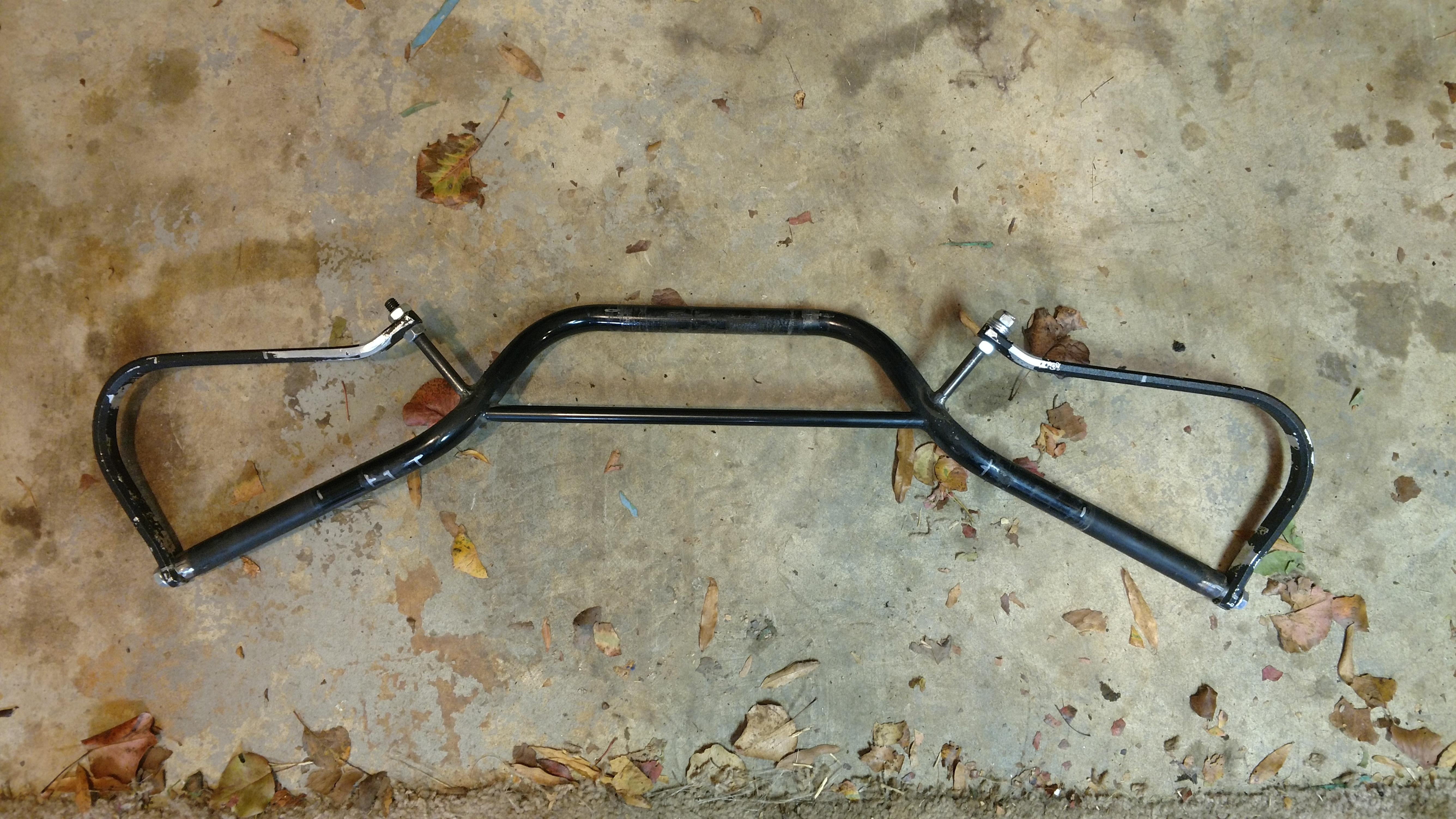

    Well, I was able to get some progress made on the six pack rack. When I first got this, I did not like how low it SAT compared to the rear fenders. So, I made a few aluminum pieces and hacked up my brand new PRM rack.
    Here is the stock SX grab bar.
    Here is the stock PRM six pack rack
    Here are the mods that I did to the six pack rack today. I gave it a 3" lift and 1.5" further back. It is still strong ( will hold 190# me) and I think this looks alot cleaner.
