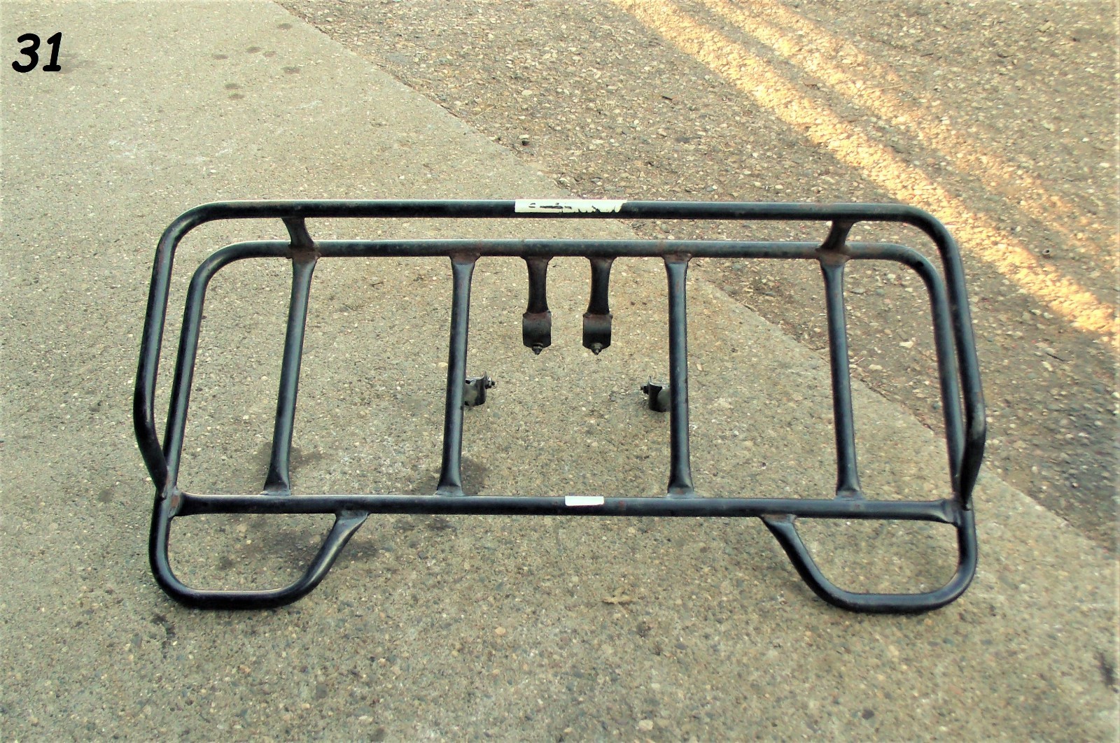

    If you need storage space on it and it does not have a rear rack, you can sometimes find original rear racks on Ebay, however, they are rare and quite pricey . You might consider buying the one below . It looks like they made 2 different styles.
    http://www.ebay.com/itm/like/3223900...&ul_noapp=true
    They also made a front rack and a headlight guard and the rfront rack looks like it came in 2 different styles also . The front rack and headlight guard are two separate pieces so you can run just one or both of them.
    http://www.ebay.com/itm/FRONT-LUGGAG...3D322390012264
    Verify with sellers that they will fit your bike.
    In addition, if you have a rack, you can mount a small winch on it if you want . They make a mechanical and an electric style, and since that bike has a battery so you can use the electric one if you want . Just remember to increase the engine rpm a little when you are operating an electric one.
