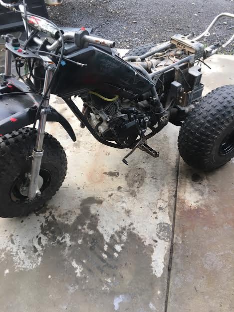

    Okay new to this forum. Name is James and I just bought a 85 YTM 225DX yesterday. I bought it to fix it up and my biggest problem is when I am riding it it goes into 1st and 2nd gear just fine and that is it. I shift up and its like there isn't anything there. I have already did the adjustment on the right side of the case and still didn't give me 3rd,4th or 5th gear. I am already thinking I will have to open up the split the case but hoping someone might know of something else I could look at. I don't have any spare parts or know anyone around me with the same trike. Also where is the best place to find parts for these. ThanksClick image for larger version.

    That's actually a 225DR which is worth more and not as common as a 225DX. You should be able to find the parts you need on eBay. Most motor parts are a direct swap with a timberwolf and bear tracker four wheeler.

    Okay sweet. Thanks for correcting me on that. I am still trying to figure out what the problem could be. Knowing that a timberwolf and bear tracker four wheeler will work for parts that makes it a bit easier. ( So I just found a few things on Ebay. One is a almost complete bottom end for 200 plus shipping and the other is all the gears and parts from the transmission for 80 bucks) Taking the trike to work tomorrow to have a Co worker check it out and see what he thinks it might be. I will probably go ahead and buy the gears and other trans parts.

    So I still can't figure out what the problem is. Everyone I have taken it to says needs new transmission and such. At this point I almost want to find a 2 stroke quad and do a engine/ swing arm swap just so I can go ride. Hard to do any riding when 2nd gear is the highest it will go haha. dt400rider I am unsure if your 84 would work.

    Well the bike was ridden hard because from what I have seen almost everything is wore out or broken. I had a buddy that builds bikes for pro riders look at it and he said it feels like a broken shift fork and the drive shaft is wore out. When I got it it barley had oil in it so unsure how long if at all it was ridden with low oil.

    you need to pull the clutch cover off and the main clutch pack and take pictures so we can see what is going on just had someone who dealt with a similar issue on facebook ytm page and it turned out was just part of the shift pawl assembly that went bad open and look before you start buying parts. also I have done a chain drive in shaft frame build on one of these is quite the adventure

    Well I got it apart and it was a broken Shift drum selector. I just ordered a new one. Still looking for cheap used parts though. Looking for a head light assembly, rear fender or even a complete fender set.
