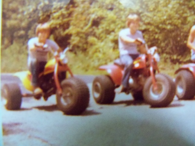

    You going modern or old school?
    If old school is what you are looking for we usually ran 16" or 18" lawn tires. You can pick some up today at the local Tractor Supply.
