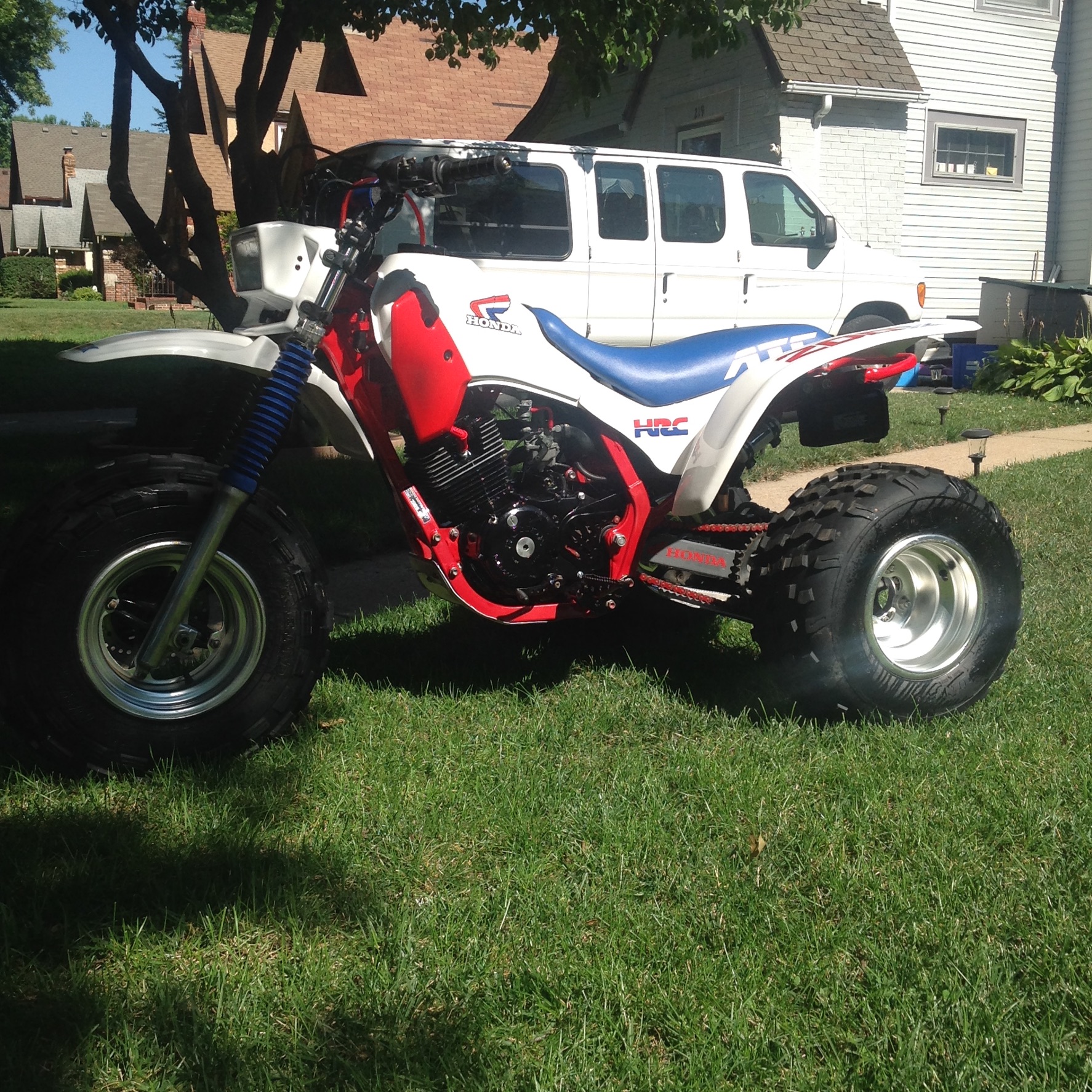

    Thanks again Shawn. I ordered those 3 up above plus the 4 stroke packing. Came to $92, but I had $32 in Amazon points, so really $60. When I get everything and start the process, I'll probably have some questions. Appreciate your insight. Most parks around here don't require a spark arrestor, or they just turn a blind eye. My 250R has the OE exhaust I had ceramic powder coated, so it's pretty quiet and has a spark arrestor.
