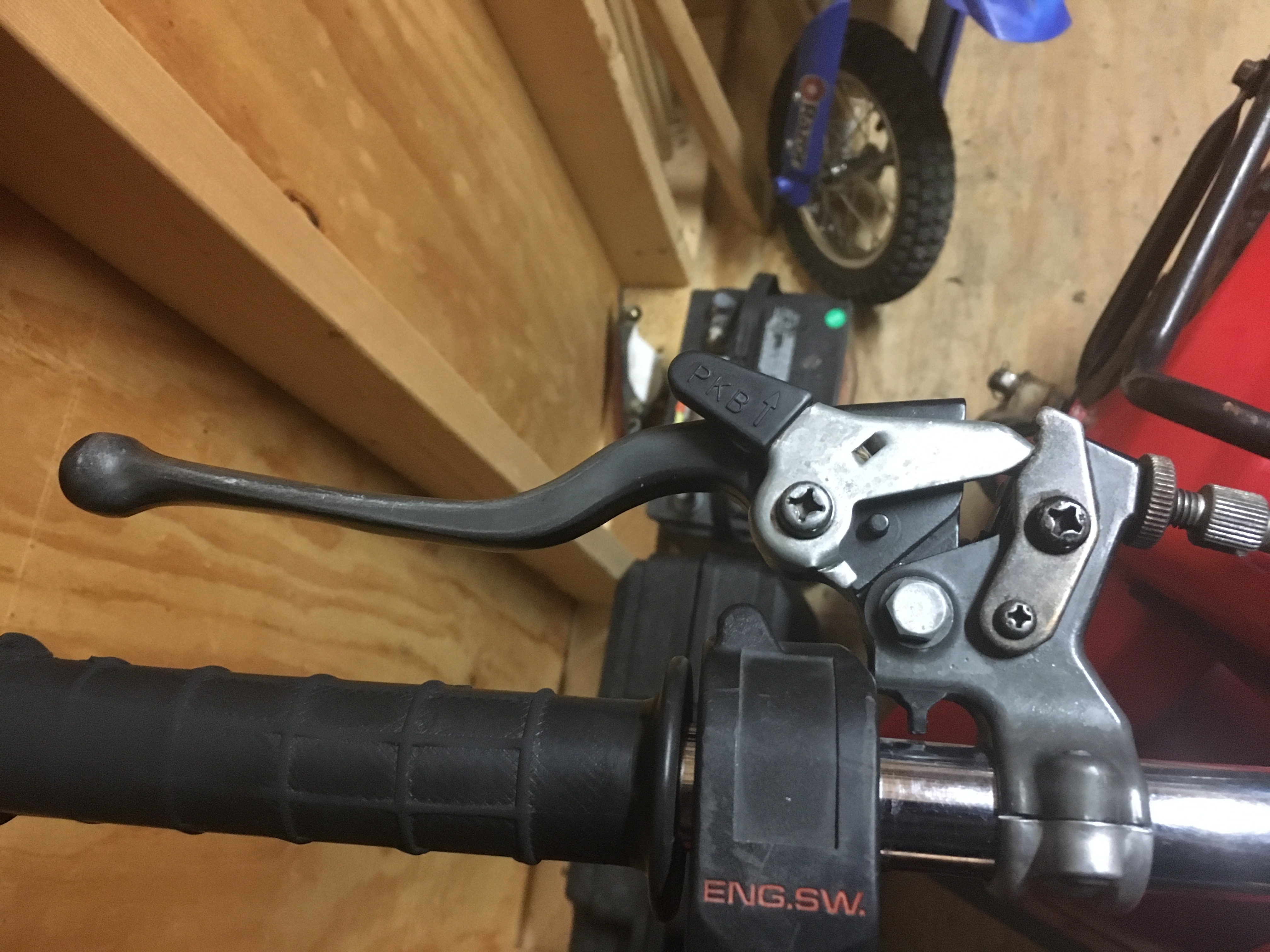

    Yea I'm in the middle of wiring a glo light brake/taillight, the rear hand lever was replaced and didn't have a parking brake lever on it. So after pointless searching I took a gamble and bought a Honda Rancher 400FA rear hand brake lever with perch for $11.25 with shipping off eBay. I had to tap the sleeve where the cable went with a 8mmX1.25 pitch tap and the old adjuster screw and lock nut now works perfectly. As a bonus it already had a brake light pressure switch built into the Rancher lever. So I'll post some more pics this weekend!

    Here's the Rancher 400FA rear brake lever

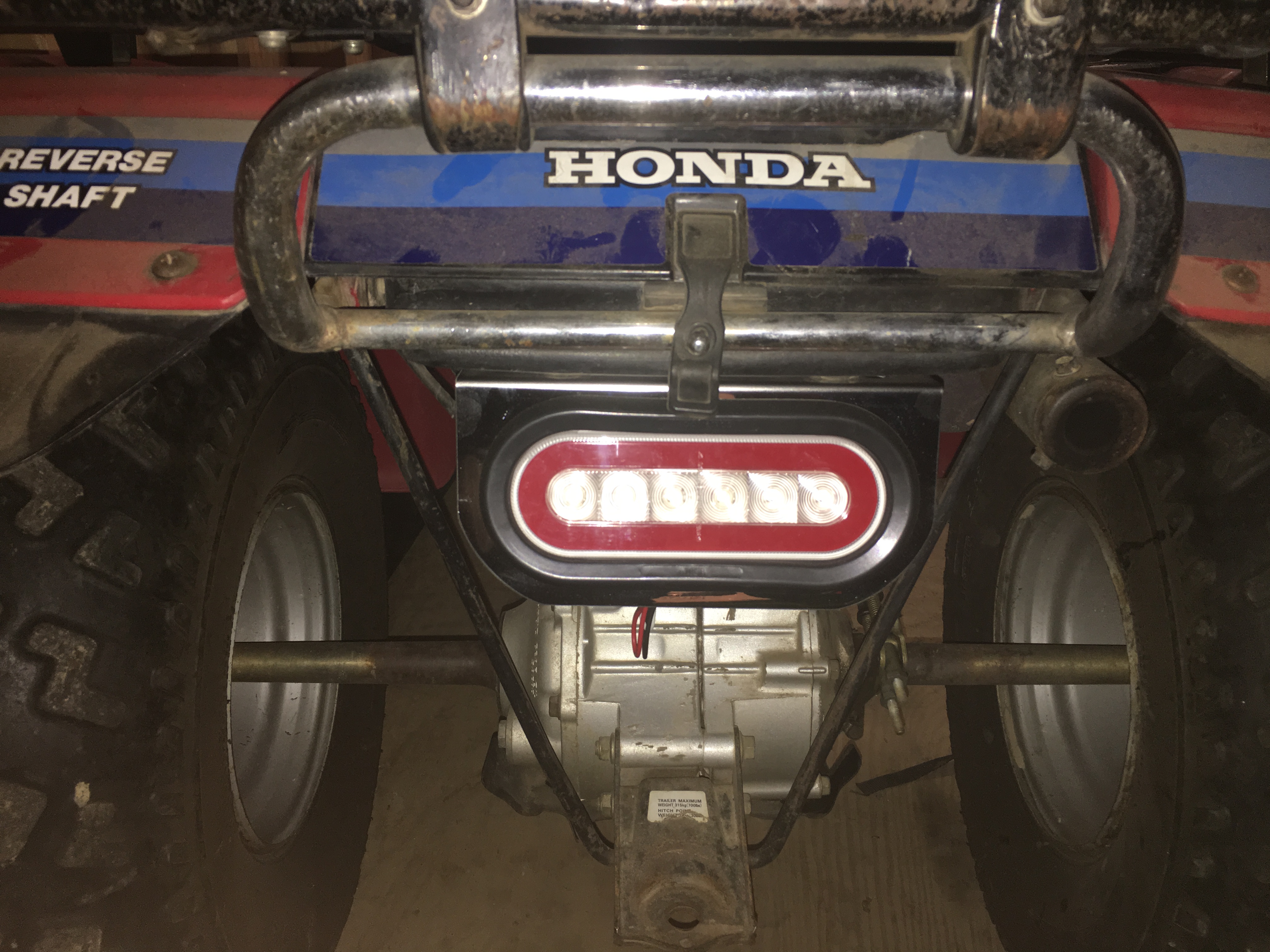

    And the new taillight and stainless steel mount

    Light looks great, and nice output. Is it a direct fit and could you direct me to where you purchased it.
    also, Did you add the capacitor and rectifier to your lighting circuit?

    No did not add a rectifier or capacitor, the 200es already has a factory taillight. I bought the taillight and bracket from Amazon.com. It's a 6" oval stainless bracket and 6" oval Glo Light. The taillight is also a brake light comes with the rubber grommet and 3 wire pigtail. All for $31 or $32. I replaced the brunt out fuse under the seat for the front 12v dc outlet and spliced into that wire for the power for the brake light. The Rancher 400FA brake lever I swapped to has a built in pressure switch. I did have to drill two 5/16 holes in the bracket to match the holes through the tool box that held the factory light. Sorry that I'm repeating myself from previous post. Light is super bright.
