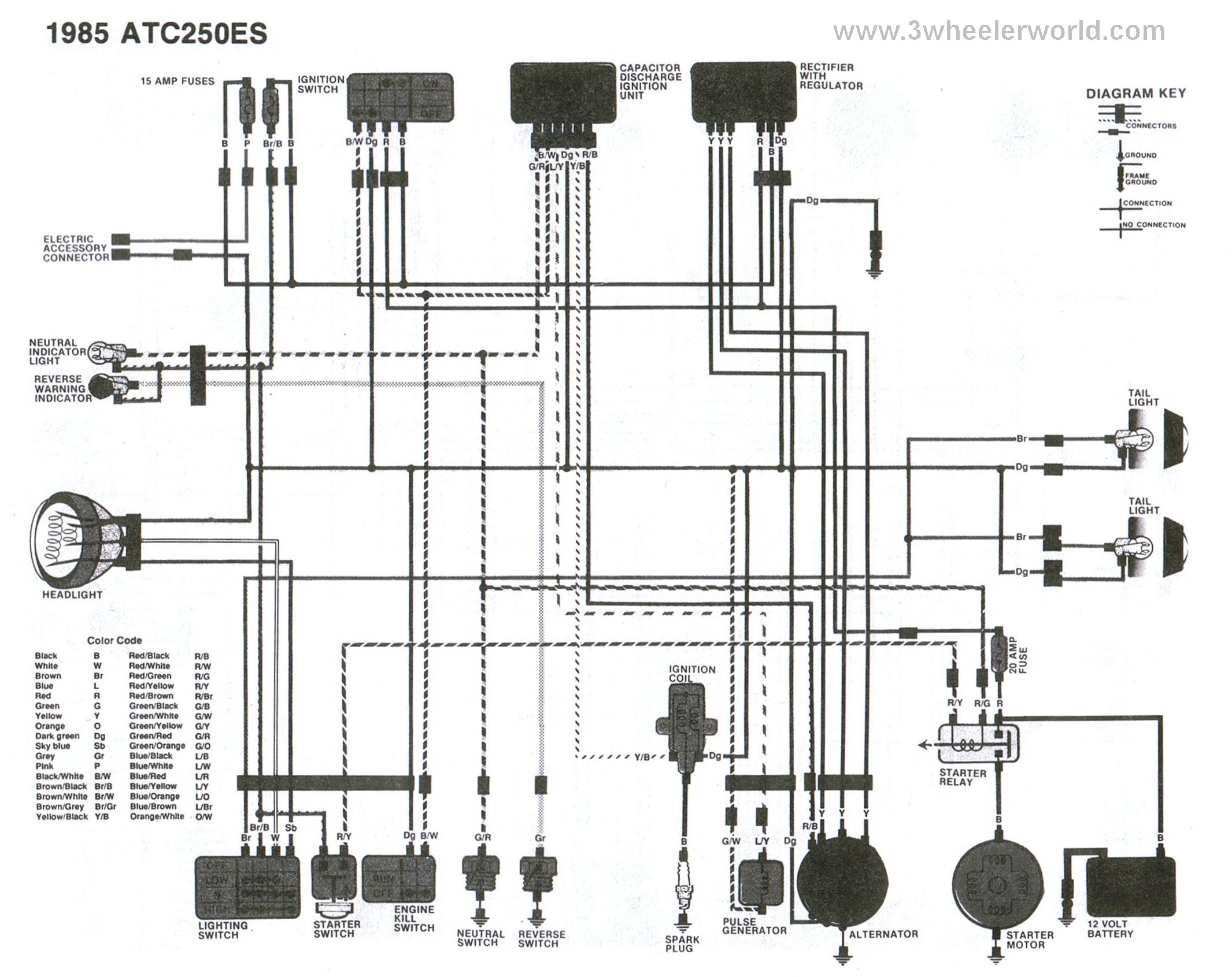

    Just started bringing a 1985 ATC 250es back to life and went to hook up the battery then turned key to on and started melting wires( green wire that goes to ignition and the red one that goes to ignition). Wondering if it could be old wires, the CDI or a bad starter solenoid?

    Sounds like wires are crossed. I'd inspect that red wire from the starter relay to ignition switch. Is there a fuse in the circuit? Here's a diagram Click image for larger version.
    Good luck, Adam and welcome aboard! If you find it, please let us know what the problem was. Thanks

    Well I've got a new CDI and ignition coil so I'll do one at a time and let u know what one works or if they work and yes I have that wirering diagram and have fallowed all the wires that melted and they are correct and all fuses on the thing are good still. Also kick starter does not grab unless u kick super slow. Is that a bad one way bearing?
