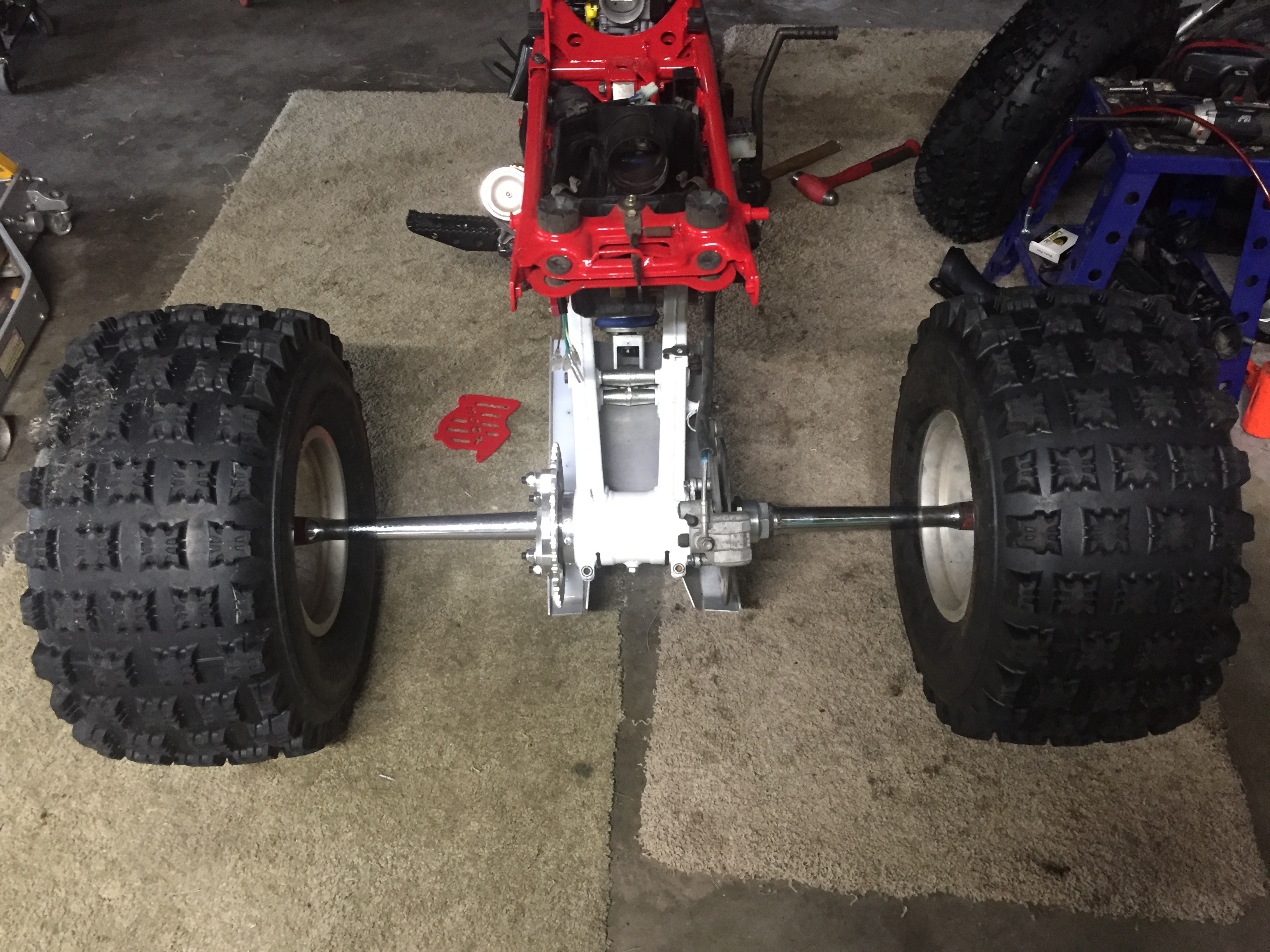

    300ex axle swap with adaptor
    This has taken much longer than anticipated. I decided to pretty much redo the entire trike. Many new upgrades including a new take out motor, frame gusset and powder coat, inverted forks and much more. I will post up the build in Trikesylvania when it is finished.
    First off the axle I went with is a niche brand. Do NOT buy one. I cheeped out and paid $112 shipped. It is an adjustable extended. The sprocket hub splines are way different than the stock. I had to end up buying the Durablue brand with different spline count. I argued with the company the splines were not stock. They argued back, still holding solid on the splines being oem. I just hope the axle holds up. Worst case scenario is I buy a used oem.
    I am running stock 400ex hubs although I purchased the tusk extended hubs. They are pretty sweet but I am thinking I went overboard on the width. Good for open sand but too wide for trail riding.

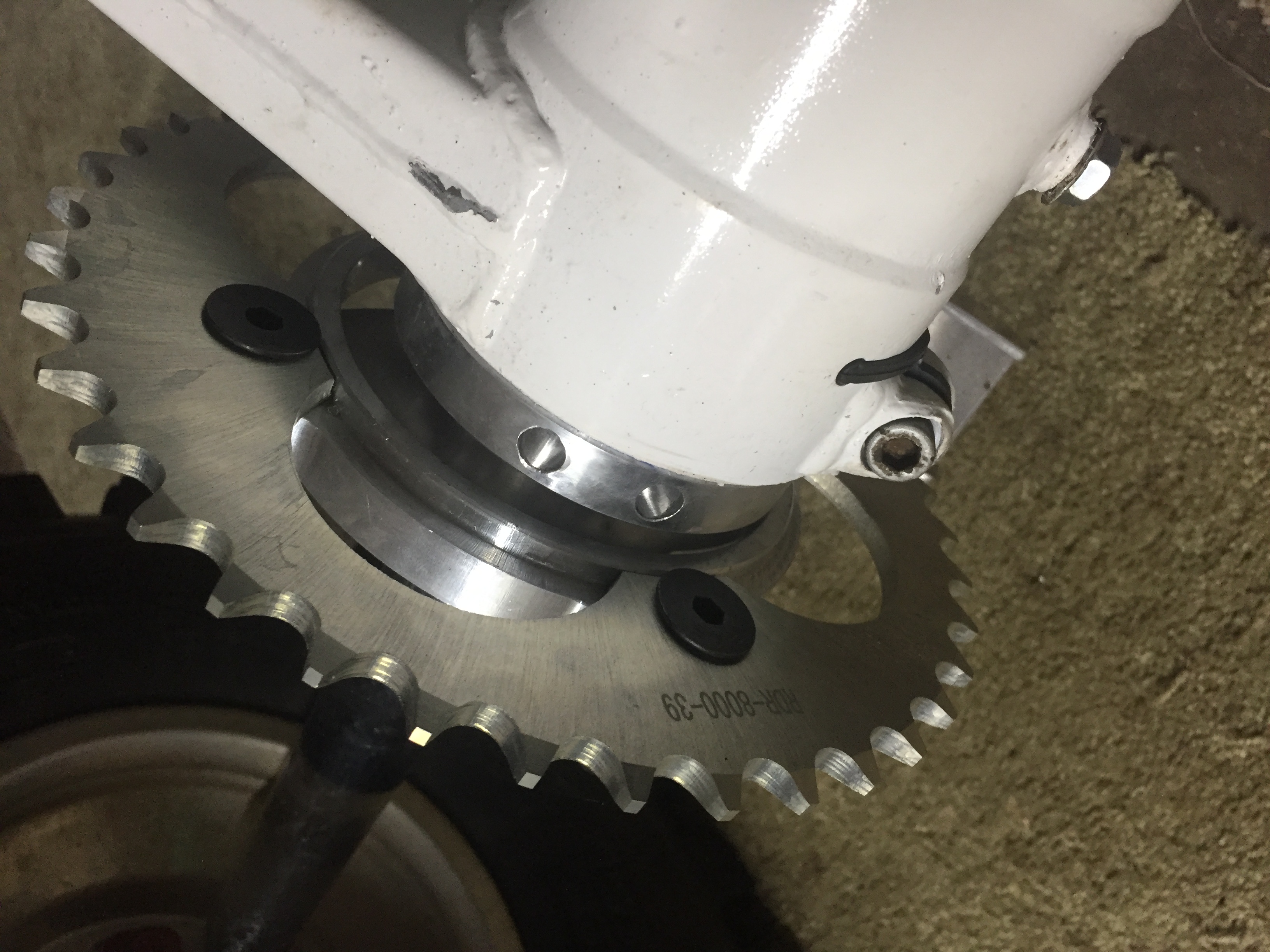

    The carrier is a new 300ex. I didn’t take any pics of the sprocket adaptor before I installed it but hopefully you can see it in the pics. I purchased that off Louise Mielke here on 3ww. Its a very nice piece. Running a 39 tooth rear sprocket. That may change but I will start there.
    The rear swing arm is my stock 85 arm extended 2”. That should be very helpful from what I have heard. In the picture I have my oem stock rear shock mounted. I dropped off another oem to be rebuilt at my buddy Drew’s shop, Maultech ATV. It is ready but I have not had a chance to pick it up yet.
    I am itching to get it completed and take it on a good ride. I will report back on how the rear axle set up actually works.

    Sorry to hear about the Niche axle. I saw those on eBay and wondered what the quality would be like. Others use their carriers and give good reviews so maybe outside the spline issue, the axle holds up fine (fingers crossed!)
    Looking nice and digging that 2" extended swing arm!
