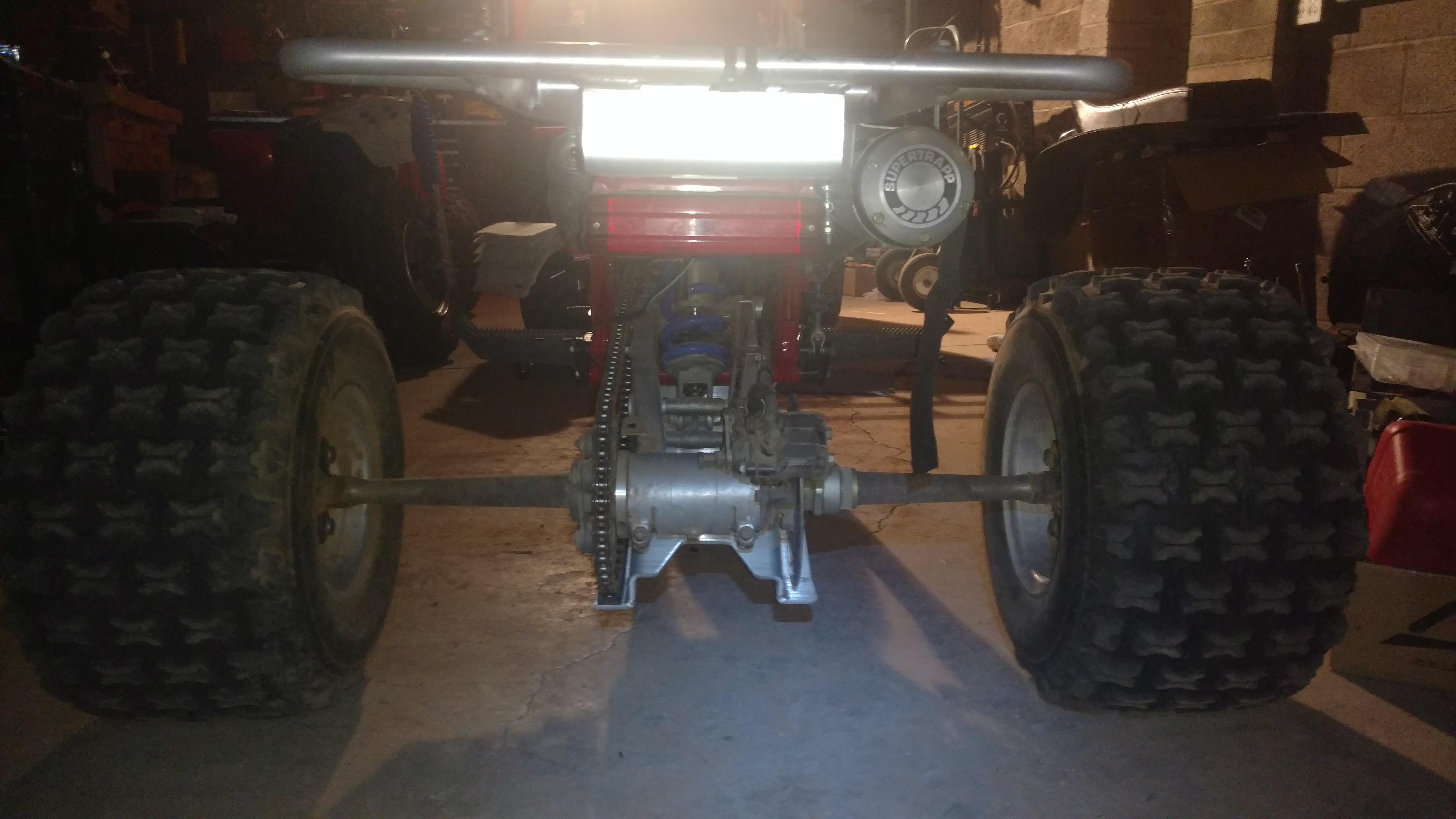

    Must be two generations of racks or are these different models as one has the mount and one doesn't so maybe that's why I never noticed.
    Moved the light last night.
