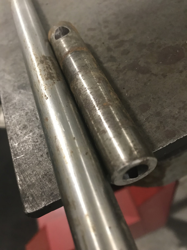

    Simple project, screw cl, gonna keep it!
    I have this combo vac/sandblaster. Typical snapon-
    Pricy. I think I paid a few $ years ago. Works well. Put it up on cl for the same $ and about 20 emails
    Of no-show “buyers” and and some offers for 100 or less (new they are 2200)= I will just keep it!
    Anyway, nozzle was starting to wear. The gun is easy to rebuild, just washers and o-rings when needed. Time for a tighter nozzle to improve speed
    Worn nozzle and some stock
    1/4” through-hole
    5/16” suction hole at 30deg and done
    Much faster now, great for flat panel work. No dropcloth needed and can use in the garage without mess

    More efficient = save time
    Paint removal was slowing down
