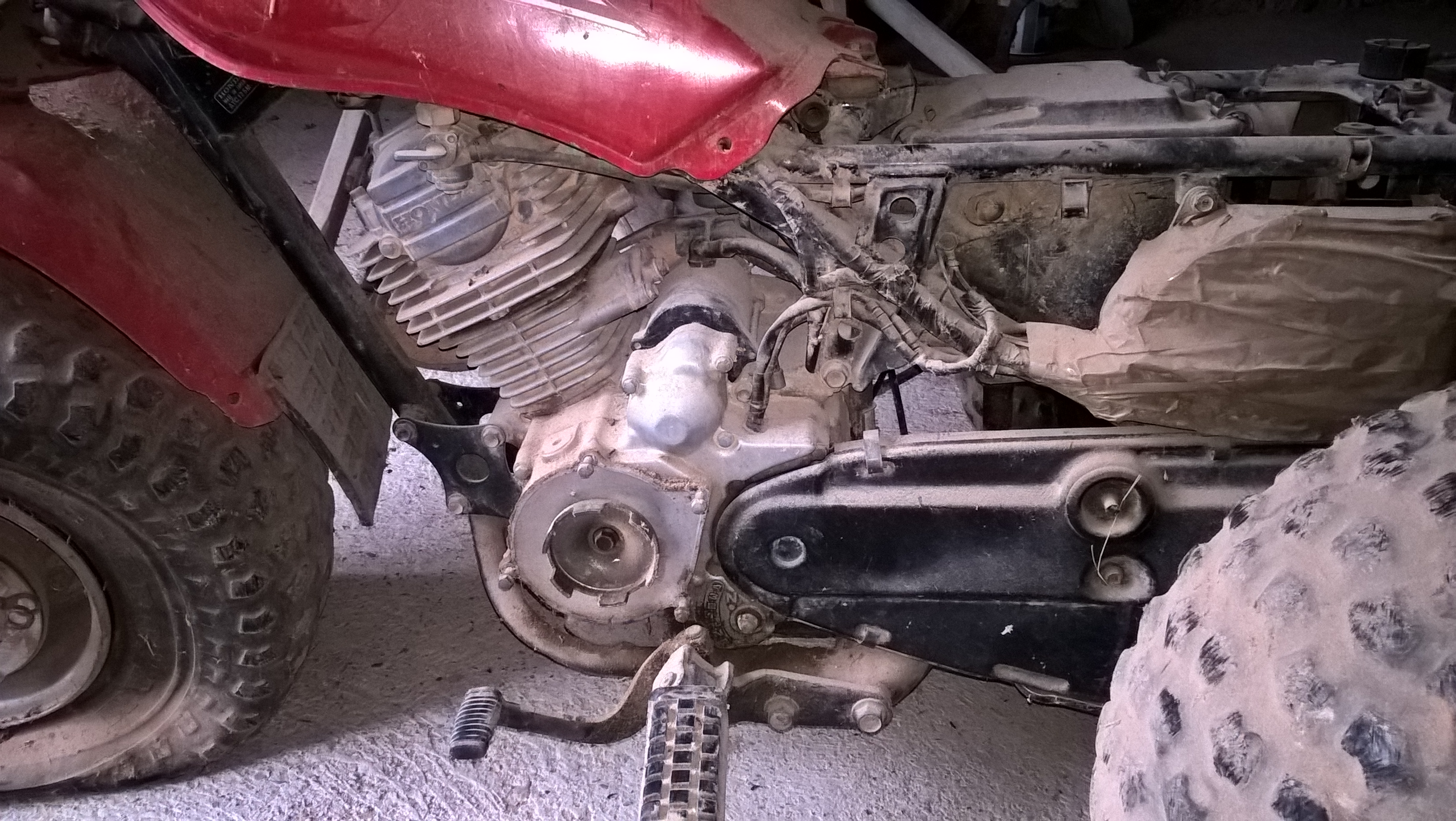

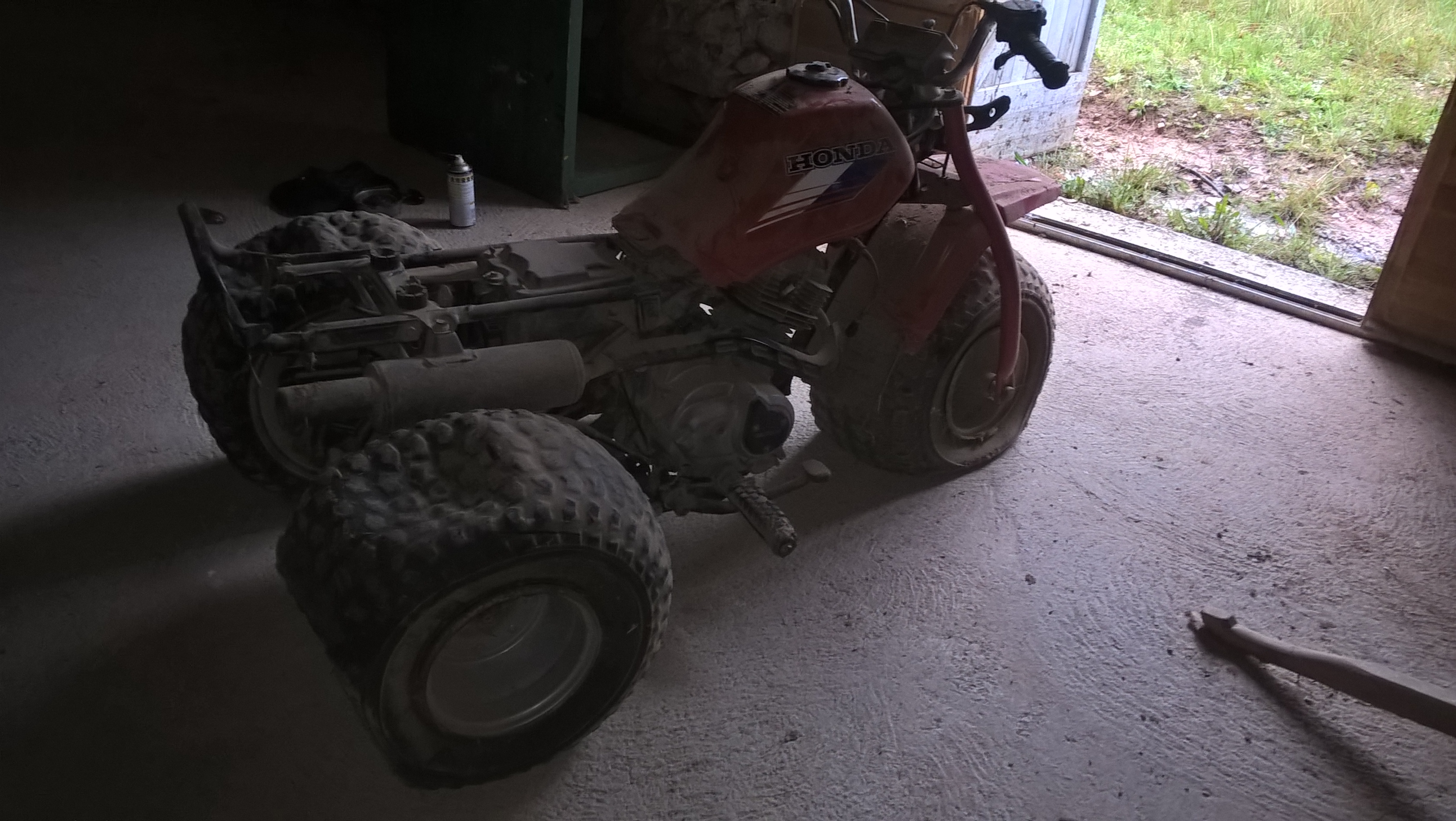

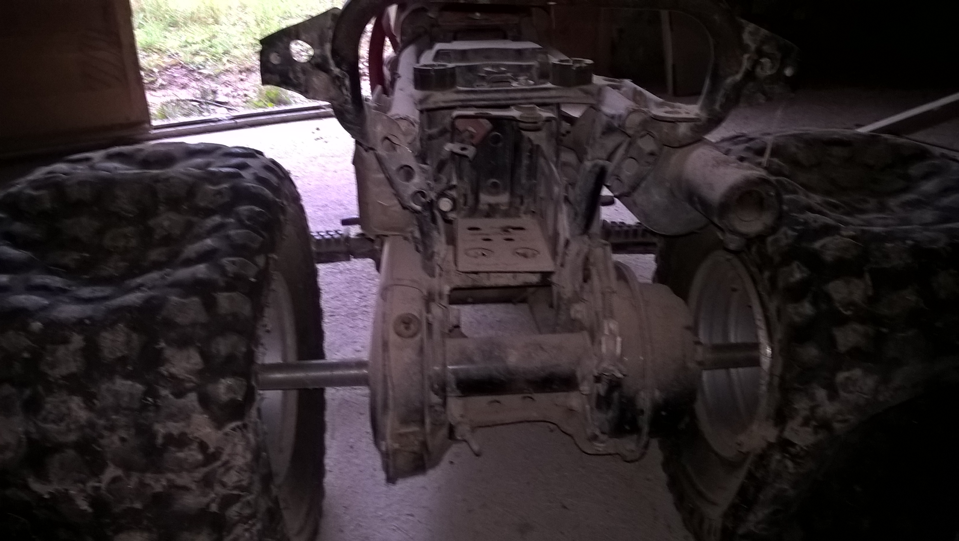

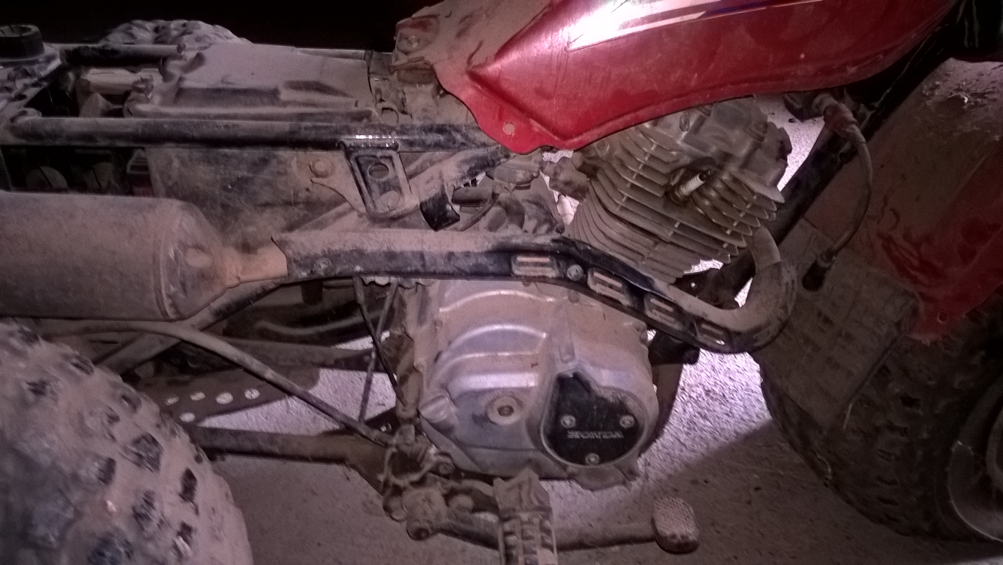

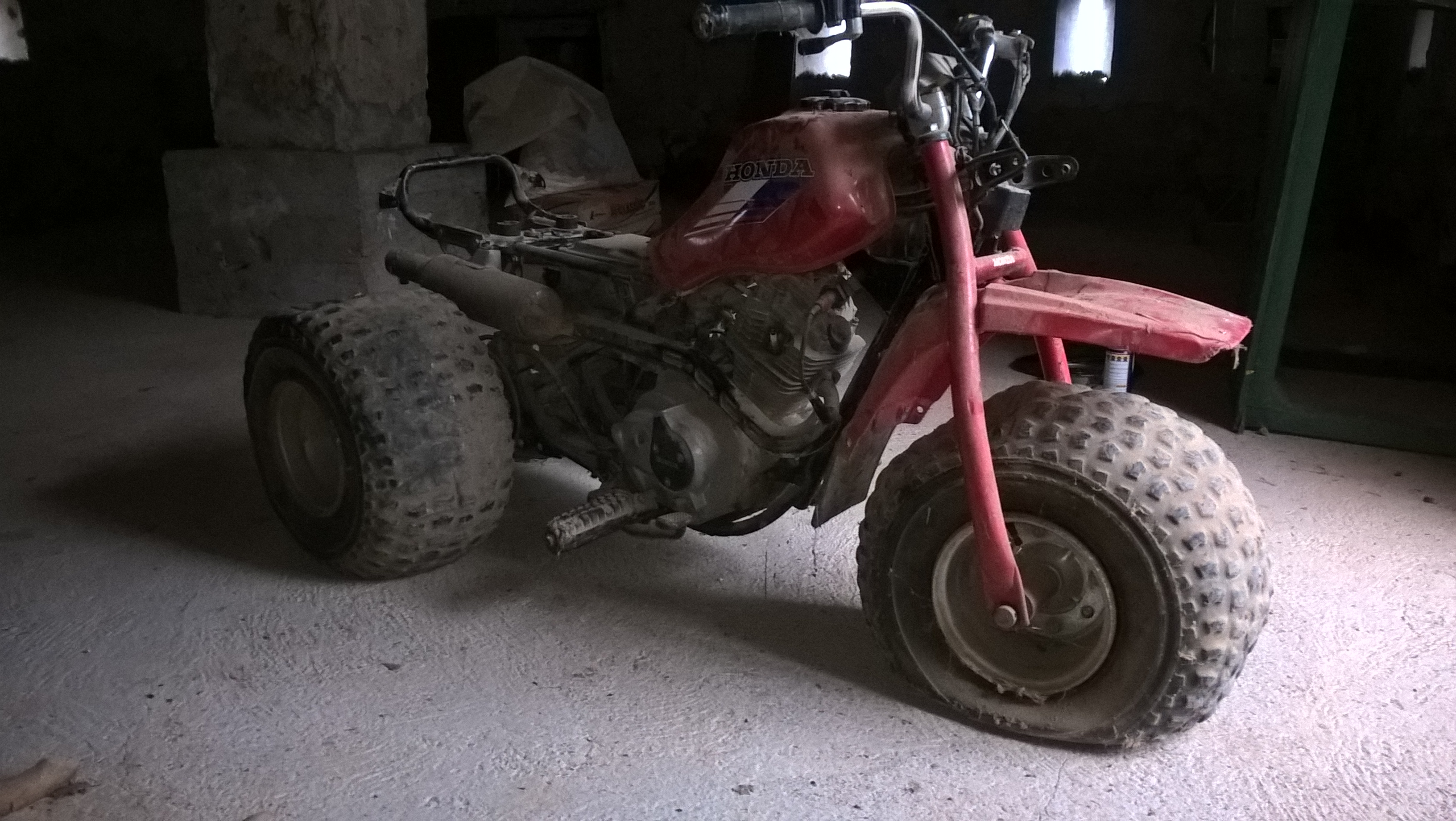

    Hey there,

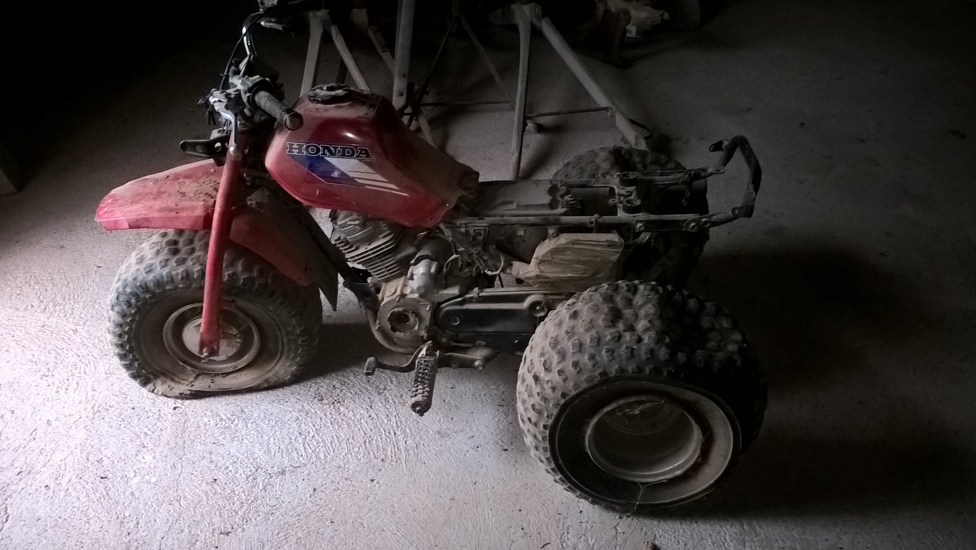

    More photo and informations about my 1986 ATC 125M I started to restore.
    This ATC was stored in 1997 and never used since that. Motor was locked and recoil starter was broken and first thing I did is to repair it (this is why it's not on the photos below).
    To days ago I managed to repair the recoil starter (2 hours to put this f**ing spring in place ) and even managed to unlock the motor with the help of the mighty WD-40. With a good spark at plug the motor even started when putting gasoline directly in the carburetor float chamber, but it looks like the carburetor jets are clogged. Next task is to remove the carburetor and clean it.

    That looks like quite the uphill battle putting that one back in service. Good luck!

    Since you said that it started, I bet that it's not in very bad shape.
    The Open Road
    4,736
    That looks to be in pretty good shape, in my opinion. I bet if you wash off the dust, it will look alot nicer. I don't see any dents or meaningful scratches or rust. Looks like a great investment. That year of 125M is a rare sight so I think it's worth the effort.

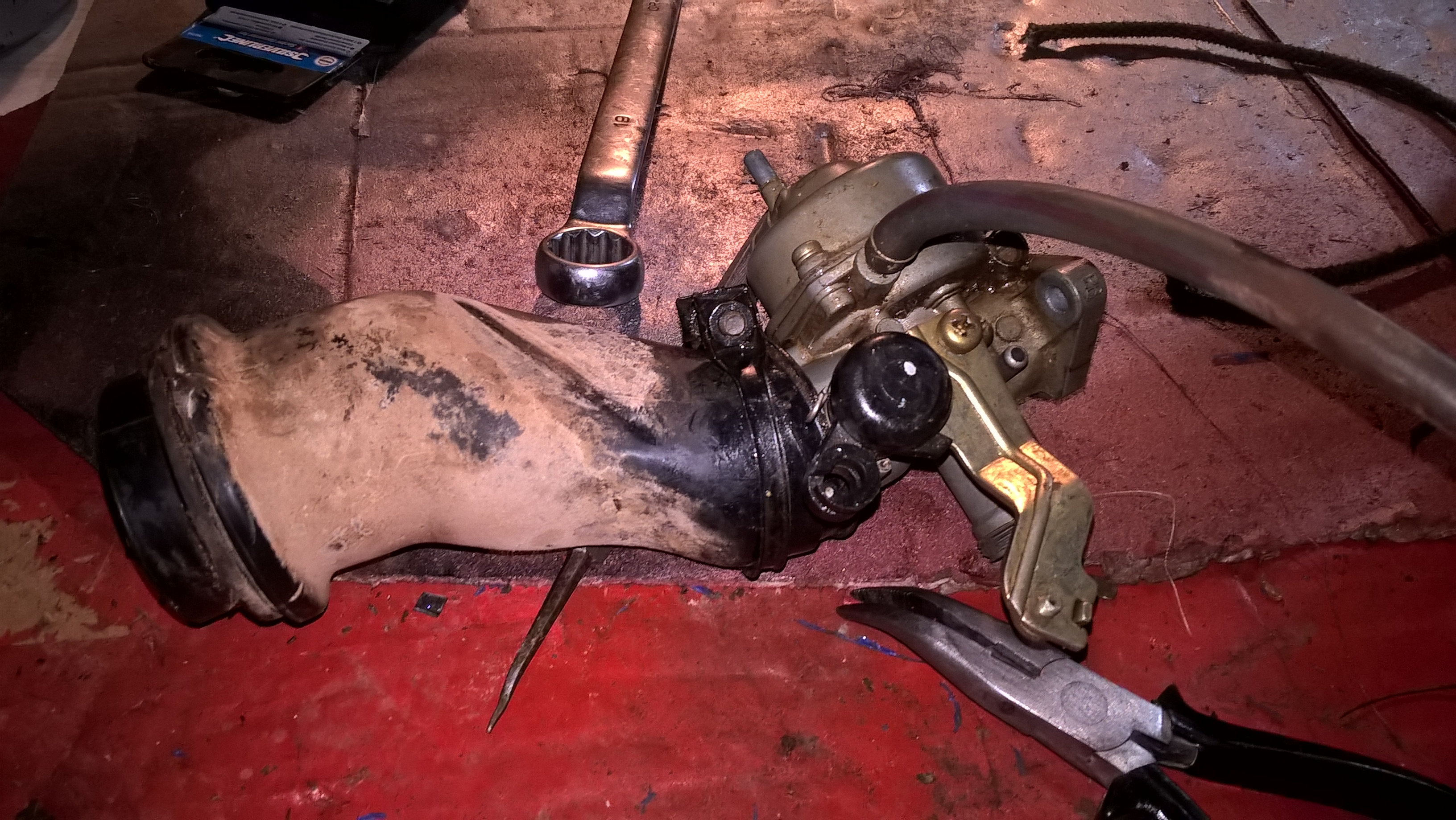

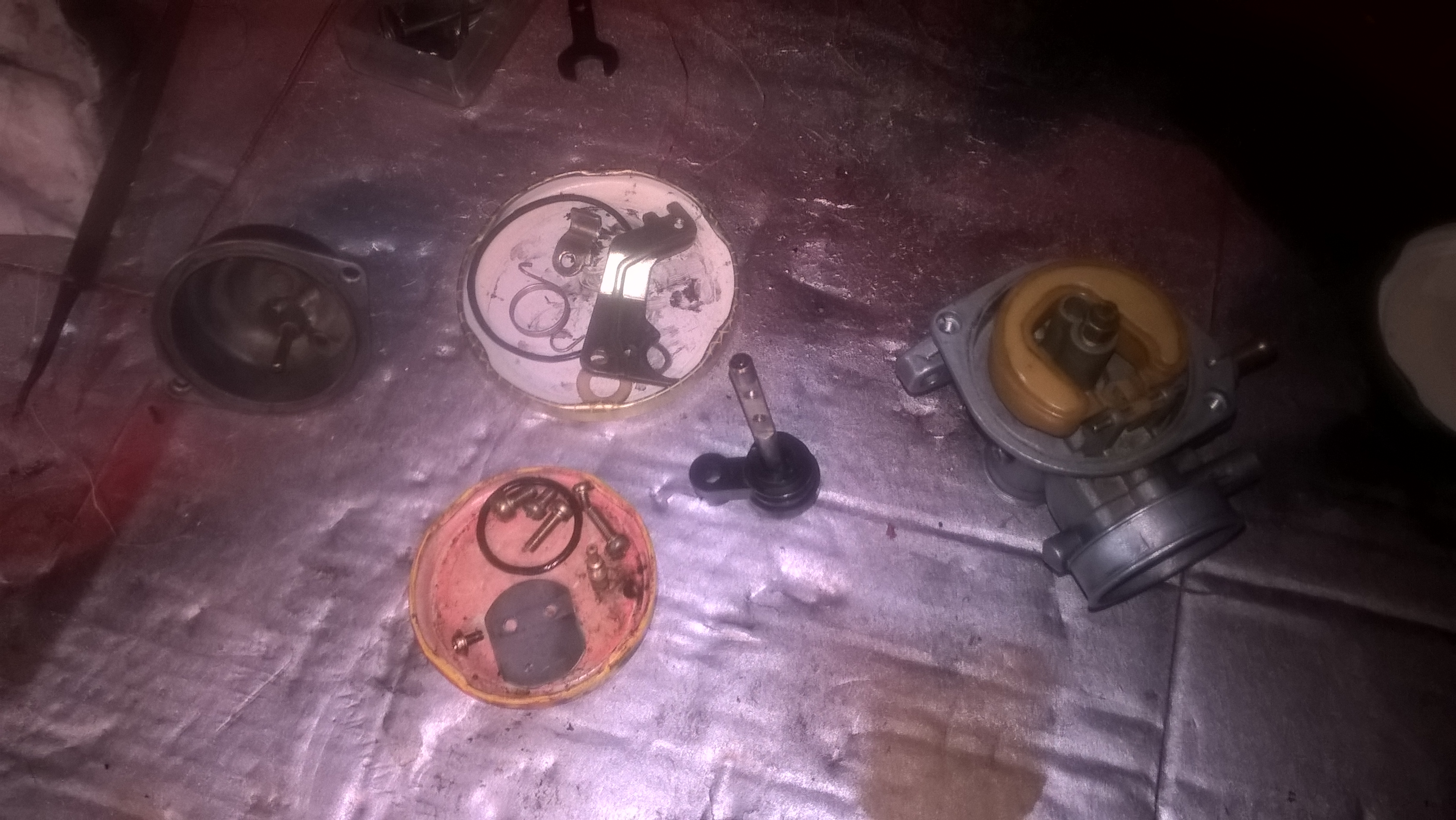

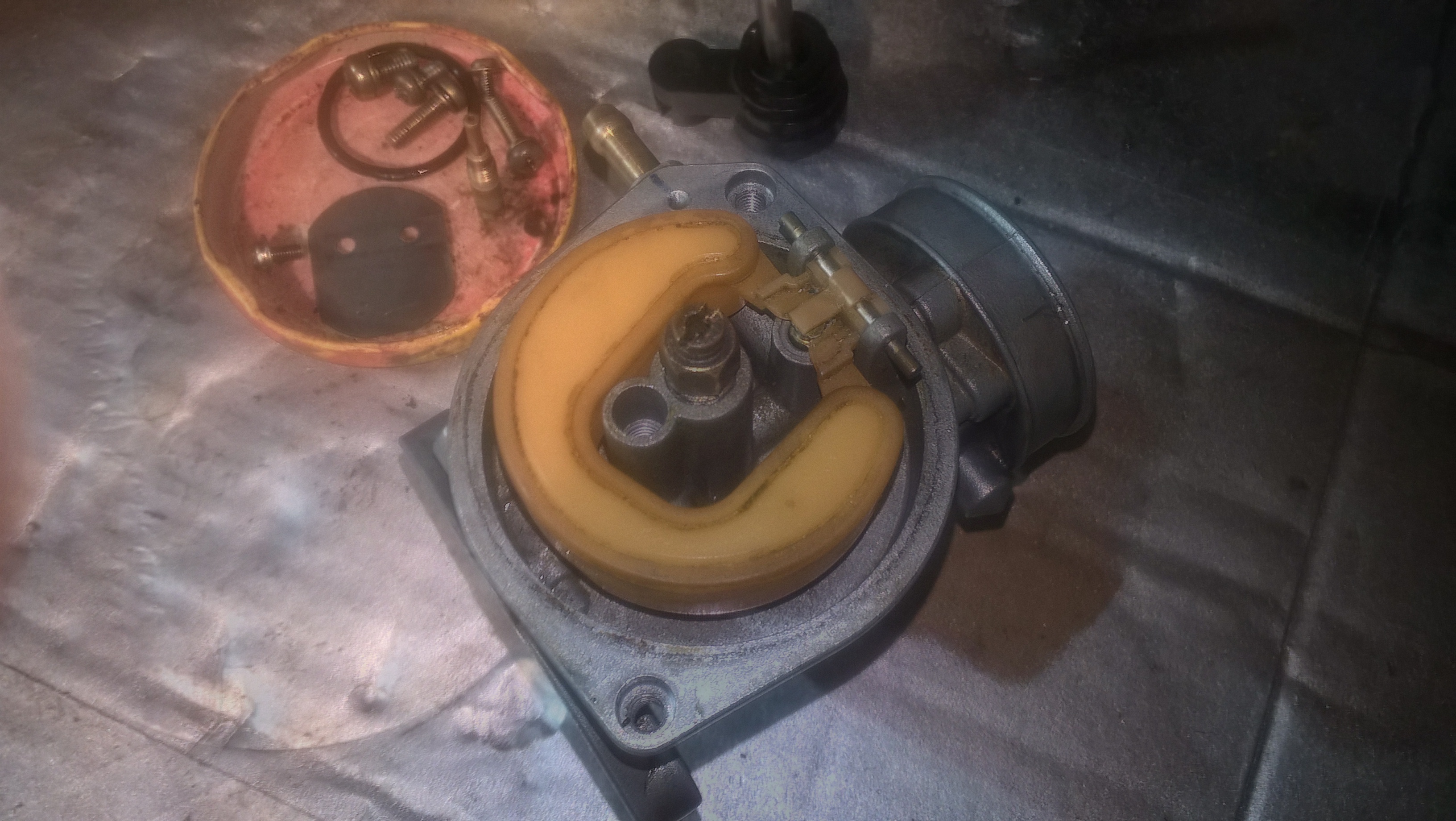

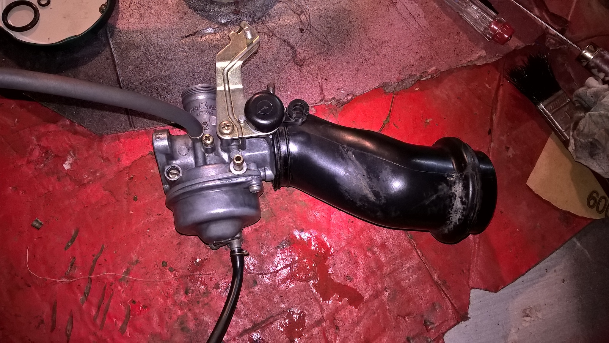

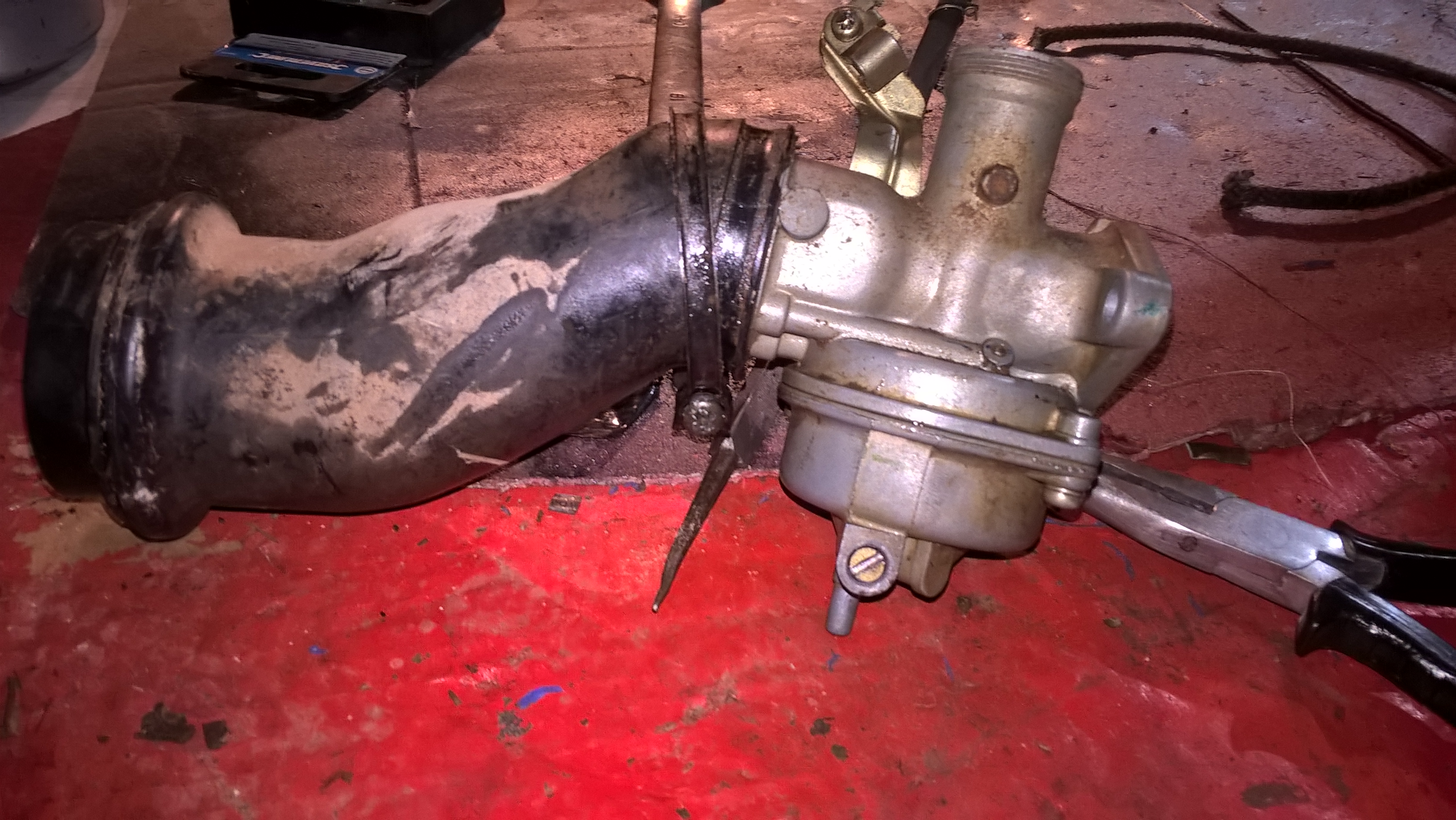

    About the current task of cleaning the carburetor I'm stuck to unclog the clogged slow jet. Did somebody know a 'I-have-used-this-trick-several-times-and-it-works' to clean it ?
    Edit: carb pics

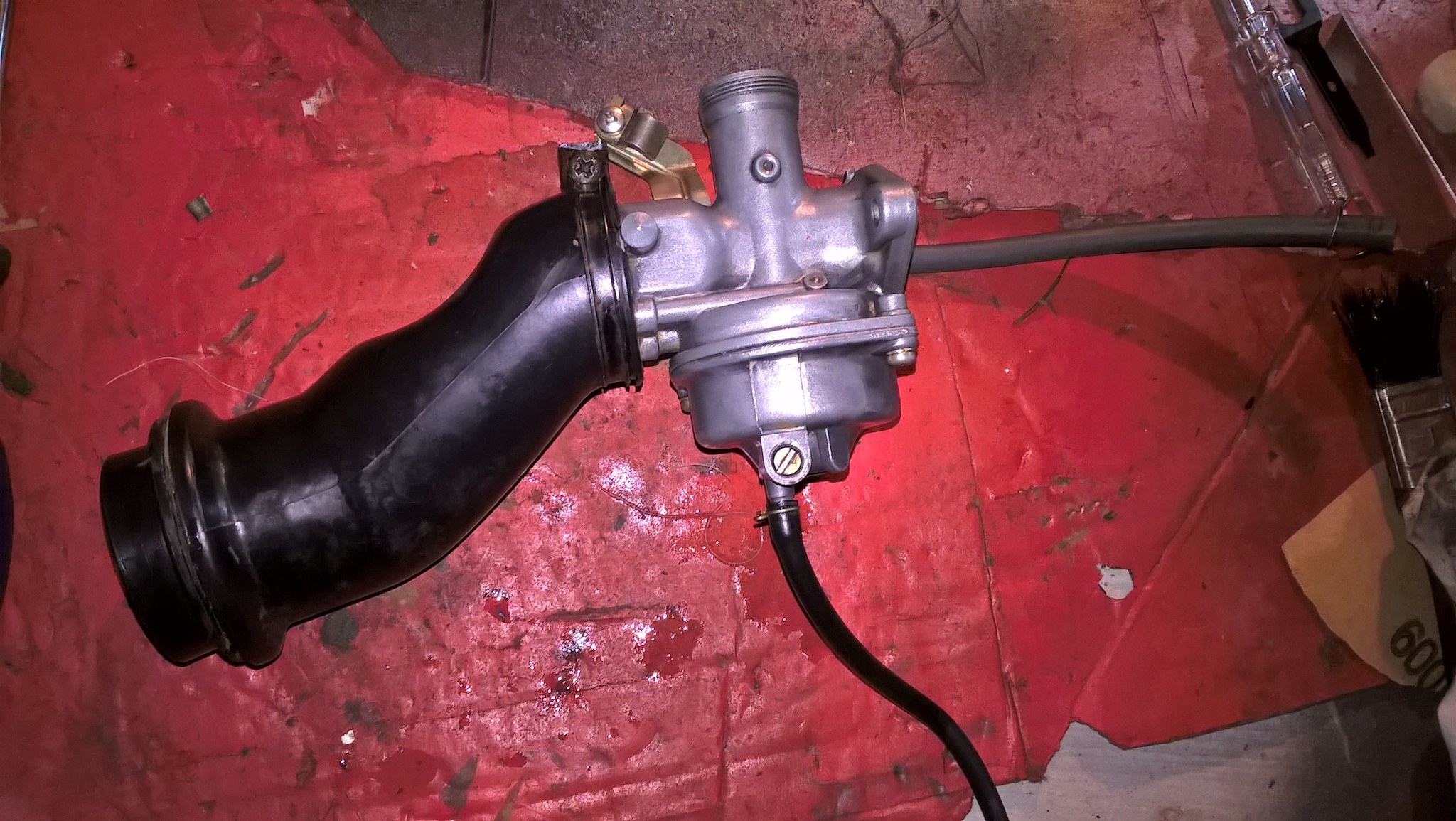

    Ok guys I managed to clean that jet with acetone and reassembled the carb.

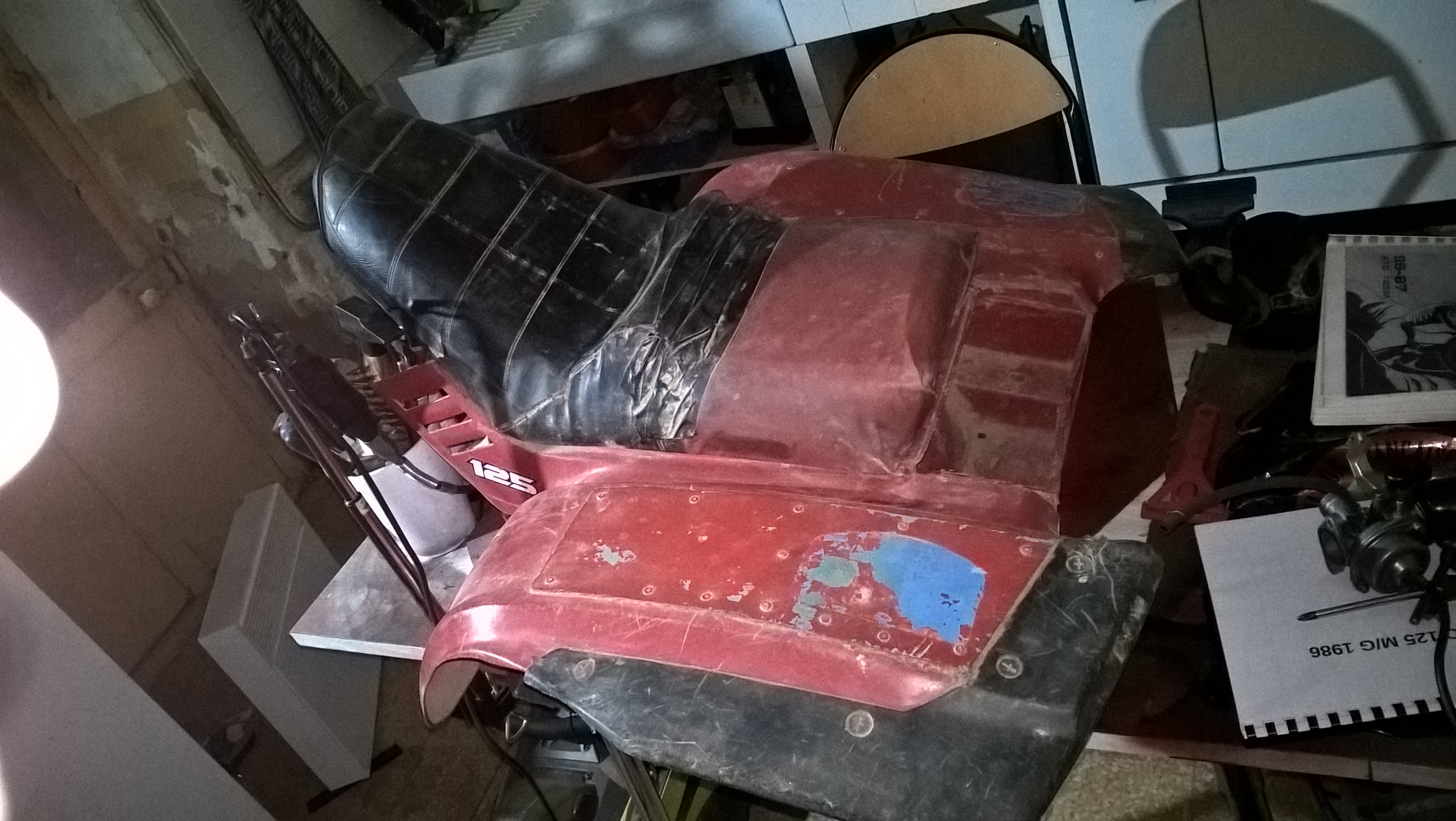

    The rear fender and the modified seat :

    It looks like there's lot of work

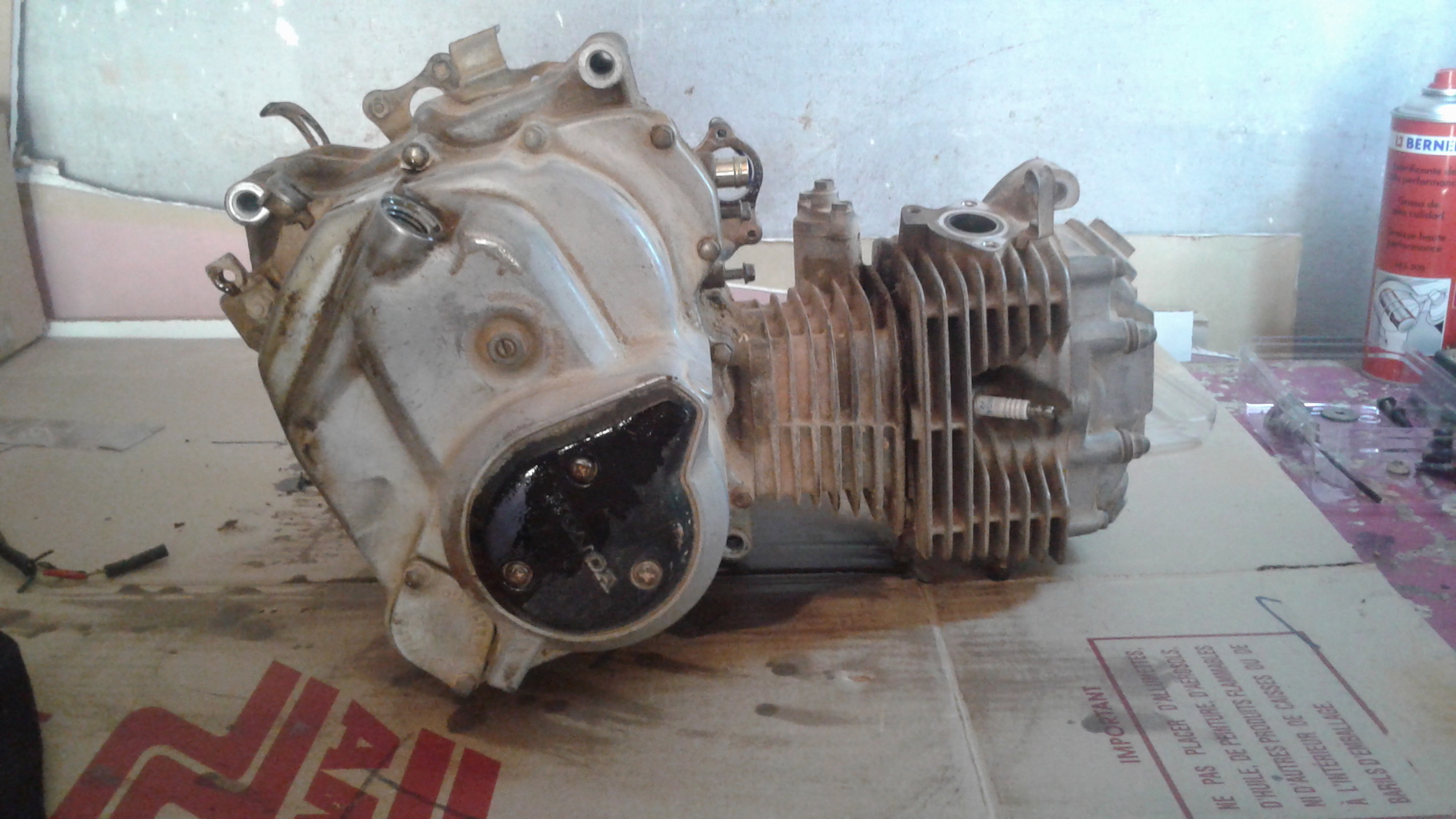

    And now on the operating table :
ID:	243452 Click image for larger version.
    The electric part is a real mess

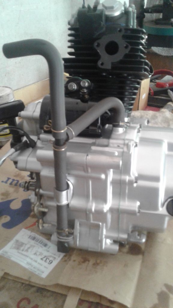

    Some updates.

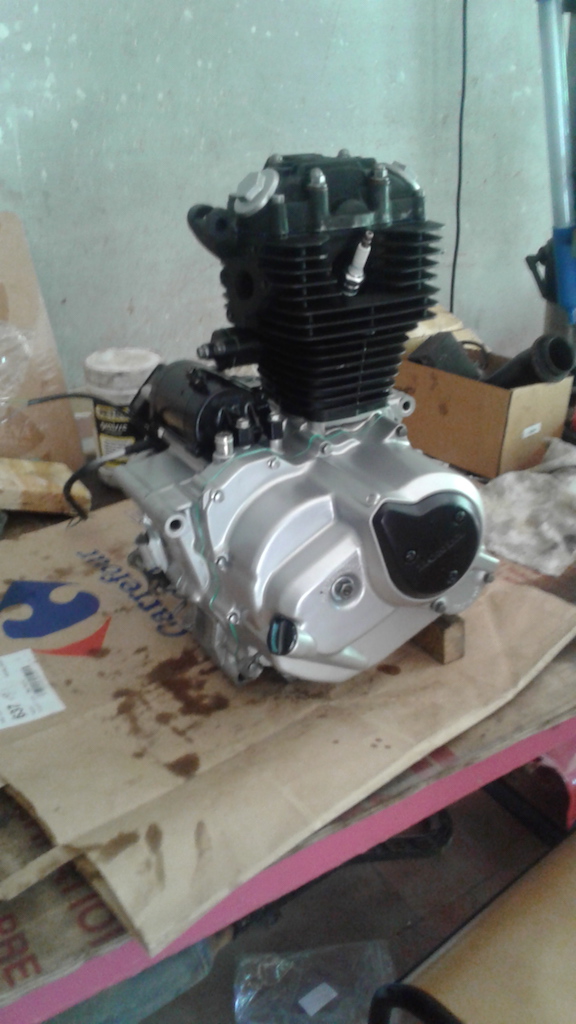

    Currently rebuilding the motor.

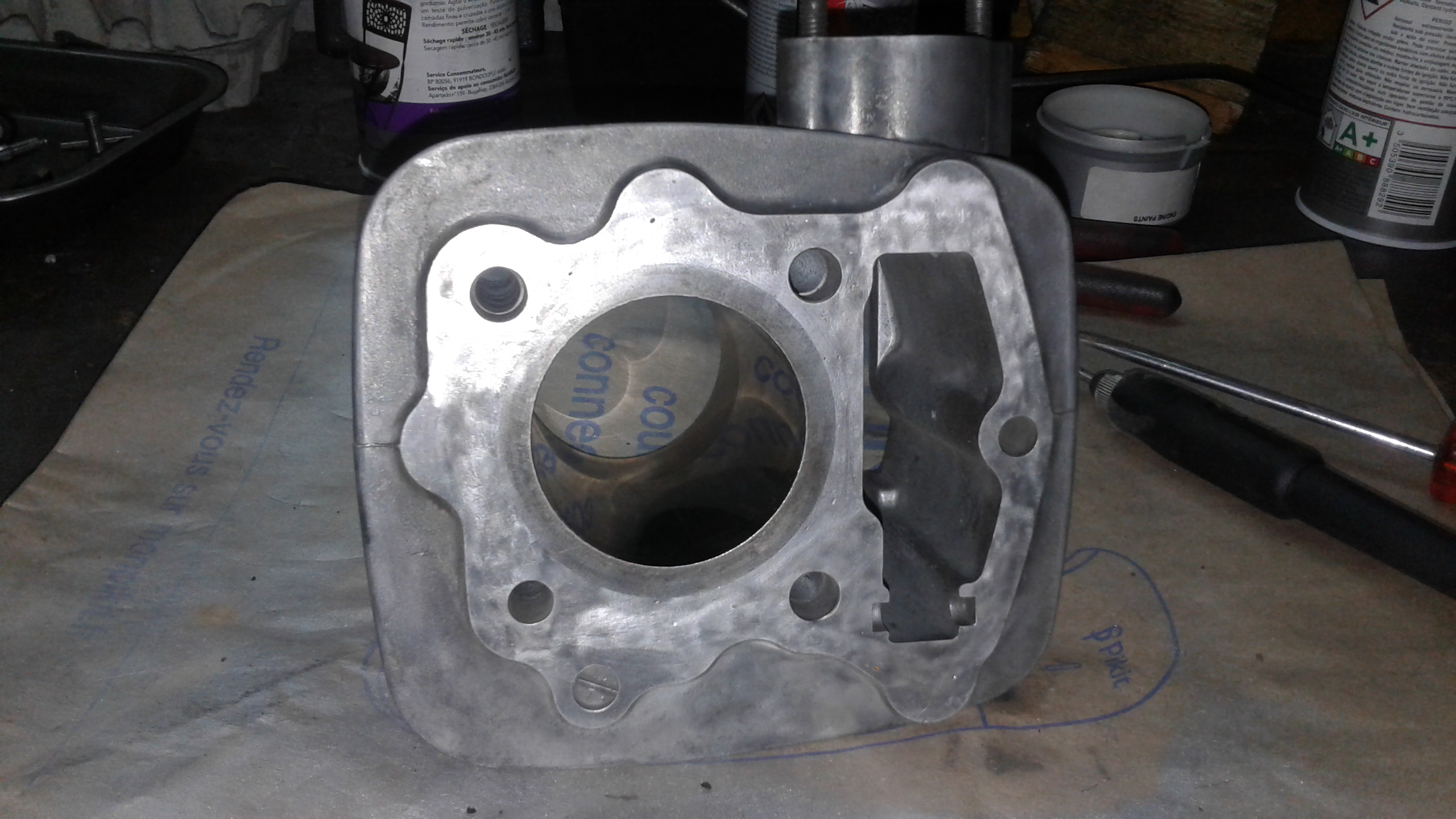

    "New" cylinder from a TRX 125 :

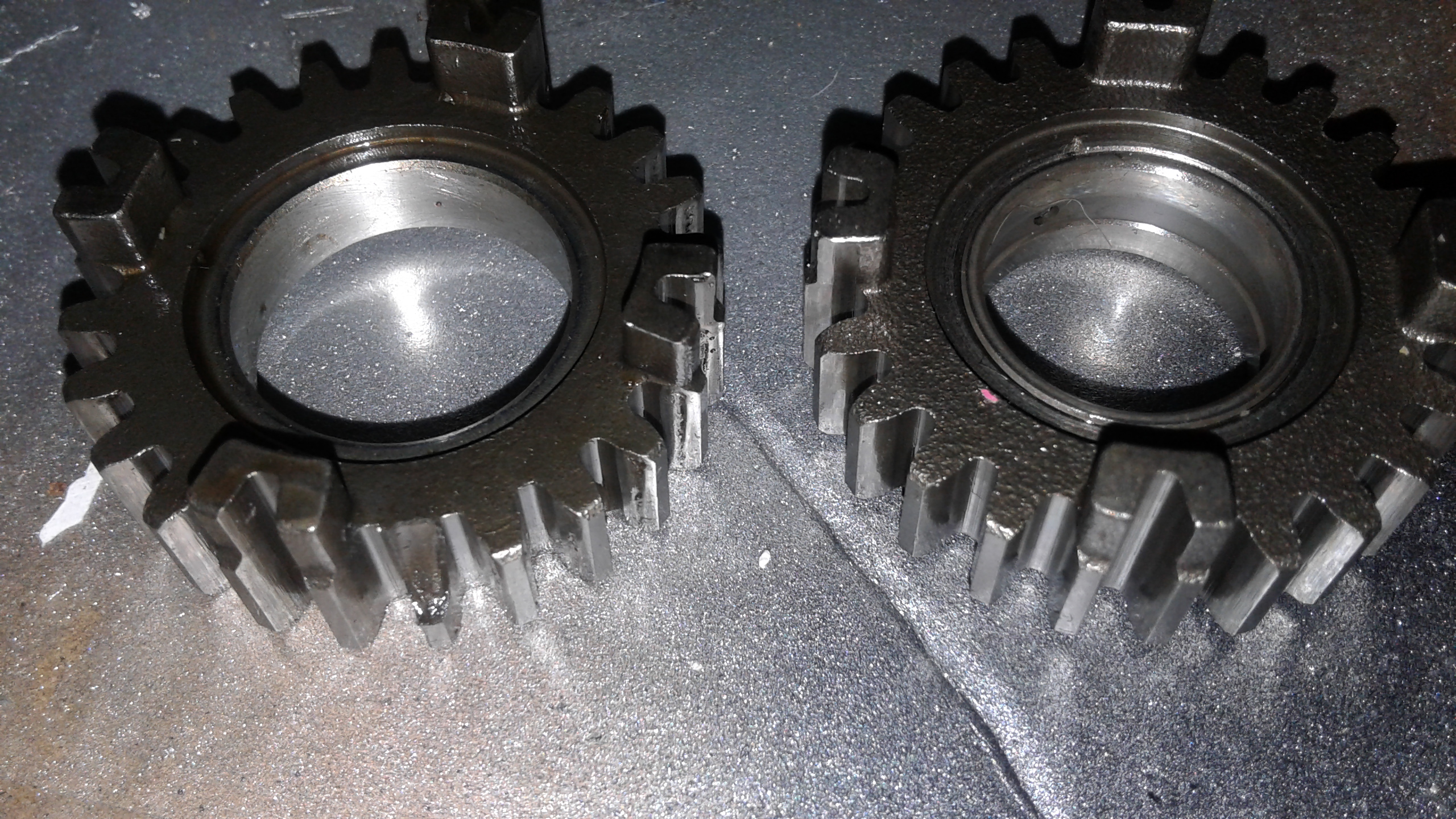

    A "new" 4th gear to replace the original one with a broken teeth :
