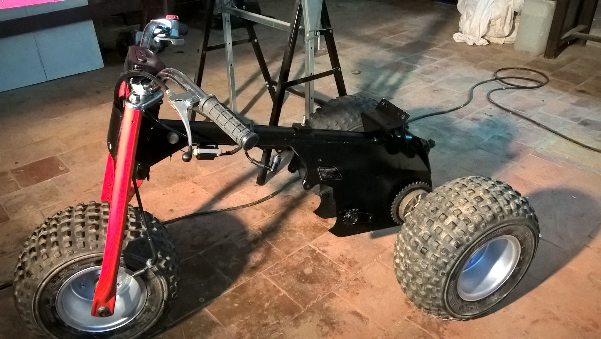

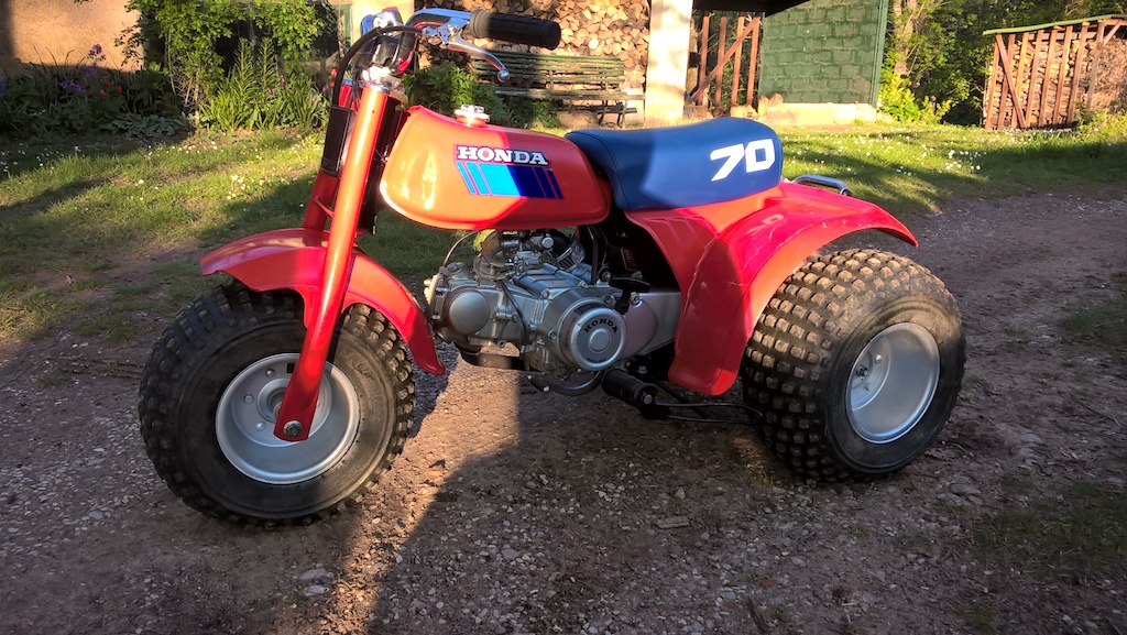

    This is some pictures of the 1986 (1985 model) Honda ATC 70 that I am currently restoring.
    I ride this little thing A LOT when I was young (and after ), during 25 years, and it was stored during 5 years after a first attempt at restoration (new house, new kid, and suddently my free time disappeared ). It really needed some love
    Note : this is my first restoration project, and I did not try to restore it to look like 'stock'. I just want it to be clean and well running.
    The restoration is completed at 95% and I just wait patiently for it to stop raining to try the ATC outside . At the end of this afternoon if i'm lucky
    The photos are in chronological order and there is no pictures of the work on the motor, clutch and carburetor :

    At last I finally ride it but not too much : it need a lot of work on the ignition/carb settings, I did wrong in the garage.

    Looking good Henri. It appears that your front fender is quite close to your cylider head nuts, or is it just the picture angle? These things do have an issue with bent frames which is very easy to fix if it is.
    Yes it seems that this is a problem of this kind. Do you have any tips on how to fix it ?

    You bet my friend, check this post starting at #11.
    http://www.3wheelerworld.com/showthr...t=atc+70+frame

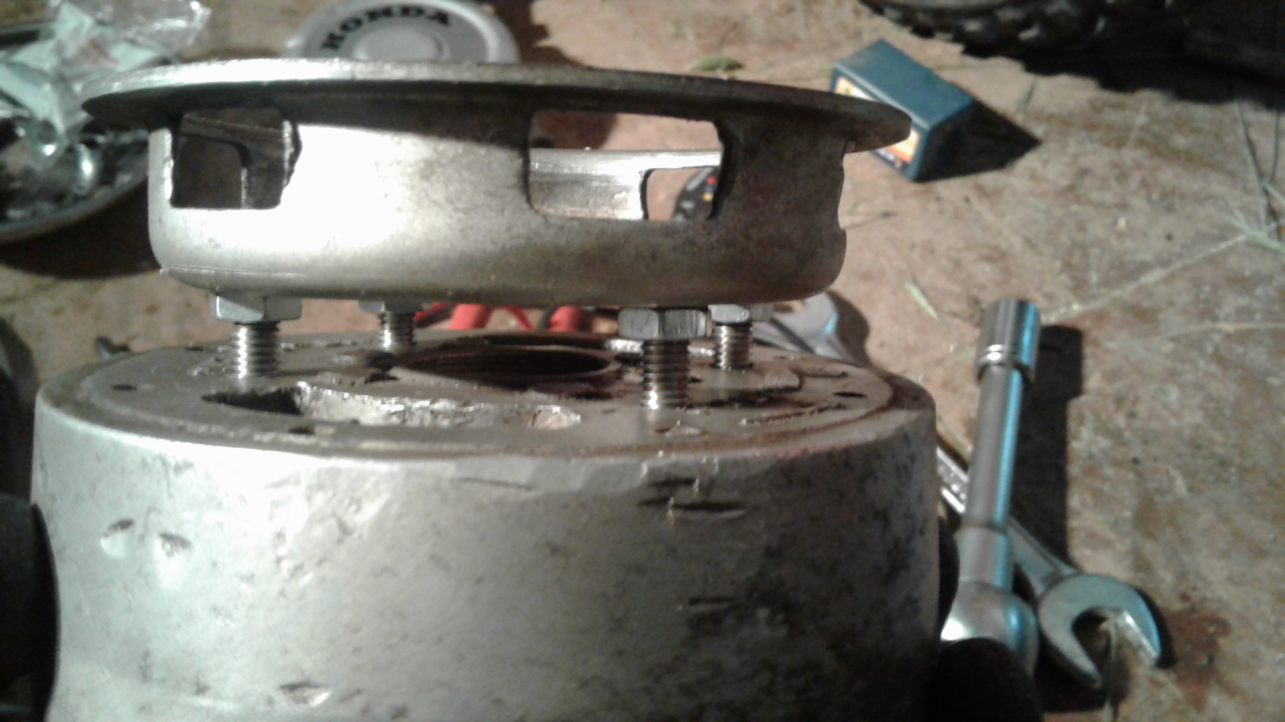

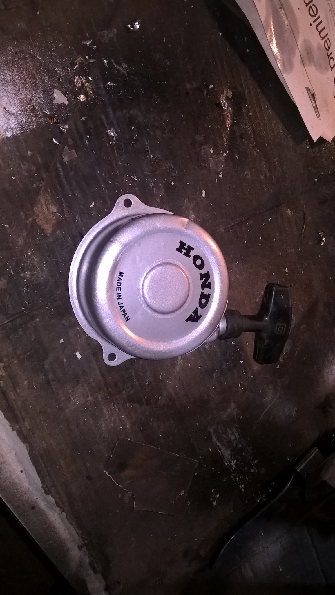

    A lot of work since the CT70 crankshaft is different : the axle is shorter.
    I had to use and modify the CT70 flywheel (Hitachi) for the pull start :
    And I also had to swap the stator plates since the point support is wider, and I had to put a woodruff key with 10° advance.

    I finally took the time to do this frame stuff :
