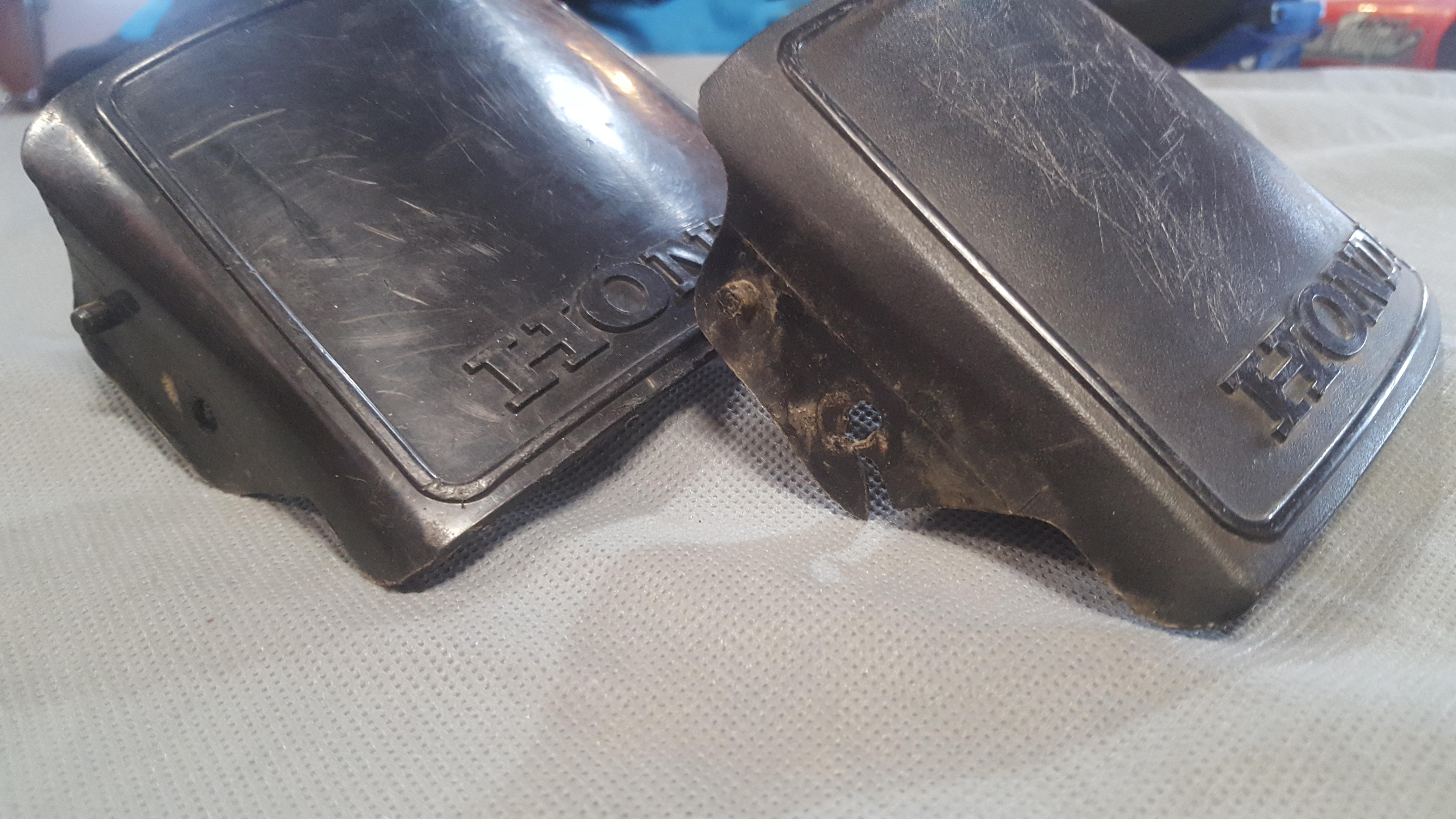

    It requires a replacement plastic Honda sign that fits on the front forks - the black square one - I've spent ages searching for one, but without an actual name in having no luck

    Ive got a few number plates. Pm me if you want one.

    I have two. Couldn't send pictures through pm
