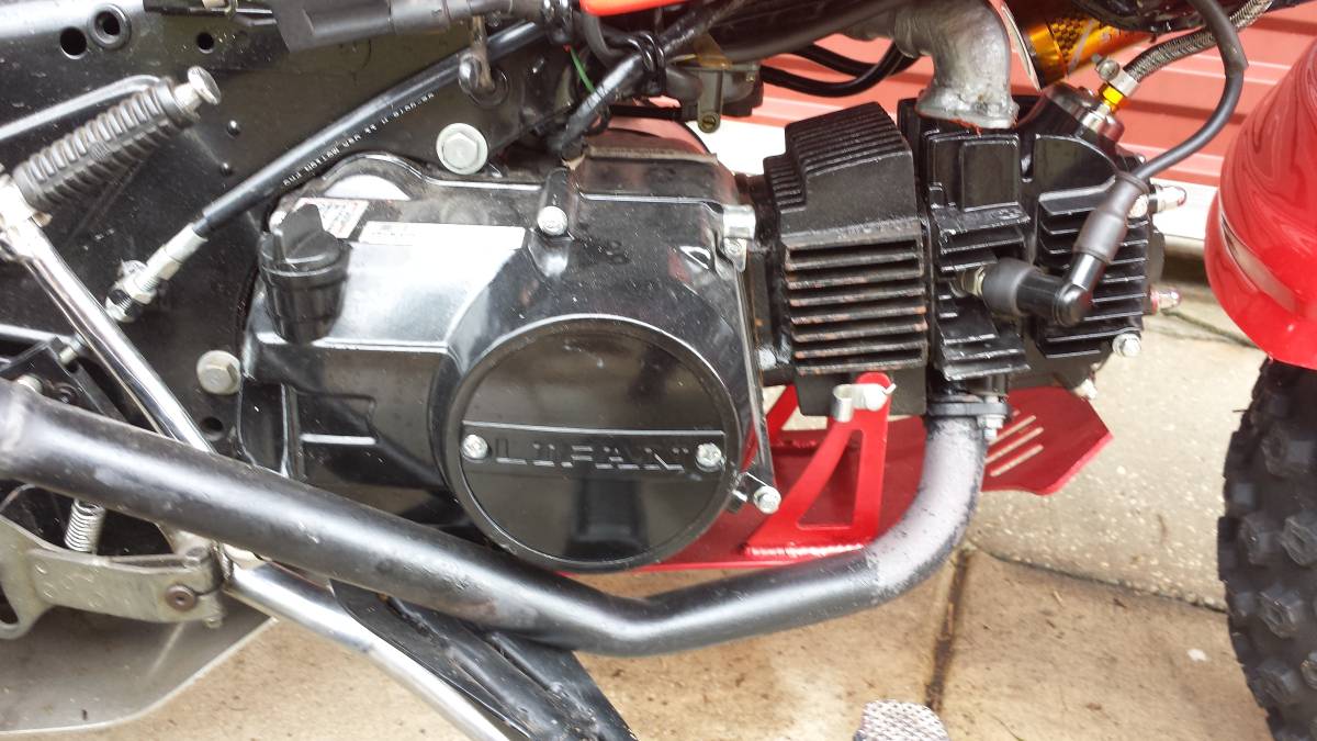

    I found an ad today with a 1983 ATC110 with one of the Chinese Lifan engines installed. Can anyone chime in on what mods or brackets need to be made to get this swap to work? I have a 1985 ATC125M that had the bottom end of the engine fail after I had the top end refreshed so this seems like an economical way to get her going again.

    You should keep your atc original. Contact Shortline10 hes in your area & works on these machines.
    What exactly happened to your bottom end? Im not sure about those engines but some of the 70 guys use them.
