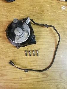

    stator cover, left side as sitting on the bike, wires coming out of it go to the lighting coil. as mentioned, download the online factory service manual.
