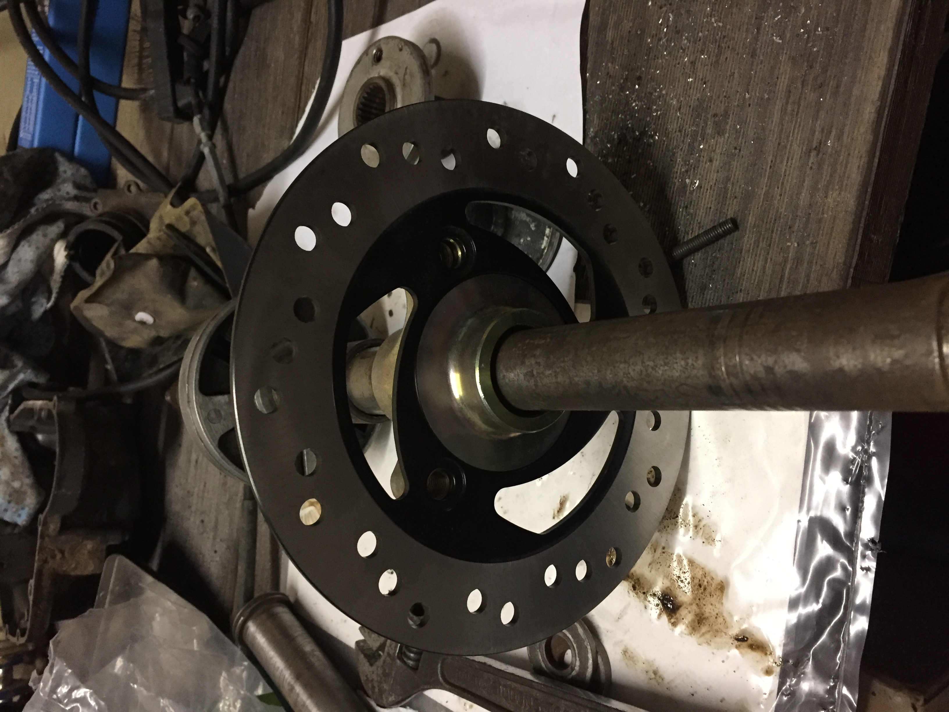

    I managed to find a set a rear brake hub off an Eton ATV that fits the factory honda splines so I can run a Disc brake setup which will work well. The only thing I will have to do is run a slightly different size seal and machine the crush tube to fit flush with where the hub sits on the axle
    Heres the excess that needs to be machined off because the disc hub is wider than original drum.
    FYI These Eton hubs fit straight onto the atc 70 axle
