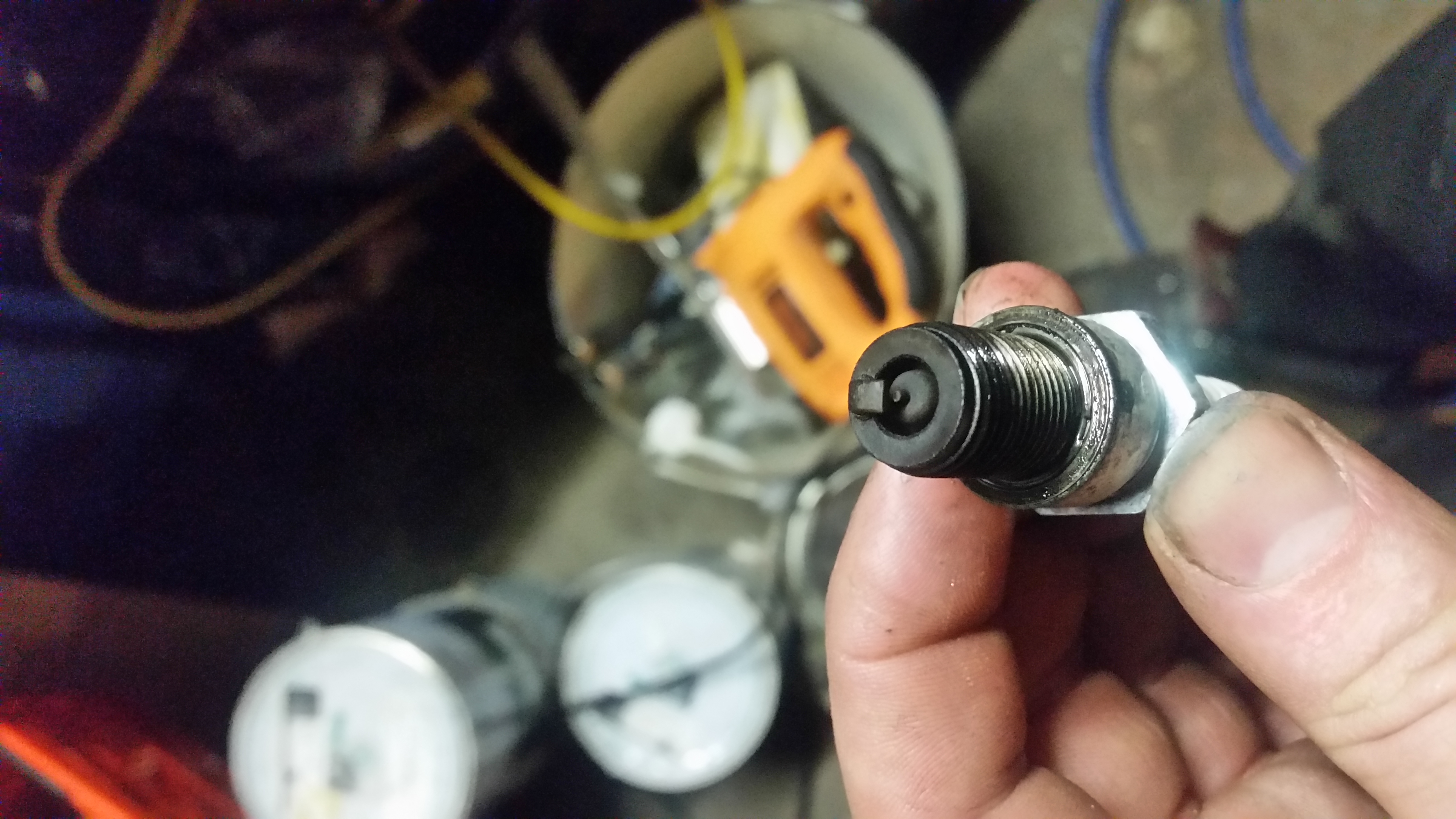

    Post a large photo of the end of the plug and of the cart that shows the engine.

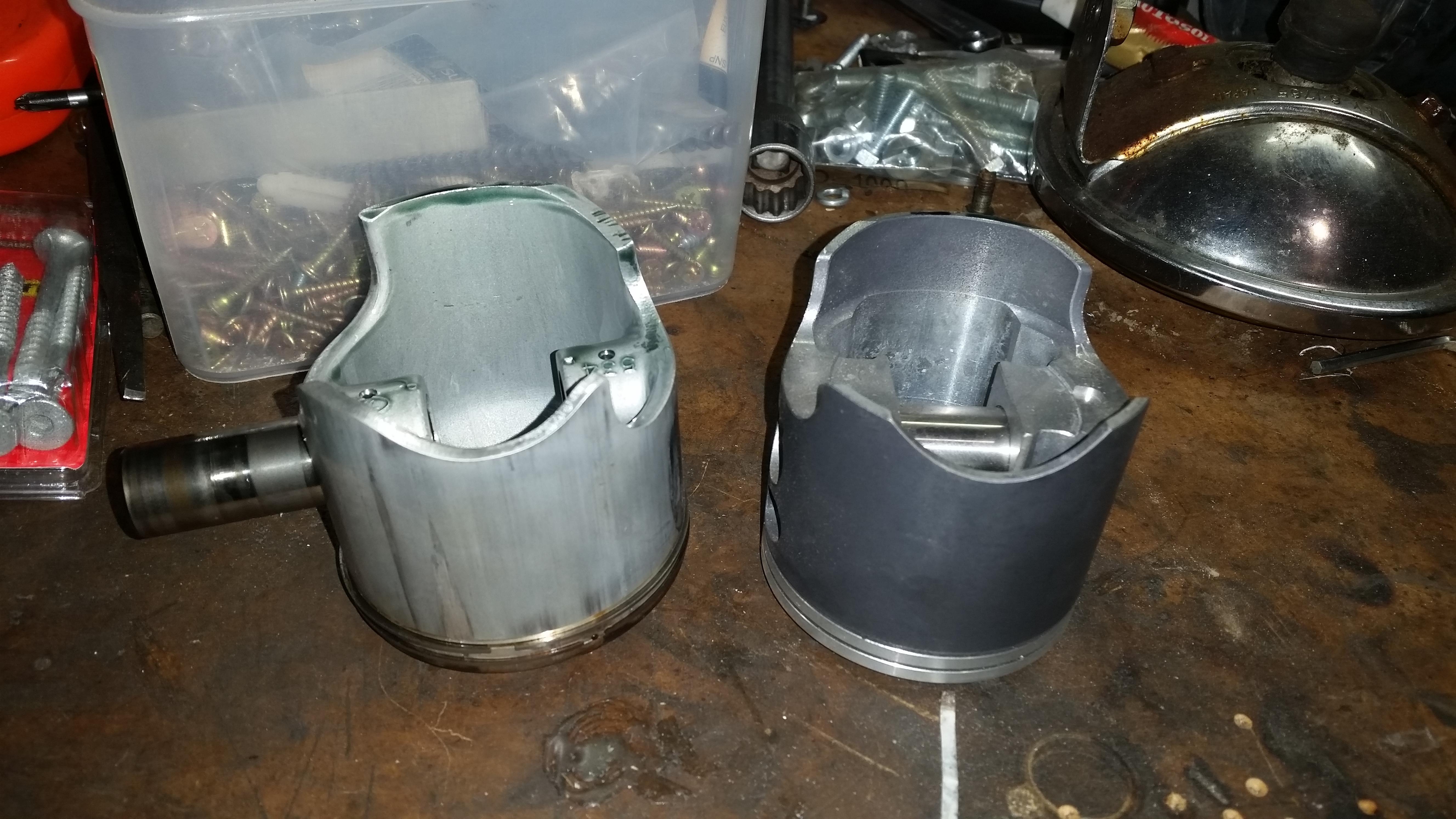

    HI guys I'll get some things together for you to answer some questions. I bought the kart all built the way it is so quite a few things are unknown. It has been toyed around with lots of grinding on inside of ports etc and the piston is apparently not a atc250r piston but has been made to fit .I have compared it to a atc piston and it's slightly higher in crown etc so most likely higher compression hence why I ran race gas to prevent pinking. It has thicker walls than the atc piston I am wondering if this could be my problem? I am running fully synthetic castrol tts race oil at 24:1. I have checked timing and it looks to behave as it should starts on one mark at idle then move's to other mark with revs. I'm running a 10 cold plug where standard is said to be 8 I'll get some pics up when I'm back home.

    sounds like a cast piston.

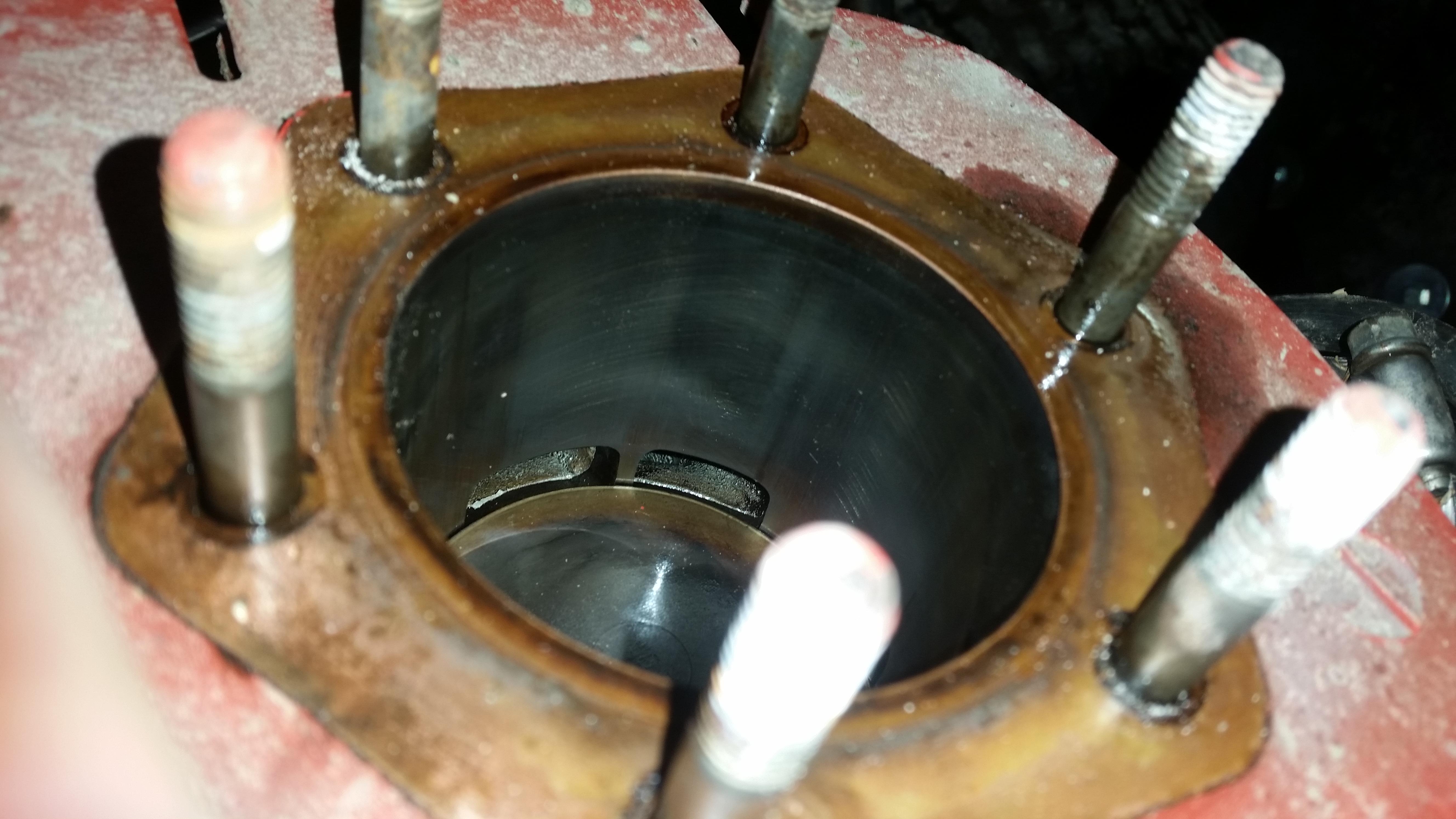

    measure the bore and post the size.
    you should also check the piston to quench/squish ring clearance and also the angle of the piston dome compared to the angle of the quench/squish ring in the head. it is possible that these angles are incorrect and possibly even reversed which could cause a problem but most likely would not be the only problem.

    Plug is ngk B10EGV pics coming and a link to video where you can here the (what I think is) detonation knock and then seize.

    bore size is 71.5mm, i do have another barrel and piston ready to go that is 70.5mm and uses a wossner piston meant for 1981-84 cr250r would i be best to just swap to that for now and get a 71.5mm atc250r piston for the other barrel instead of usuing this custom made piston (i was told is a husqvarna piston brand wiseco)
    Carthage NY 250r rules
    2,355
    Your cylinder to piston clearance is to big. Should be around .002-.003. That piston looks hacked and could be causing the knock. Your best bet is using the other cylinder and wossner piston. The early cr piston is same as 81-84 atc and I think 250 odyssey.
