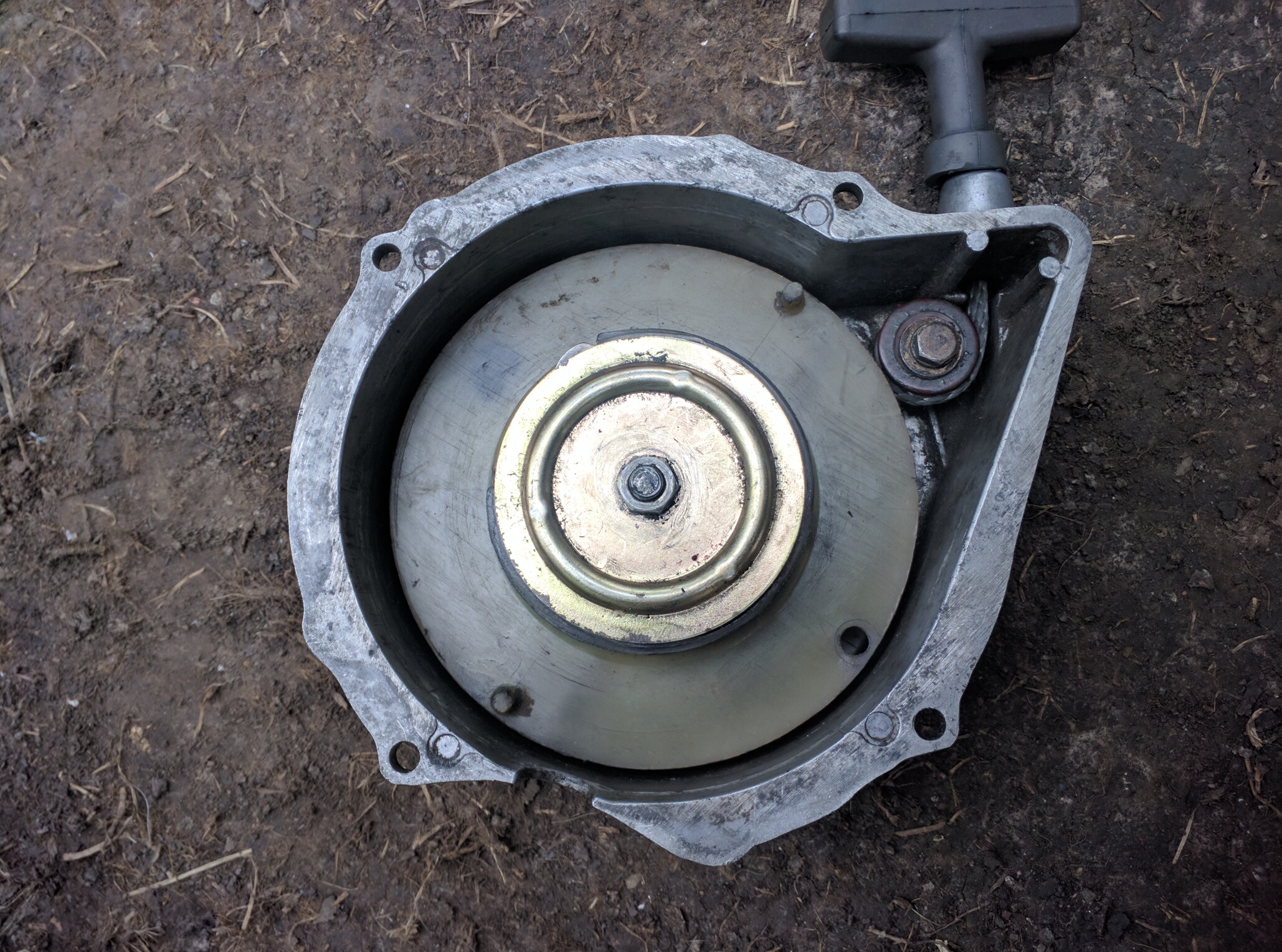

    RubberSalt -> so I got home this evening and started to remove the starter cover to get to the flywheel, so that I could take pictures of the stator. I didn't get past the starter cup, as what ACT007 had said, stuck out in my mind: I noticed that all the clips that I installed were on the right side of the holes, which meant that the starter was engaging and turning the engine "CLOCK WISE" and NOT counter clockwise as I had earlier speculated. Click image for larger version.

    So, after reinstalling one of the clips that had popped it's welds and running the engine rotation in my mind over and over - I was convinced the issue was the recoil and I had been trying to start this engine in reverse!?! (see attached picture). The guy that I had gotten the trike from had reversed the starter and I had just assumed that the direction was correct as it was working... or not.

    I completely disassembled the recoil, flipped the coil spring, moved the engagement clip over to the opposite hole, re charged the spring, fed the cord around the inner pulley and installed the handle (see attached picture). Once installed, I reinstalled the muffler CONVIENCED this was the issue, and ready for a test start.
