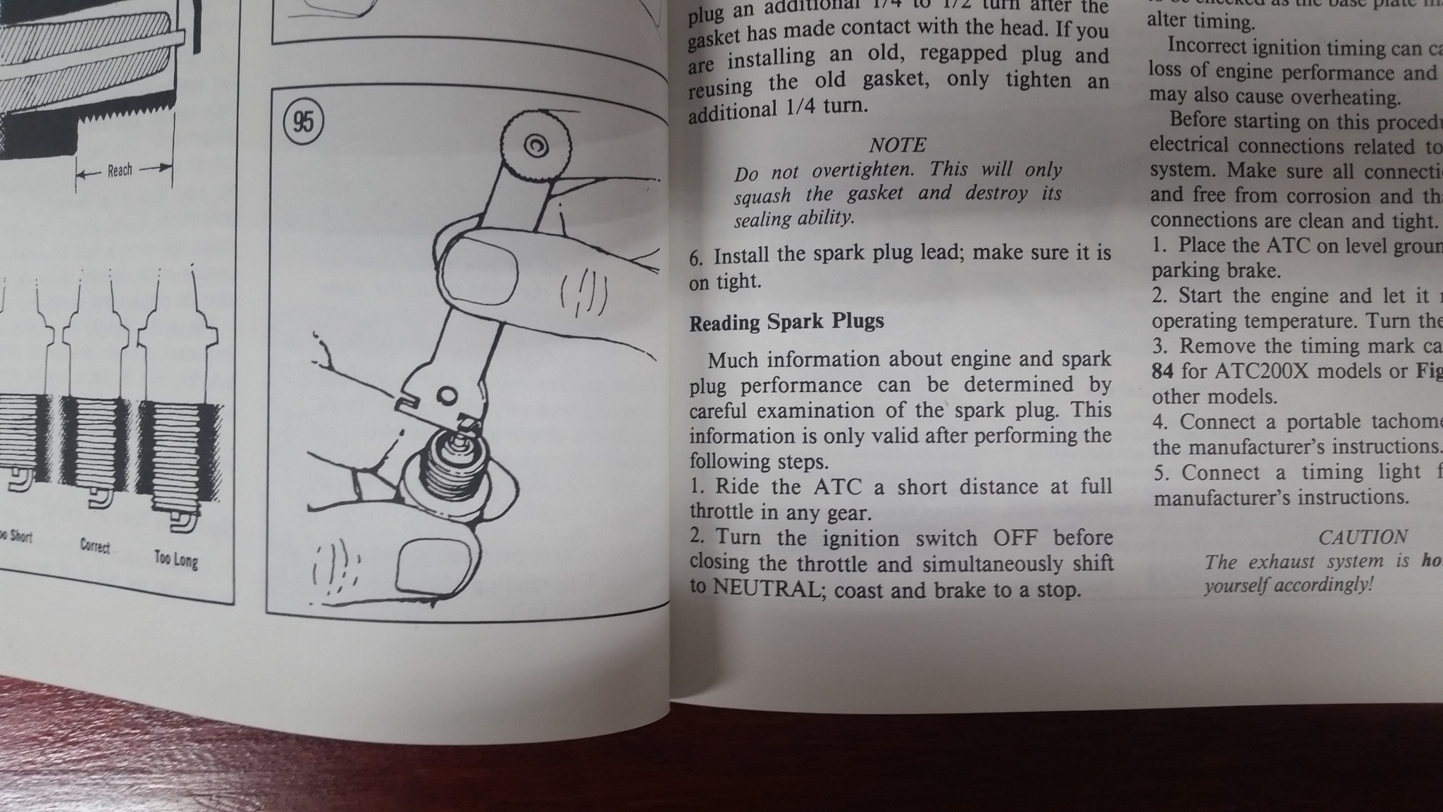

    I know there are dozens of posts about spark plugs.
    I just have one question when checking how the plug is burning, do i ride at high speed then shut the engine off. I seemyo have rember reading about this somewhere
    Thank you

    Yes i know , but is thee a certain speed that you check it at

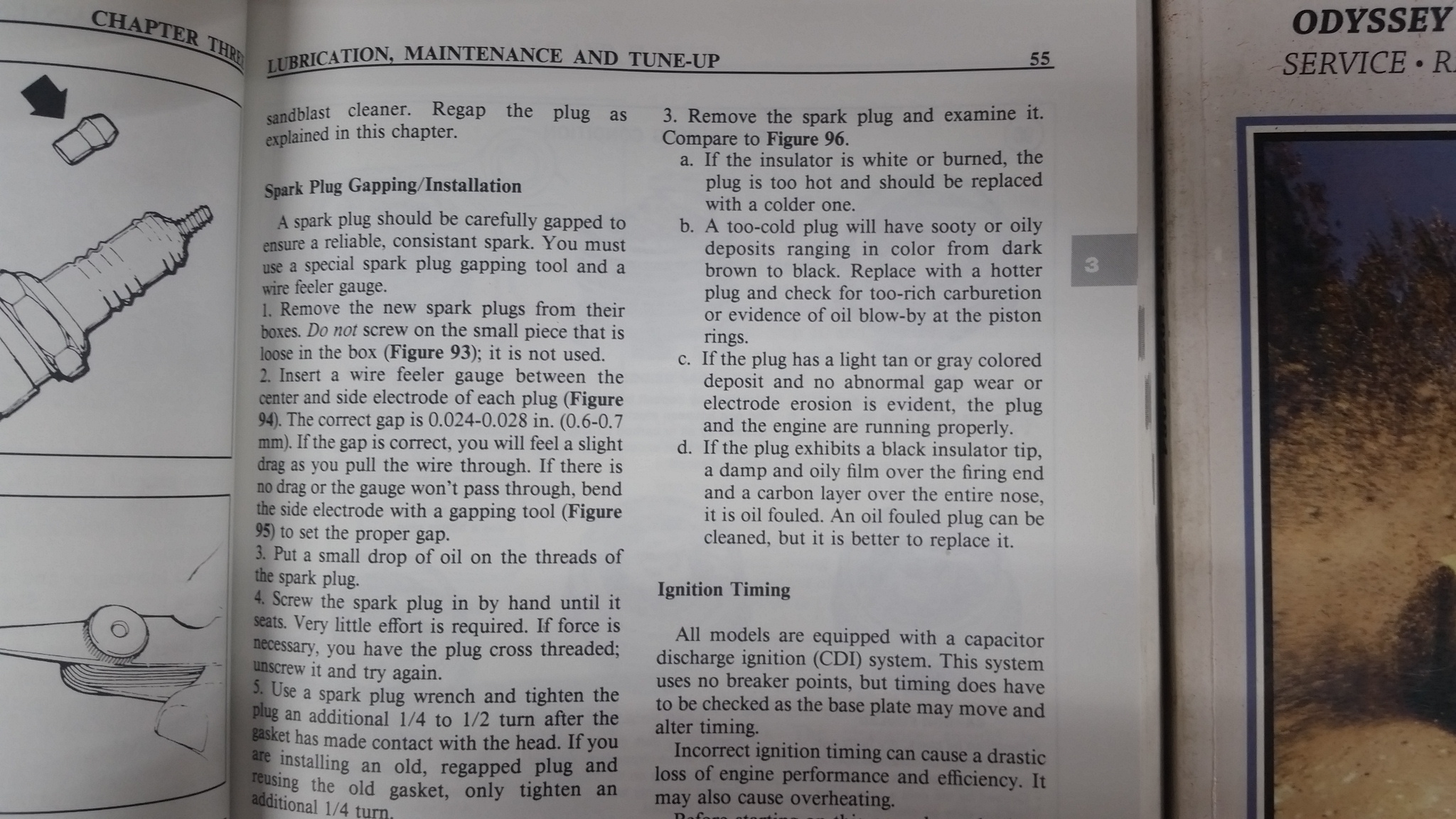

    Welcome aboard Eddy
    Took a couple pics of "another person's opinion " ~ lol. Well he wrote it in a Clymer manual
    john
    P.S. ,,,, I have no clue why my pics are upside down lately,,,,

    Well hey,,, they are right side up !
    Any way,,,, look deep inside the plug for correct reading interpretation readings,,, not just the end. Best to use a relitvty new/clean plug imho.

    Ok , lol , wfter reading the upsude down posts , i think i wm right . High soeed and shut down
    Thanks for the info
