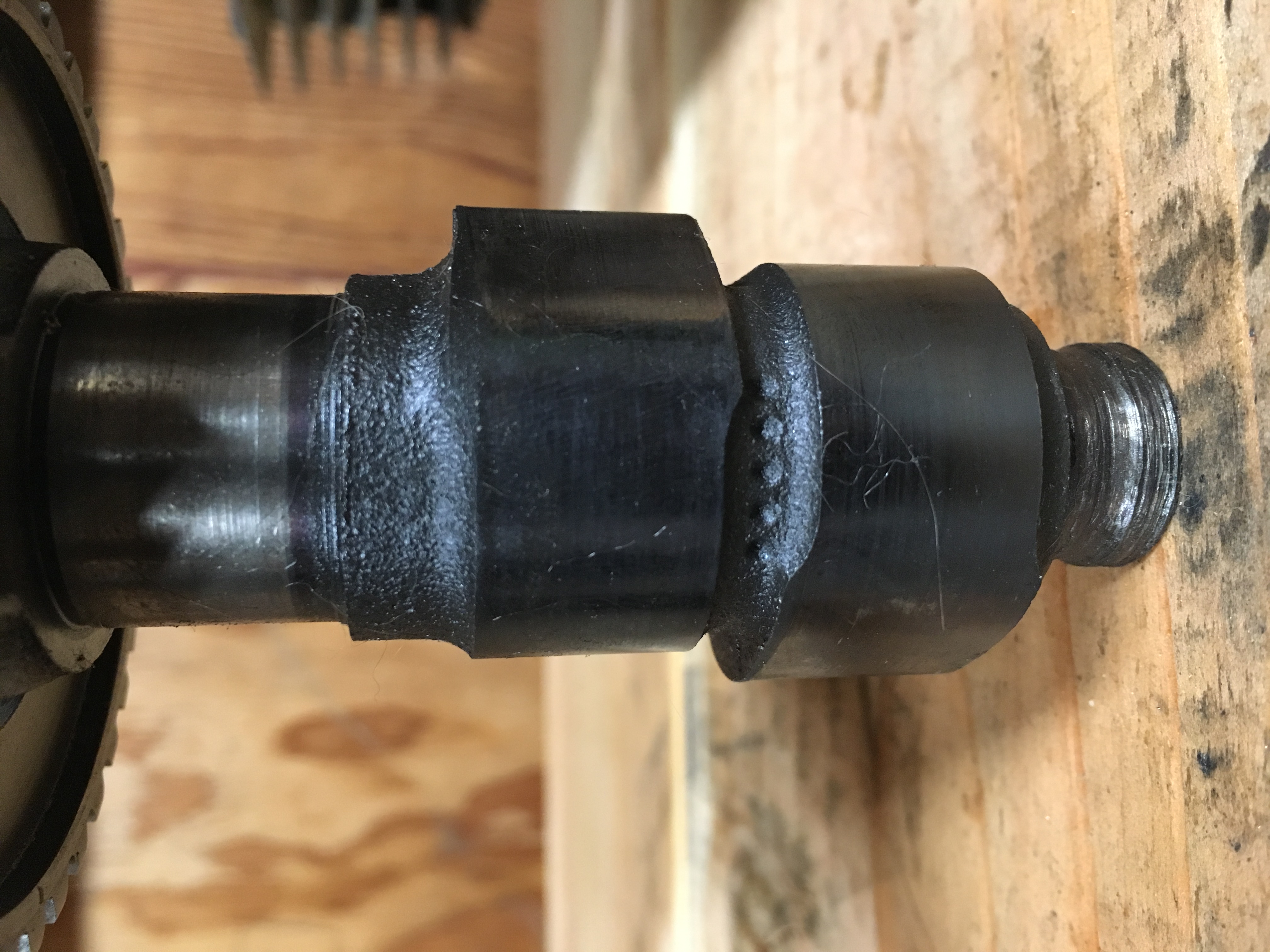

    Here's the pics of the 2 cams and the serial number on the case. The cam with 5 dots is a stock 85 250sx cam. The cam with 2 dots came with the shop motor.

    Quote Originally Posted by 3wheelerdan View Post
    Unfortunately I don't have a lathe or any equipment to measure the lift and duration. I was hoping that the marks would be enough to ID the cams.
    Nope.
