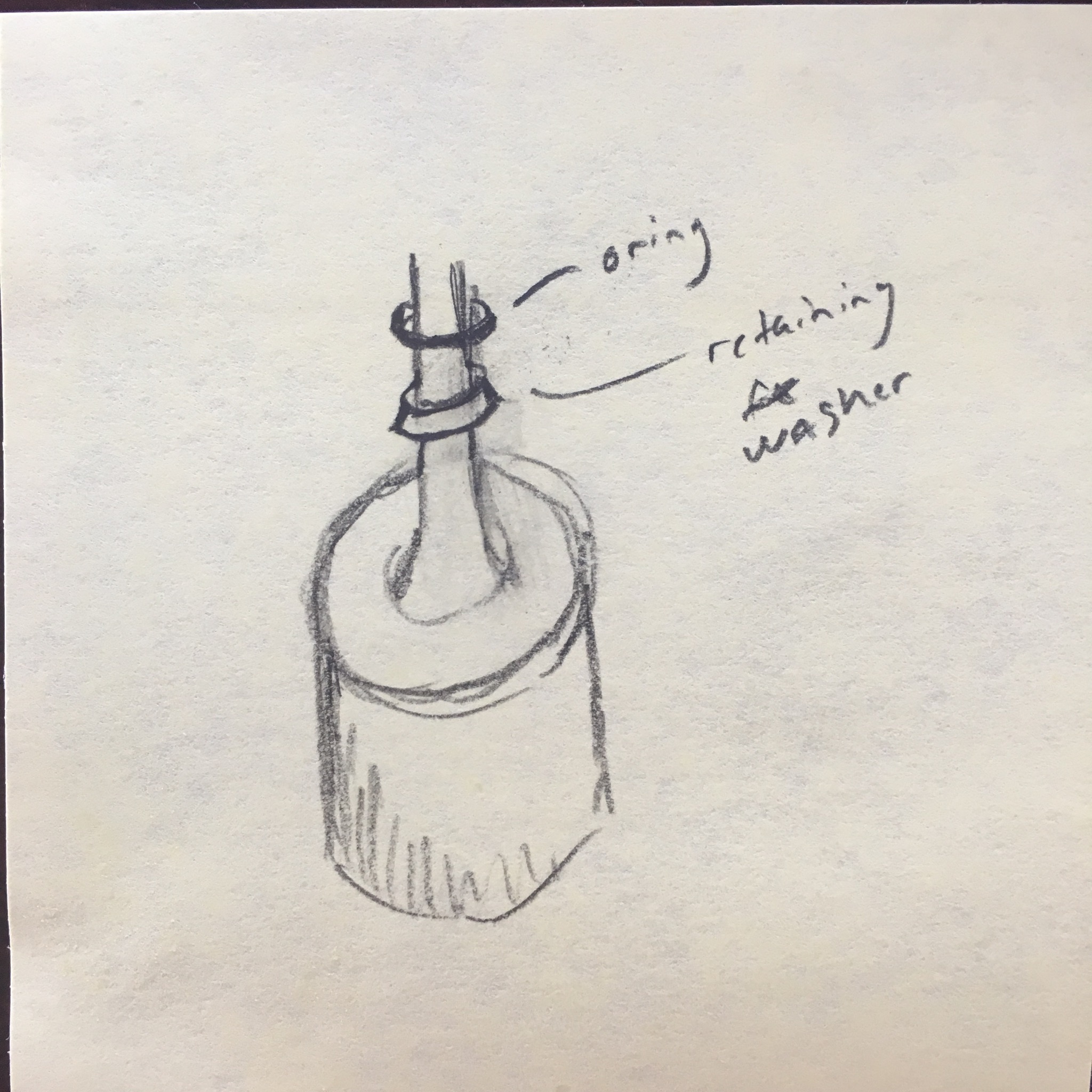

    I've done some heavy thinking with wonderboy. I had this washer on my rear brake caliper piston parking brake shaft.
    Unfortunately I destroyed it while unfreezing the caliper during a rebuild.
    After the rebuild, i'm leaking fluid out of the rear brake caliper. When engaging the brake, fluid is forced out of the caliper through the piston parking brake shaft assembly. I.e. where the washer would be. So, I think the part is a necessary one. I think the part retains the o-ring. The washer is necessary to keep the rear caliper from leaking fluid at each brake depression.
    Also, here's confirmation that the part doesn't appear on any honda BOM or schematic I could find. Wonderboy and I have both cross referenced the piston. The part is "Honda 43109-961-006 PISTON." The piston appears on a bunch of ATVs, even modern ones. So we both thought that by cross referencing the part, we'd eventually find the mysterious washer in another rear caliper assembly. Alas, no dice. Again, the part does not appear on any honda BOM that we could find.
    Finally exhaustive google searches on "cup washer", "retaining washer", "o-ring washer" and the like turn up close hits, but nothing exact.
    So, if any one has an extra one of these washers, please PM me.
    Else, if you know the dimensions. Let me know that. ID, OD, anything else.
    Else, any advice?
    Any help is much appreciated.
    Here's a drawing of how I found the washer riding on the brake shaft. If I remember correctly.
    Also, here's a dude making a similar part on youtube. Again, close, but not the same.
    Feb 2019
    south
    closing this out.
    Bottom line: the metal retaining washer is not needed.
    I finished rebuilding the rear caliper with a kit. Once we tightened everything down, including installing the parking brake, we are leak free.
    And the brakes work.
    So, apparently the part is optional.
    --hipturn
