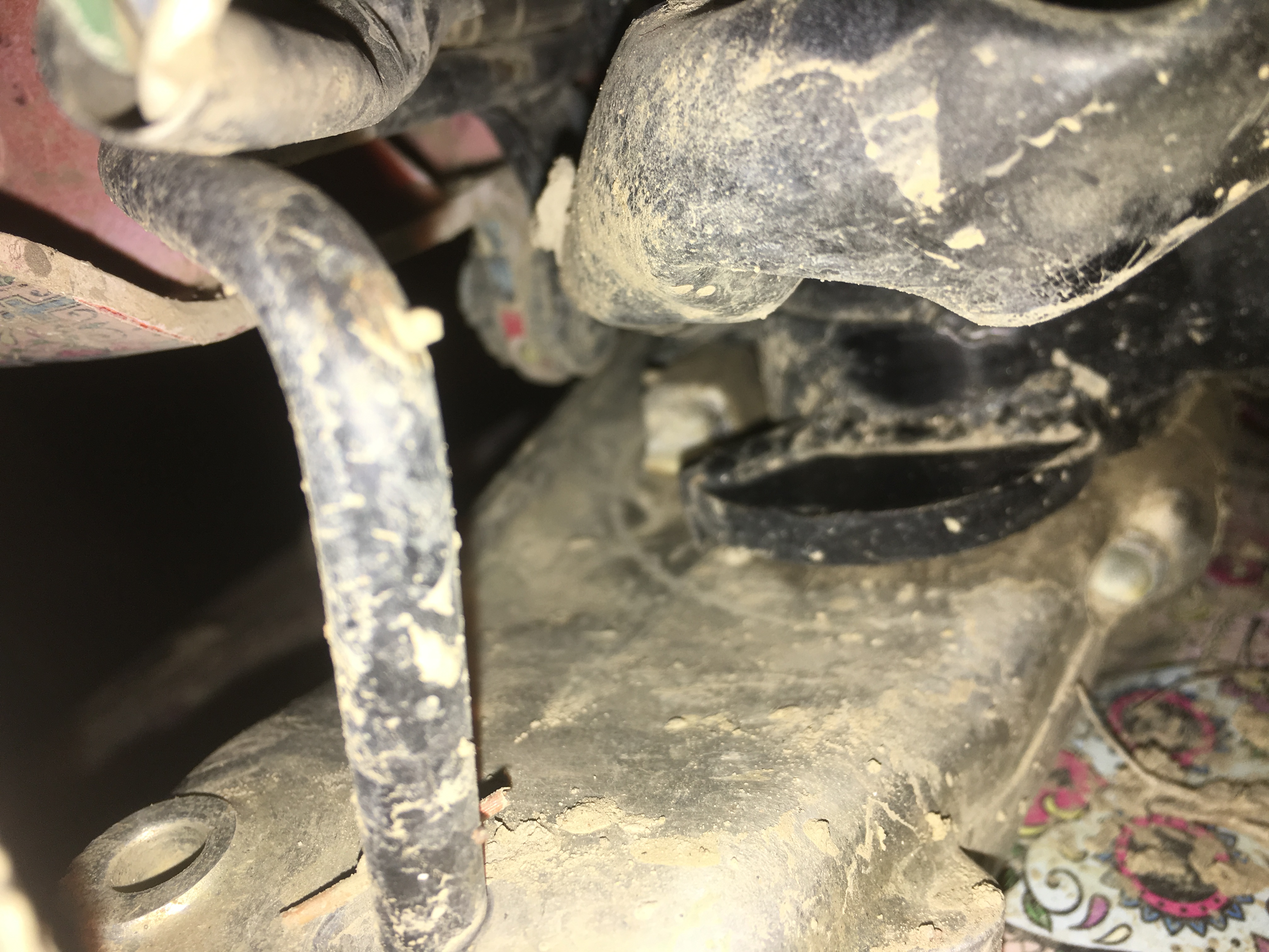

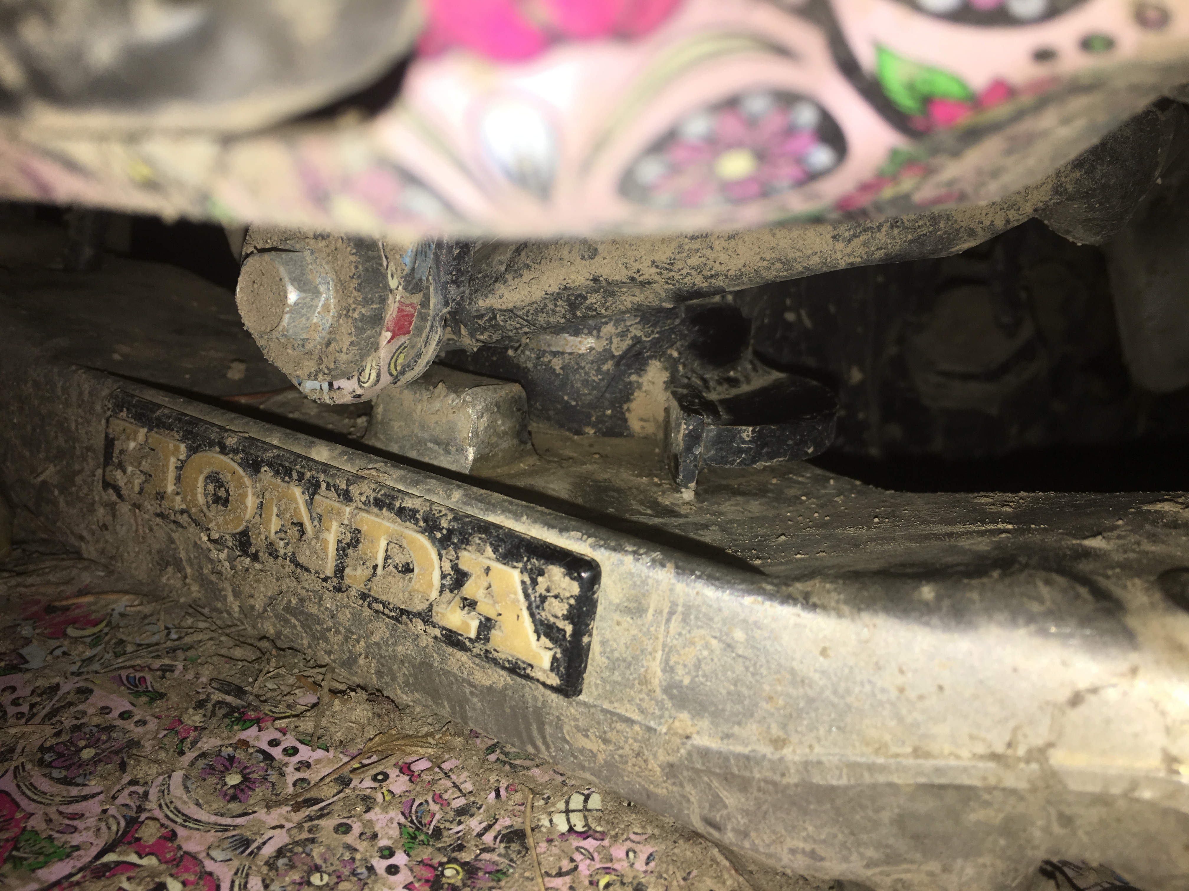

ID:	247924Click image for larger version.
ID:	247925Click image for larger version.
ID:	247926Click image for larger version.
ID:	247927I did this conversion on the girlfriends bike. Wish I had pictures on this phone. What I did was put the tripples on the bike and welded the stops about a 1/4 inch before the tripples hit the tank. I'll go take some photos. Hope this helps?
