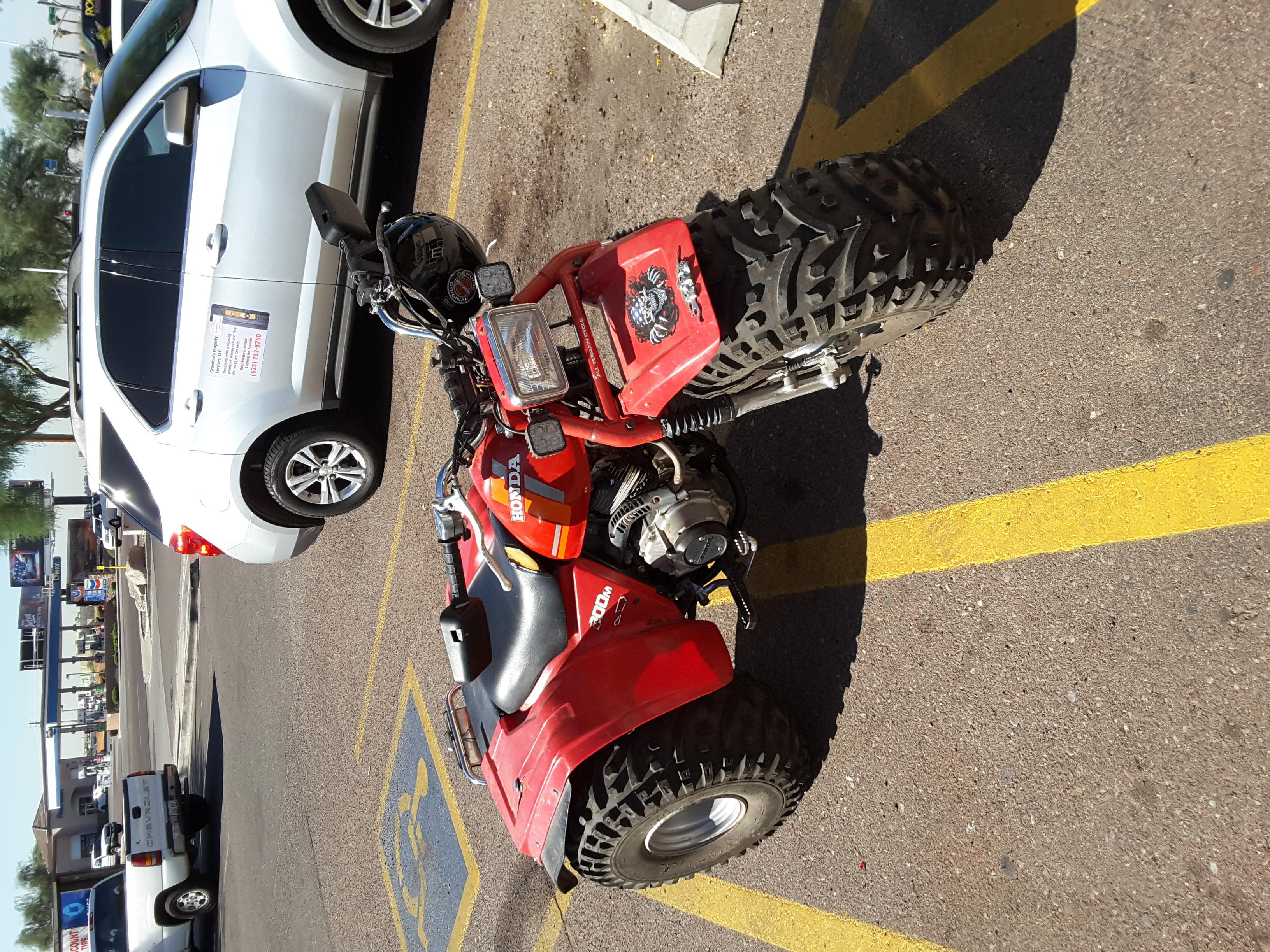

    Seen this old guy roll up to the bank in a 1984 Honda 200m, memories from my teenage years came back to me riding atc`s. I bought his bike a week later. Currently going through it making it my own, should be riding in the desert by the weekend.
