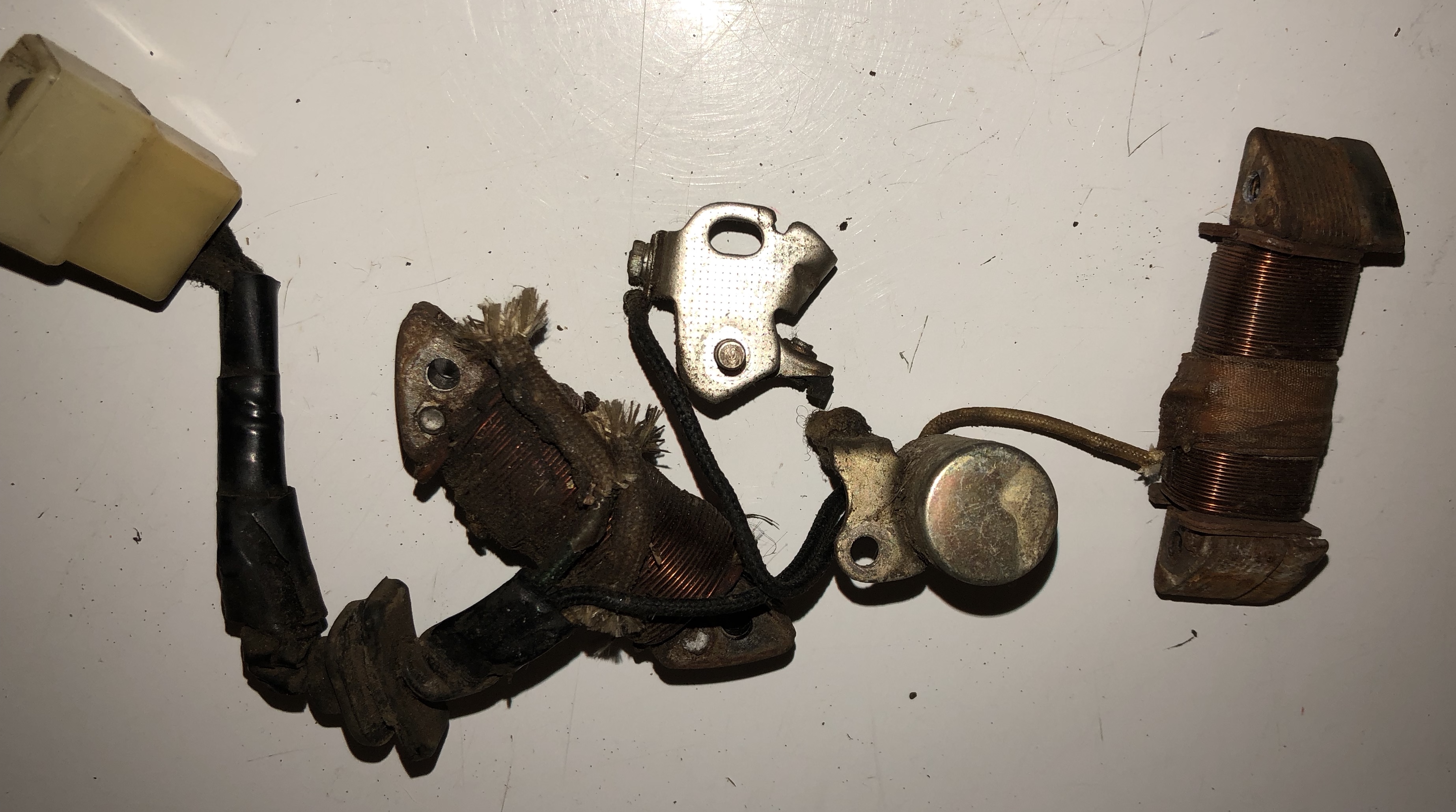

    Post some pics of your points and condenser. Let’s see how it looks, Mabey there’s something we can spot that your missing. I started working on points last April, now they are real easy to work on for me.
ID:	248437Click image for larger version.
    Dec 2017
    Fayetteville AR
    7
ID:	248439 hopefully one of these pics will shed some light on my issue
    Jul 2012
    Seattle, Washington
    1,543
    What is that white piece of plastic behind your points? I have never seen anything like that on my engines before. It’s hard to tell if your points are set to the right position with that piece of white plastic in the way.

    Have you removed the coils and inspected them? Make sure the copper wire is not damaged or broken. That electrical tape is kind of a red flag as to some possible pre-exsisting damage. If there is a break in the wire anywhere you can try soldering it together, that may work in a pinch. But if you find any damage I’d suggest ordering new coils from the link above.

    *** Check those tabs on your condenser, if they are touching the outer edge of the condenser it may be grounding out and not working. You should always make those tabs fold over neatly and solder everything very clean.***

    The plastic behind the points is me brain storming on what could be causing me not to get fire. I do not have the felt on my condenser like in the pic you posted so I will look into that asap. The electrical tape on the coil is me also just redoing what was done by someone else in the past.

    I’m thinking your condenser tab that is folded over is probably touching the outer edge of the metal body & grounding out the circuit. They usually come much too long & I sometimes snip them shorter to make a less cluttered area.
    Remove that plastic it’s also just in the way, your almost there. You may want to order a new ignition coil if you can’t start it after checking the condenser. I’d desolder that condenser and clean that area up, snip those tabs shorter...there way to long to begin with imo.
