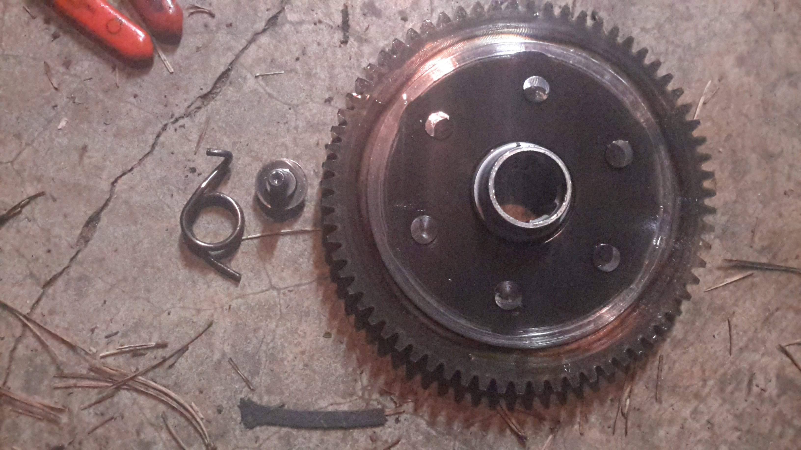

    Having some issues with getting it to upload, if this doesn't show it I'll send another... thank you the shift stopper arm is in the other shop I'll get a pic asap

    Boy I tell you what Mr. Anderson that is some DAM damage for sure.. don't really have an answer for ya at this time, look for something bent. Do you have a manual ?some good pics and breakdowns of parts you could compare to.. I gotta believe something is bent or missing, something as simple as a washer or shim would do it.. I'll check the book tomorrow see if something triggers a thought..

    What I have came to the conclusion of until I get the parts in the mail, the bolt that holds it all together has play in it so we ordered a new one so I'll get more pics and let everyone know how it goes and everything is still flat an flush it's just wore from previous owners riding with broken parts in it..... thanks!
