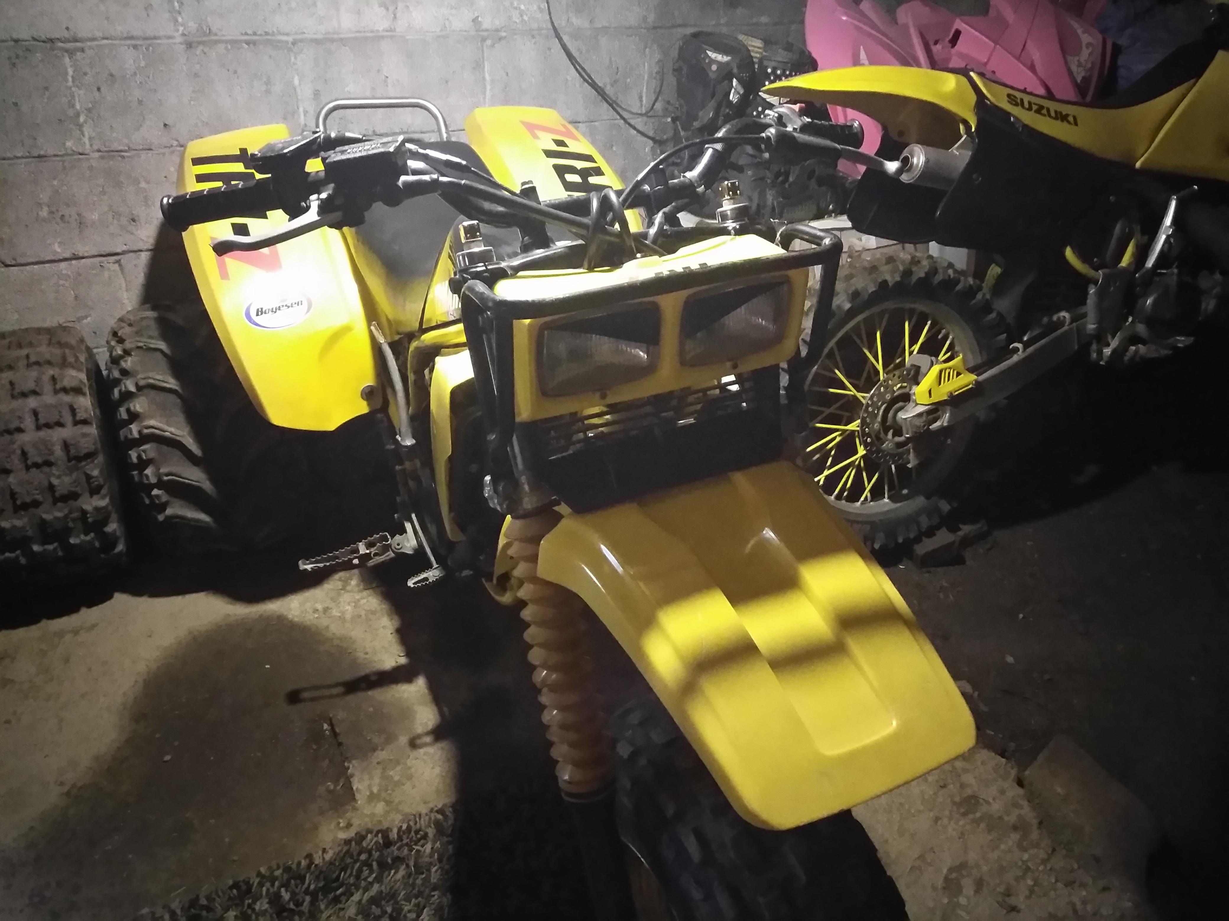

    I hate to say it but I may have to bite the bullet and take this machine to the shop and pay (money that I don't have) for them to figure it out. I don't understand why it starts for a minute or two but only if its cold and its the very 1st attempt at starting it for the day. It starts right up but runs sorta boggy (if I give it throttle it wont rev up high at all and instead it boggs down) and I have to blip the throttle a little bit just to keep it idleling but it eventually gets slower and slower and boggs out completely. Then after that it wont start again? Not even with a shot of starting fluid even though it was just running for a minute. But it will start tomorrow and do the same thing. It will run like crap for a minute, just Bogg out, and wont start again? I bought it a few years ago, put plenty of miles on it, and it ran ok. It just smoked more than its supposed to which I assumed was due to an old worn out piston and jug. Then it started doing what's its doing now. I figured it needed rebuilt or reeds or something. so now I finally got it all back together after having it bored .040 over. (fyi don't bore a tri z jug to .030 because for some reason nobody makes rings that size? You can get .010, .020, and .040 only) Its got a new air filter, carb is squeaky clean, new reeds, new piston and rings, plug, ect.... The compression gauge is reading 155psi. the spark plug is definetly sparking. I even tried another plug just in case and they both spark fine. So it seems I have fuel, air, and spark but its not running? I thought maybe the stator but its sparking fine. And I also thought maybe the fuel pump but why would it not start with a shot of starting fluid and why does it pump fuel for a minute or 2 and then stop? With starting fluid sprayed in the cylinder it should at least run for one second or 2 even if the carburetor was completely missing and it literally had no fuel in the tank right? It doesn't even try to start. It doesn't even hiccup? Once it runs for a minute and boggs out its done for the day. I could kick it 100 times and absolutely nothing happens? Maybe I'll try gravity feeding the carb and eliminate the possible faulty fuel pump completely. But the possible bad fuel pump doesn't explain why it doesn't show any signs of life with a shot of gogo juice.
    I just don't get it?
    Any thoughts?
