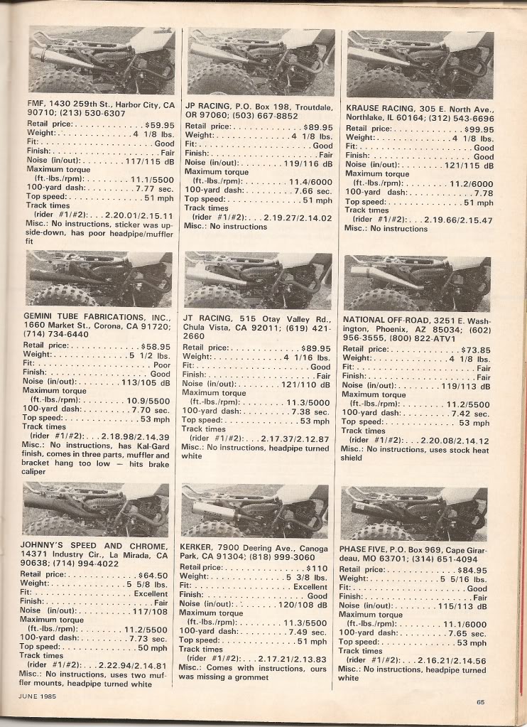

    Rob, I don't know if this is the thread you were referring to, but it contains an article from 1985 where 28 different exhaust systems were dynoed on a stock '85 200X:
    http://www.3wheelerworld.com/showthr...-Magazine-Scan
    The images don't show up well in the original post so I will just include them here. It looks to me like the SuperTrapp performed the best overall. Cool information for sure, I had no idea there were so many manufacturers making exhausts for the 200X back then. Too bad our options are not this extensive anymore.

    Nice find. I remembered a different dyno test. I have a '83. List was not that long. Going of my memory. 6-8 pipes. There was not much gain in HP via the stock. The pics provided showed a much advantage in pipes. Mostly down low but a good gain in HP.

    thats awesome i had no idea yoshimura was around back then. sadly they weren't very good back then from the looks of it. the stock pipe was decent especially mid range.

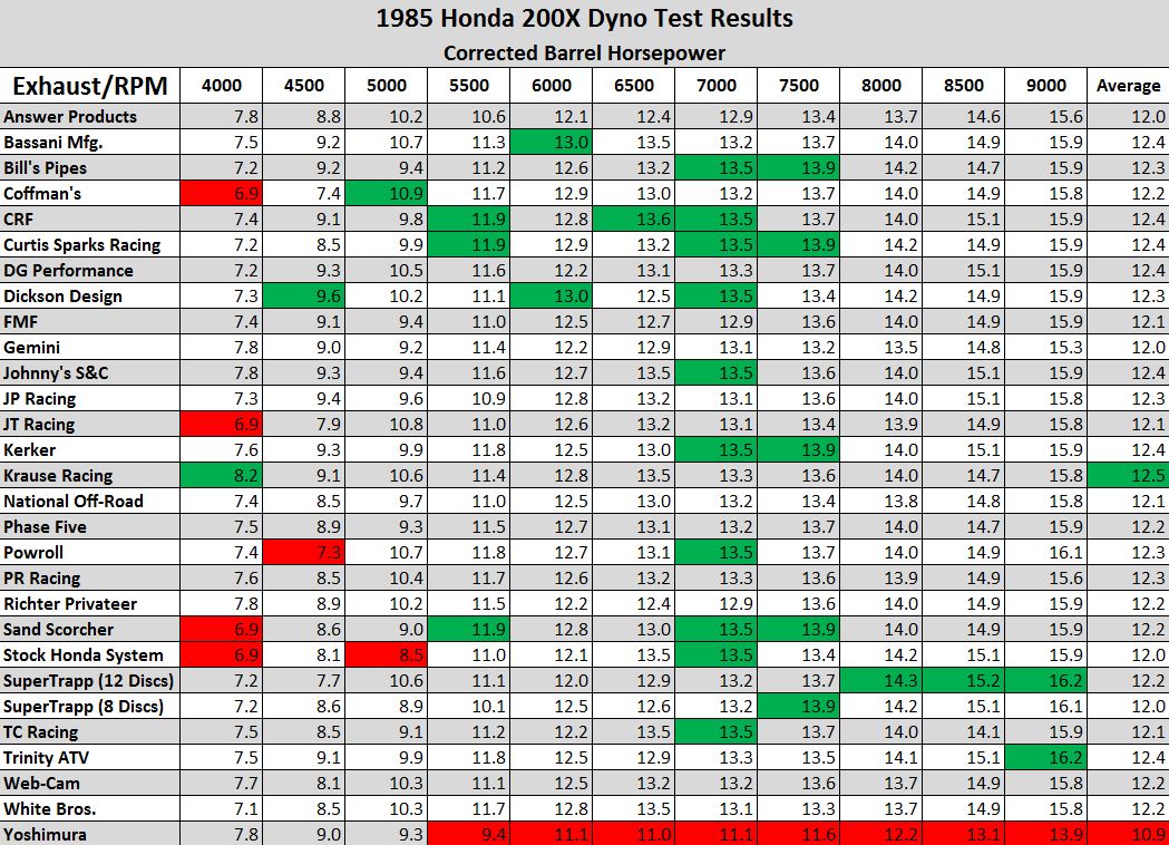

    I had some free time so I went ahead and put the results into an Excel spreadsheet. I then created a rule to highlight the greatest (green) and lowest (red) HP values at each RPM range. It's an easy way to see which exhaust produced the highest/lowest numbers at each RPM range.
Name:	1985 Honda 200X Exhaust Dyno Results.JPG
    I also added an "Average" column just for kicks. It doesn't really prove one exhaust is better than another, but it does represent overall performance across the entire power band.
    Side note: I am able to produce dyno graphs of each exhaust. If someone would like to see the graphs for a better visual representation of the data, I'd be happy to post them.

    thats really cool. makes it alot easier to compare them.

    Nice!
    Can you do conditional formatting on each column?
    Highlight the column >> Home >> Conditional Formatting >> Color Scales
    Select a Green - Yellow - Red scale and that will highlight the higher numbers in green-ish and the lower in red-ish.
    Then you can see how each compares across the RPM range.
    Cool that you found that article.

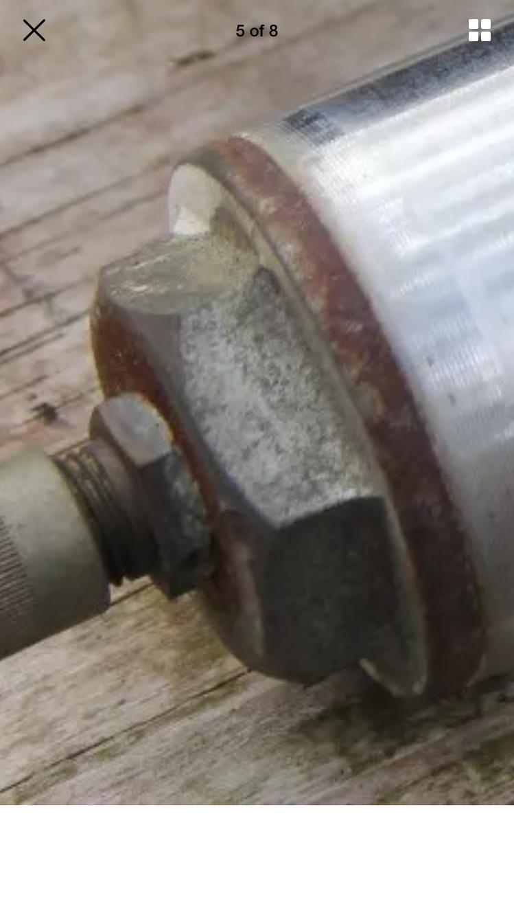

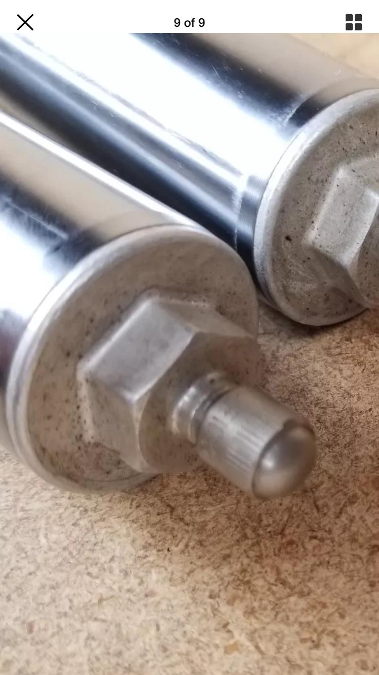

    Just going back to your fork question for a second- 83-85 200x have steel fork caps
    86-87 have aluminum caps, so yes there is an easy way to check. Click image for larger version.

ID:	249739 i know your already past this but figured i’d tell you anyway.

    Yeah Arky I can do that. I used the conditional formatting as you described initially and I thought the color scale made it too messy and hard to interpret. I will play around with it and see if there isn't a better way I can reorganize the data to make the color scale easier to read.

    Thanks for clarifying Shep! I have seen those aluminum caps around and wondered if they were the 86-87 caps.

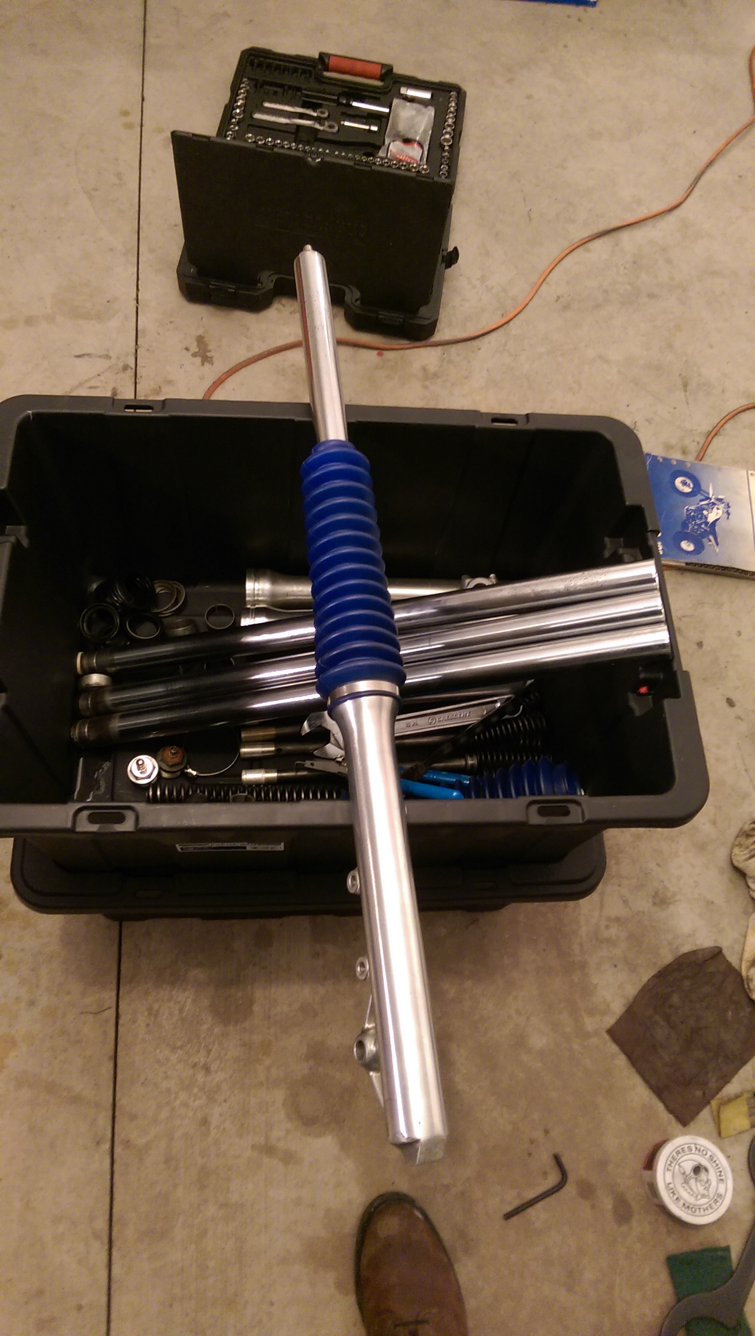

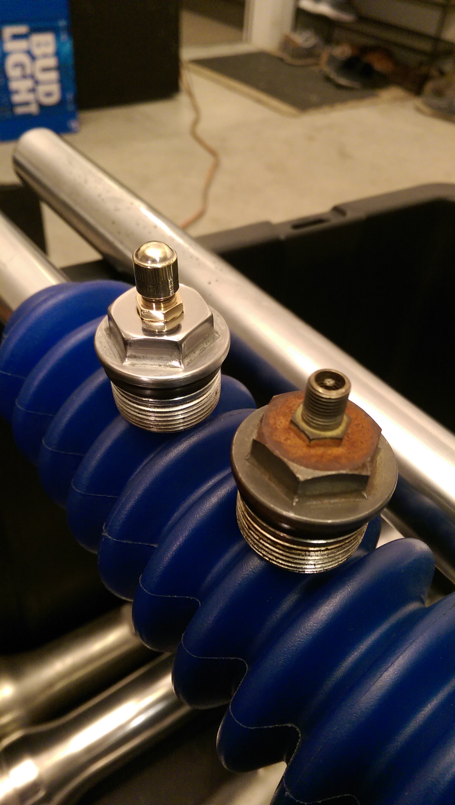

    Not to hijack my own thread but it's my first post in the new member discussion so what the heck. Here is a taste of my fork and fork cap after I did some polishing. Maybe I will do a 'build' thread of rebuilding and polishing forks/caps if there's enough interest.

    Nice work!
