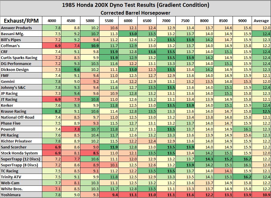

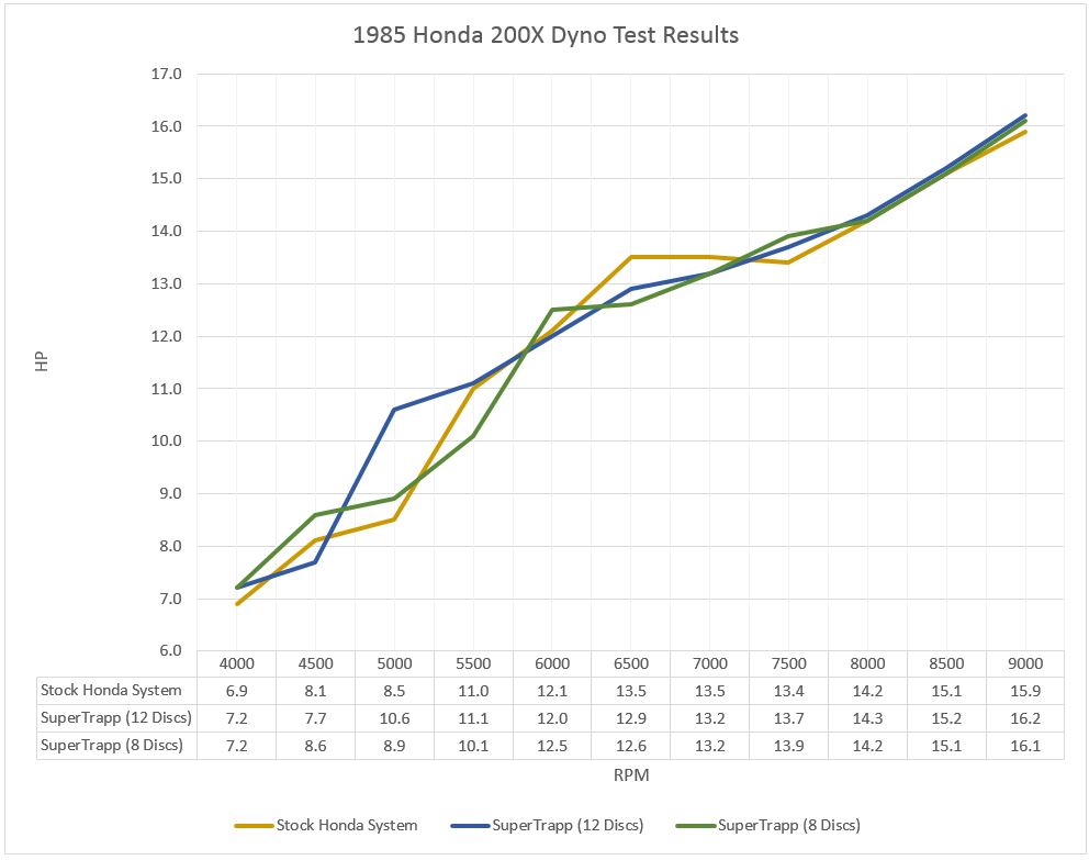

On the second page of the article (page 63) they state that the main jet was bumped up from the stock 108 to 110. They used that jetting for all of the tests. The airbox lid was also removed during testing.
Another good point they make is that the results only reflect the performance with a stock engine. With a built/modified engine, the exhausts would perform differently. Maybe the Yoshimura really shines when paired with other performance mods (i.e. cam, carb, air filter, larger bore, and/or hi-compression piston), and just not the stock engine.
TLDR: This data is not the be-all-end-all to declare which exhaust is best for every 200X, just the stock ones. My guess is this data does not apply once other performance mods are added to the equation.
