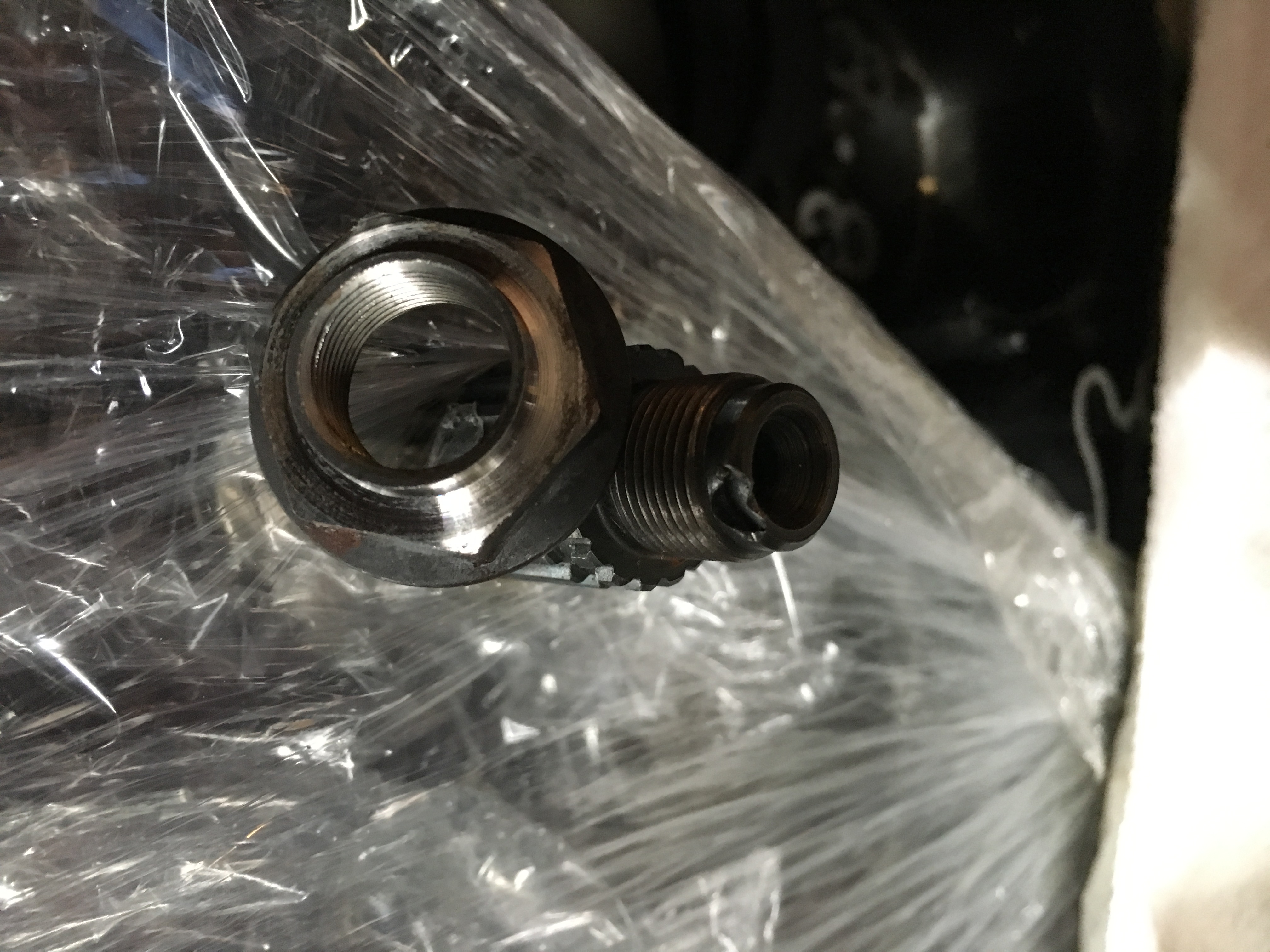

ID:	249792 maybe this will help (maybe) hopefully your putting it all back together at this time
    And dont use any RTV you’ll regret it later
    The pic is clutch area and the nut is new so it wont show it dented inward in one spot, the plastic is to keep all the dam cat hair out... ha

    Quote Originally Posted by Mikeyclark12 View Post
    by the way where did you buy the nut from??
    The clutch nut i bought new from honda, i stocked up on a few parts years ago. They show up on ebay too, but sell quick.
    Maybe try to reuse yours? Or buy another used one, maybe try a honda dealer you never know what they still have.
    Maybe put another thin shim/ washer on so you can stake it in a different spot?
    Shep
