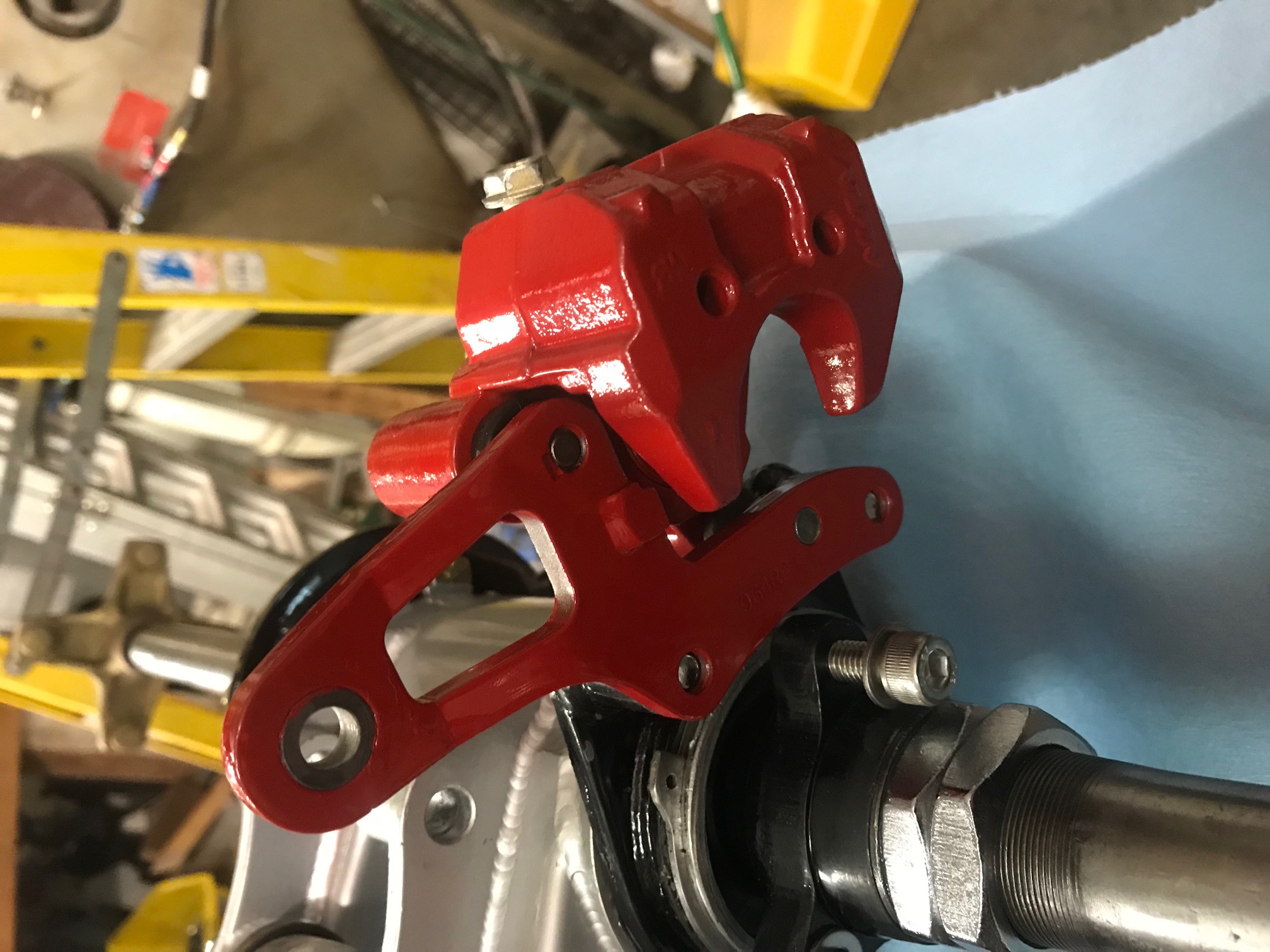

    Quote Originally Posted by Dcaldart View Post
    Cr80 cr85 kx85 is kx80 (rear) all work if you don’t want the parking brake. I have two trikes running them
    Well I got a brand new rear caliper now I need the mounting bracket

    Still building my 84 well not much 84 left lol

    Looks like the engine is still 84 lol
