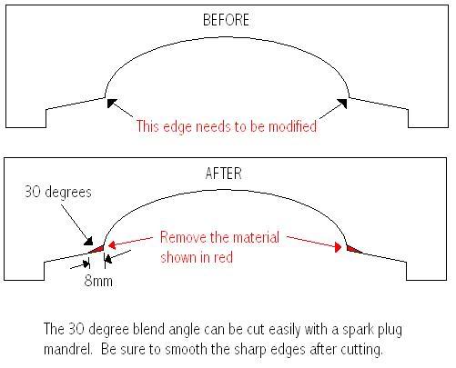

    Here's one suggestion from the Internet. If you can find a place that has a reputation for fixing the detonation issues I'd send you head in. All in, all done including shipping shouldn't be over $200 bucks which is a lot less than a rod and piston and whatever else. Your call, but I wouldn't start it without at least a head mod and some big fat jets. If the timing is adjustable you may want to start off at full retard.
    I am looking into it. I have a couple of shops near me.
    You might also want to fire a compression release through the head while it's apart. They're pretty cheap and I think it's as easy as making hole in the head and threading it in.
