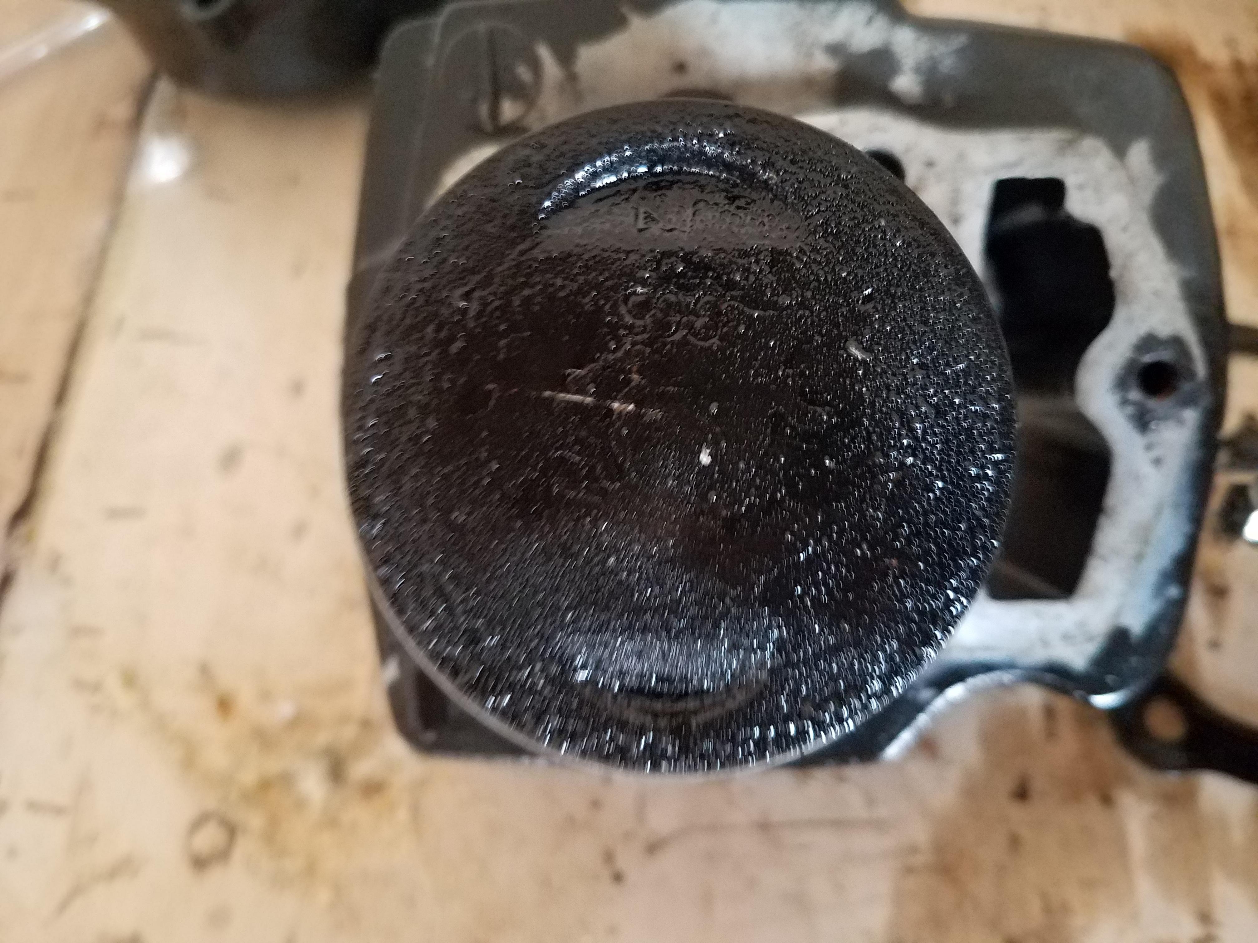

    Well the mechanic finally tore down the engine and it happened not to be the piston rings or valves, it was a blown head gasket. It still had the honda stock piston in it. And the piston actually said Honda on the bottom.....However look at what 33 years of riding will do to a piston this is all carbon build up. Click image for larger version.

    That piston has been burning oil for some time thus the massive carbon build up. Those rings are guandi.
    New problem need advice
    So just a head gasket? That's good news! I dunno if you've already got it back together but it wouldn't hurt to run a hone through the barrel real quick before assembly.
    He is going to clean the carbon off of the piston and clean up the head a little, he is also going to hone the barrel as well, I am still waiting on the head gasket kit to come in, it won't arrive until Tuesday. So I won't be riding it anytime this weekend sadly.
