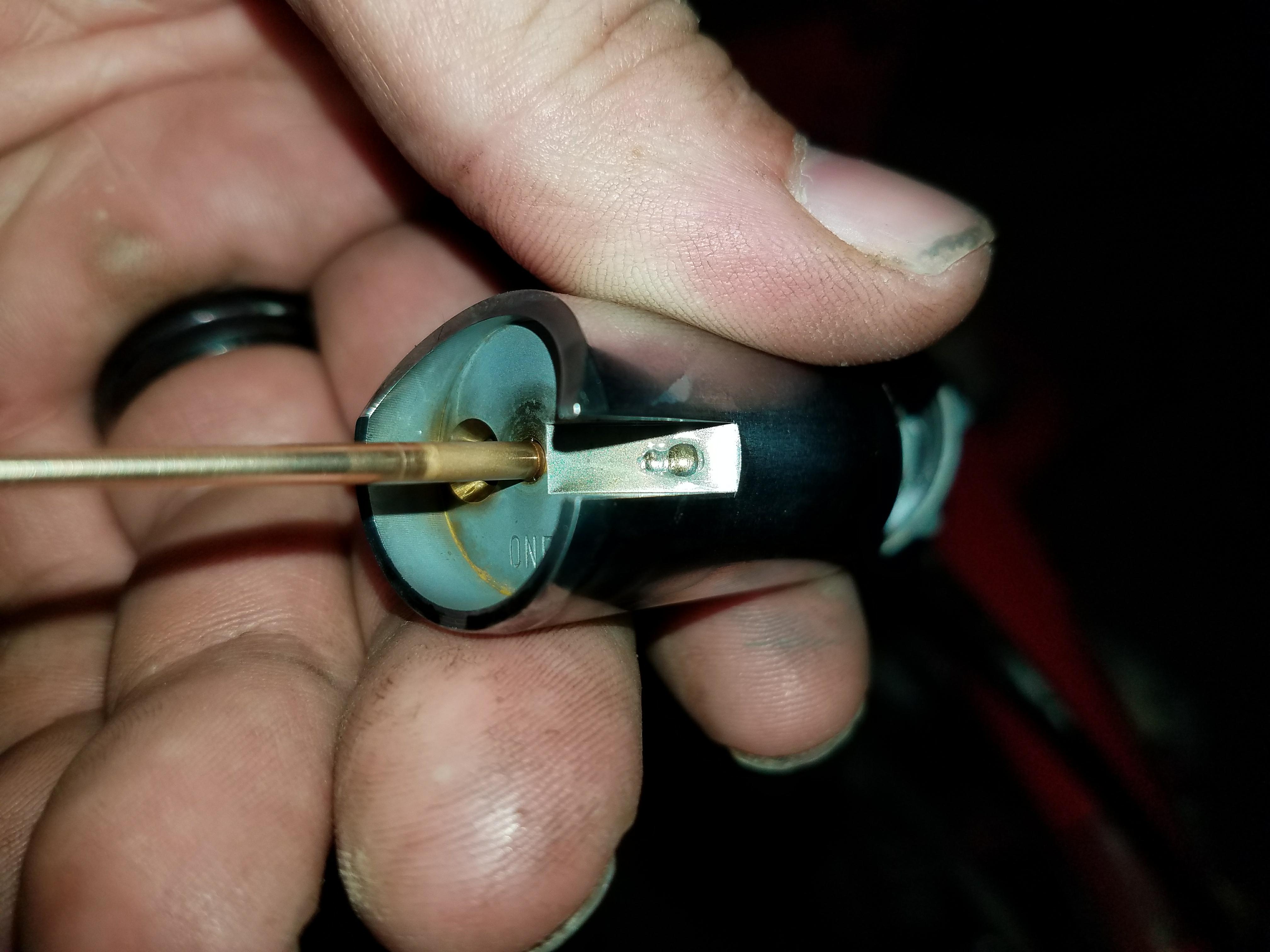

    So I wasn't able to get my 200x to idle at all yesterday, Pulled apart the Carburetor and cleaned it, still couldn't get it to idle.... Thought to myself what is going on here? while it idles it either does it to high or not at all, then I started thinking wait it does it too high, Let me check the slide....And this is what I found. (Already ordered another carb, still riding it just can't idle have to feather the throttle to keep it running)

    Call me crazy, but I don't get what you are showing in your picture. What is wrong with the slide? You're not worried about the dent from the idle screw are you?
    New carbs from e-bay can be a bit of a crap-shoot.
    Have you removed all the jets and made sure that all the passages are open? (blow air in one spot and make sure it comes out in another)
