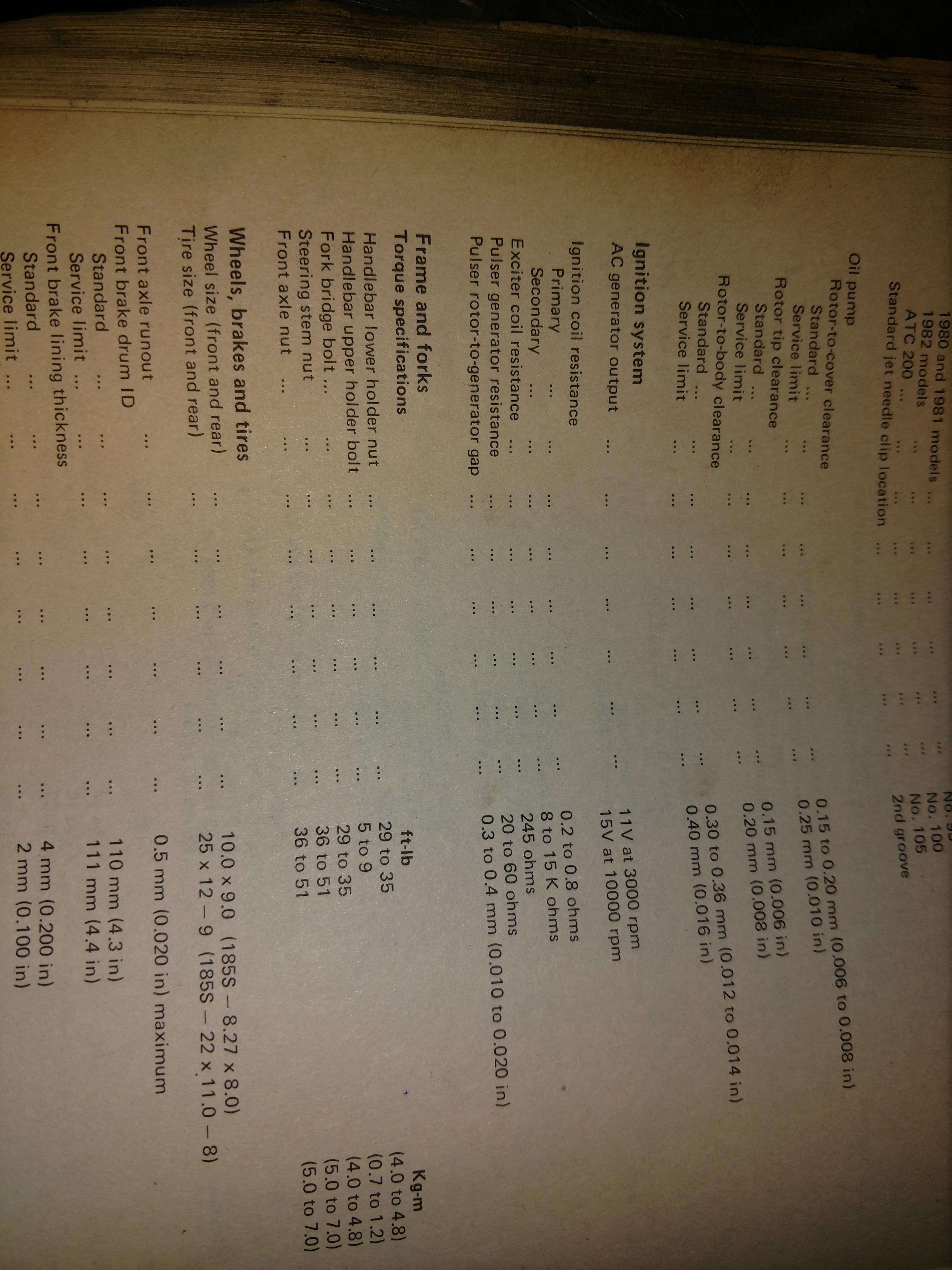

    These are off of a 185/200 not sure if it works for the es..
    Maybe someone else will chime in and offer some input..

    Anyway, there's a lot that can cause no spark. First thing I'd do if I was there would be to put all the original parts back on and test them per the service manual specs and only replace parts out of spec if there are any. Since we are working with the ignition system, the major parts are coil, cdi, pulse generator, stator (alternator) and the main harness. Here's some screen shots from the 200es service manual.
    Interesting that the service manual first points at the wiring being bad and more or less suggests for you to test the wiring and inspect the connectors.
    As for how to use a multi meter, it's pretty much follow the instructions and photos. Basically, when you test for resistance (measured in ohms) no power is needed in the circuit, when you are testing voltage you need power, since no power = 0v.
    If all the electronics are within spec, then the only thing I can think of is the pulse generator gap, cdi, or wiring all of which are a bit more advanced for the average consumer to test (the CDI is basically swap with a known good unit). We can go down that path later if needed.
